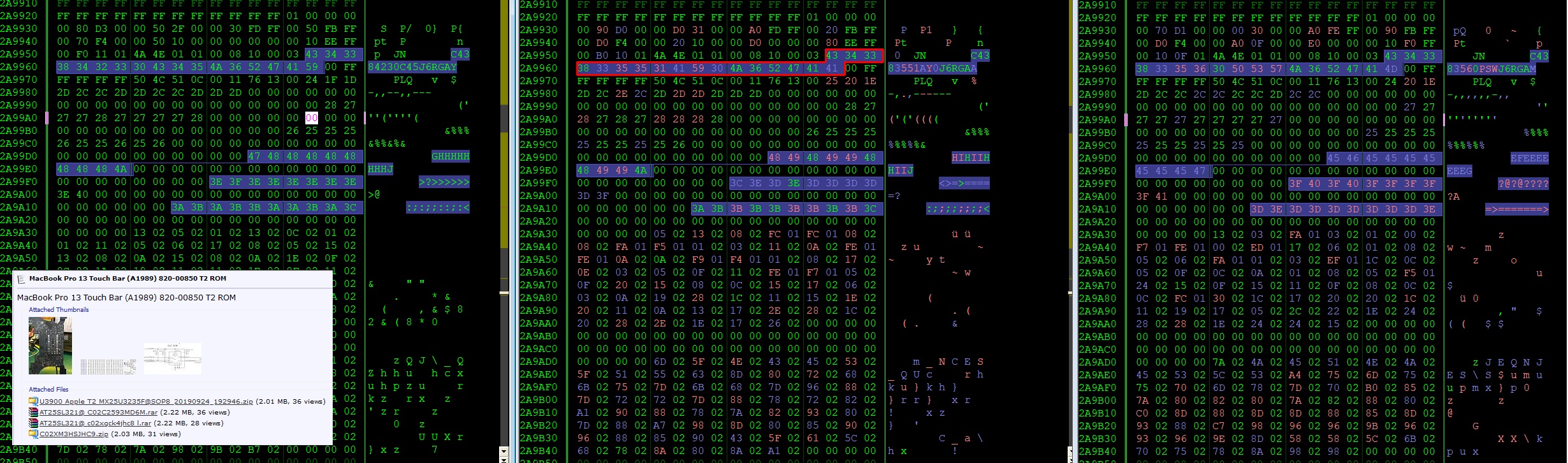

          MacBook Pro 13 Touch Bar (A1989) 820-00850 T2 ROM
          Last edited by zhangxunchuan; 05-31-2021, 03:30 AM. Reason: MacBook Pro 13 Touch Bar (A1989) 820-00850 T2 ROM PCB Offset

            Re: MacBook Pro 13 Touch Bar (A1989) 820-00850 T2 ROM

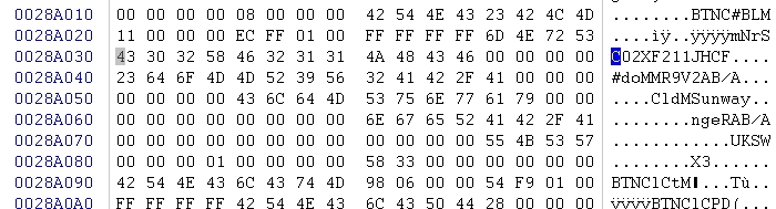

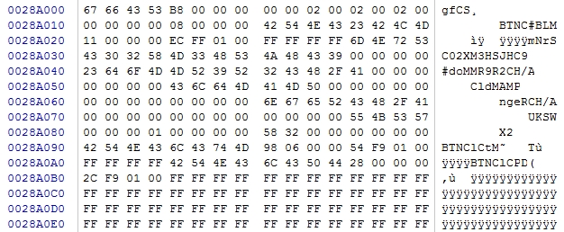

                            Re: Macbook 2018 above firmware password
                            Originally posted by 5chematic
                            Yes, it have to be the same model and everything. then change the serial number.
                            just curious, I don't know much about that.
                            just need put another serial or other information is necessary ?
                            what's serial number in picture ?
                            a card id ?
                            edit: I was see youtube and some say "Activation needs a valid serial in the T2 ROM and matching uuid, board id etc. This can brick your device."
                            it's true ?

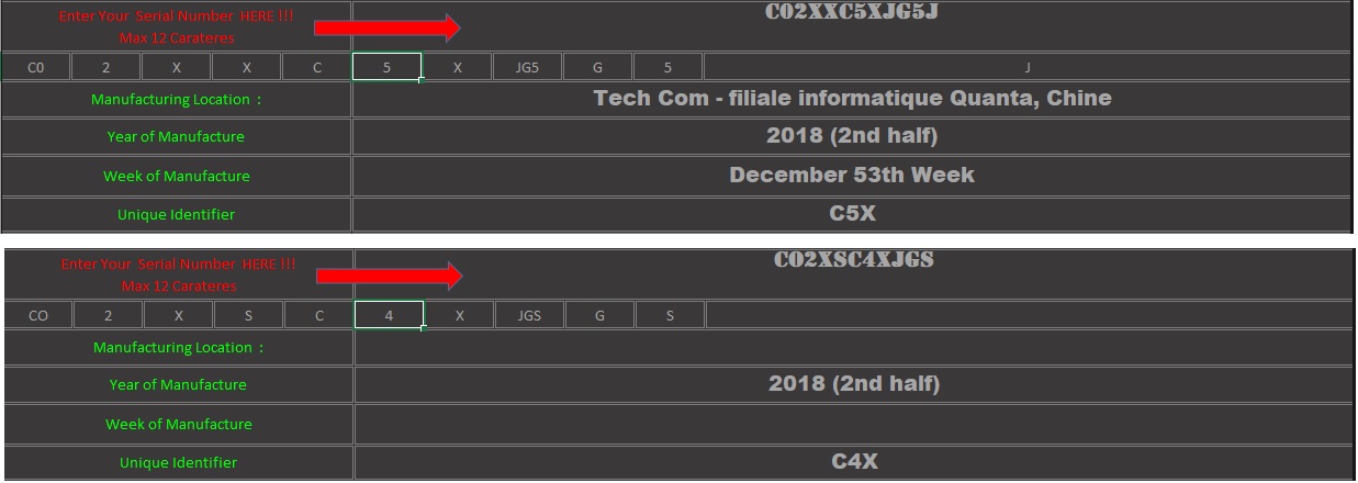

                              #34
                              a card id ?
                              it's true ?
                              You just put a random number. but do not change the whole serial number. for example, this is just an example of one I previously changed:
                              Old S/N: SC02XXC5XJG5J
                              New S/N: SCO2XSC4XJGS
                              I change the 5 for an S, or 0 for O, etc. maximun I change only 3. that should take care it. then apple server add that serial # to their global base.

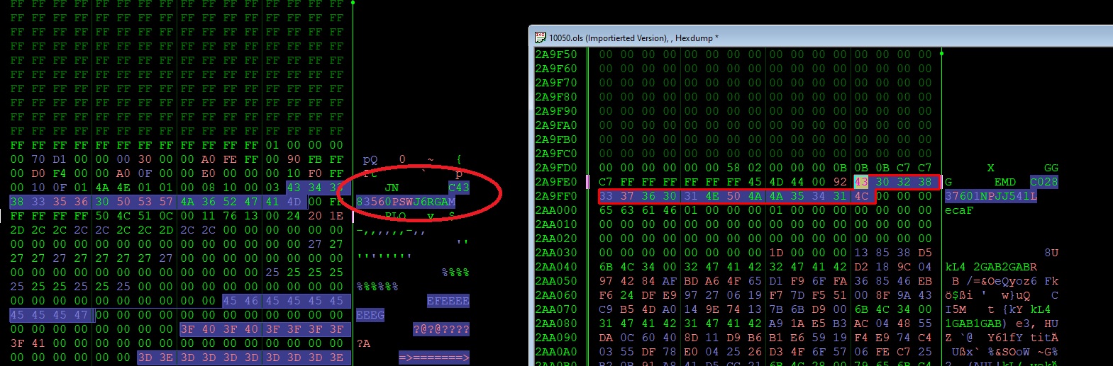

                                #35
                                you didn't understand, the weird number is located higher than serial number.
                                look at 2A995D any dump.
                                For serial Apple yes I know how it works.
                                Besides, I directly notice that your "New" is false.
                                Manufacturing Location and week of manufacture are bad .
                                And especially some characters are prohibited !! AEIOUBSZ
                                see picture

                                  #36
                                  see picture
                                  Try not to be negative. what I told you is what I did. and the 9 macs I already unlocked are perfect with no issues. And as for the serial I post, that was not a real serial, it was an example. but if you want to follow my advice fine, otherwise is okay.

                                    #37
                                    I know that changing 0 in C02 to O causes it to not activate (activation server cannot be reached). Same with changing 2 in C02 to 3. And probably by doing any other SN modification.
                                    So either you did not tell some key detail or it's BS

                                      #38
                                      C0 corresponds to manufacture location, several other codes exist
                                      some are only used for iphones and ipad
                                      "C0";"Tech Com - filiale informatique Quanta, Chine";"")

                                        Yes, that I know. The reason I have tried to change C02 on T2 machines is because this method works on older machines. Changing from C02 to C03 removes MDM. But with T2 cloud lock, it doesn't let activate it. That was kind of expected but was worth a shot.
                                        And that's why I know that 5chematic either left some details out or it's just BS.
                                        The thing bothering me is that even when you take the ROM from a faulty but unlocked device, it still doesn't let it activate. So the ROM content is still somehow binded with hardware in some way.
