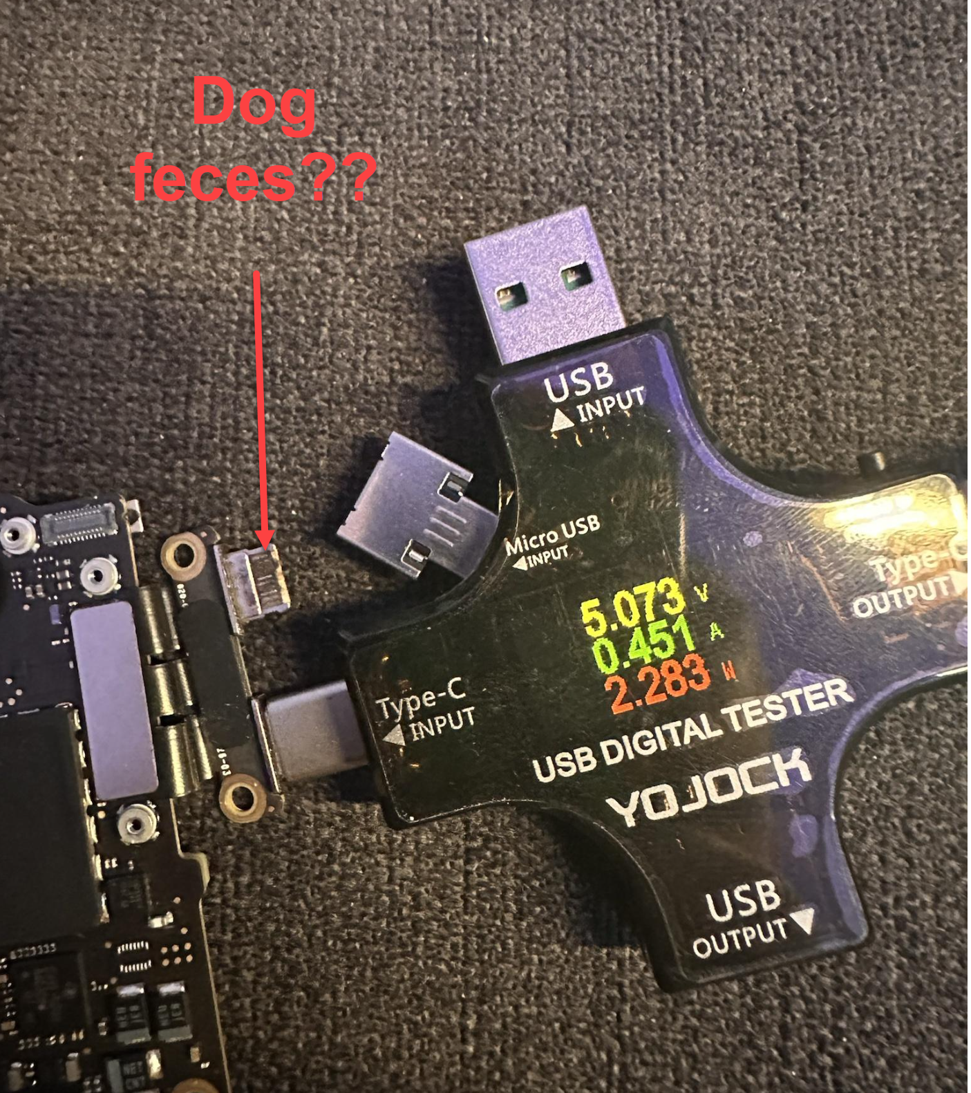

                                  Is this the same pattern for each USB Type C port? Do check by flipping the adapter cable head by 180 degrees as well. Before doing this, unplug the power adapter -> perform the switch to the other side of the type C blade connector and then power up with the external adapter. Personally do not trust the removal and insertion of this interface while the power is 'hot' from the power adapter.
                                  Perhaps one of the type C ports is stable and does not power cycle / loop? As requested, test topside and bottom side of the power head.
                                  • robka
                                    • 12
                                    https://imgur.com/a/UcIicwK
                                    please see attached photos and descriptions for values.
                                    • mon2
                                      • Dec 2019
                                      • 14691
                                      Concerned about the USB Type C meter. There are silk screened markings for 'INPUT' and 'OUTPUT'. Is this meter not bidirectional? This may be a factor in the review. That is, the power adapter side should be the INPUT and respectively, the logic board should be the OUTPUT.
                                      The contacts look dirty -> use IPA (alcohol) and a Q-tip / cotton swab and clean each side of each USB Type C connector.
                                      • robka
                                        • 12
                                        just verified the function with my M2 MacBook Pro. It shows 2.2amps @ 20v.
                                        Click image for larger version  Name:	contacts.png Views:	0 Size:	3.39 MB ID:	3231211
                                        it's burned
