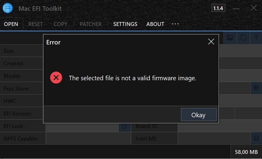

    I have a MacBook Air 13 inches 2014.
    I have set a EFI password and I can't remember it : now I want to reinstall macOS and I can't because the MacBook is asking for the password.
    I know how to remove the password with a usb programmer.
    I plug the usb programmer to the motherboard and to my pc with usb, I read the EFI and I save it to a file.
    Then I have to find this value in the file : $SVS because it indicate where is the password.
    But I can't find the value.
    I have attached the file​
    Thank you if you can help me

        Thank you for the link.
        The software does not recognize my file
        Click image for larger versionName:	mefit-114-message.jpgViews:	0Size:	58.4 KBID:	3271182

          That BIOS file doesn't look right. Can you try reading again and compare the two to make sure?

            I read again and can open the file with MacEfiToolkit but still can't find $SVS in it

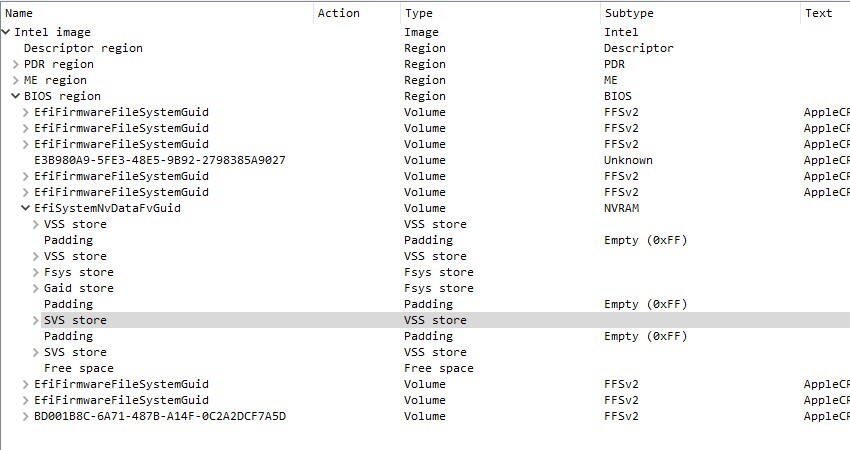

                    This is a bad dump, most of the info is missing. ​Should look like this in UEFI tool (this is from an old dump off an 820-3437 board).
                    Not sure about your programmer and using the header. I never use it as it's not exactly reliable and often corroded. Easier to just hot air U6100 off and read it directly on your programmer.

                      • 22276
                      Its an EZP**** programmer,piece of crap. He might be able to read it by slowing the speed down,it has an option to do that
