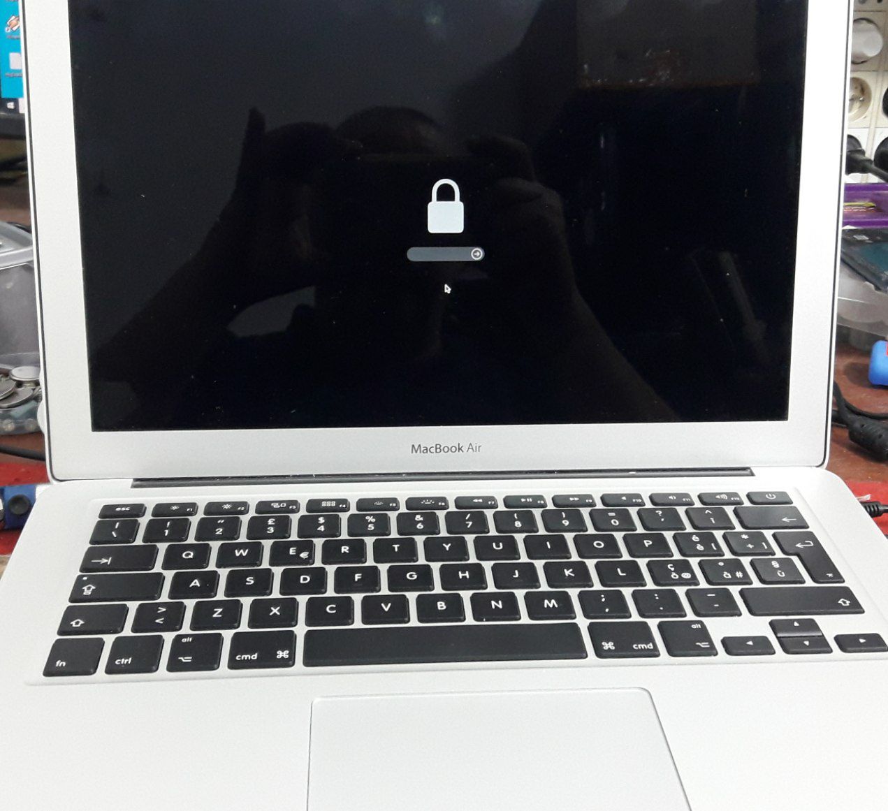

          #124
          Re: EFIBIN File MacBook Air A1466 (EMC 2632) 820-3437-B
          macbook air a1466 emc2632 year 2013 motherboard 820-3437-B
          i modified my readed file (using rt809h universal programmer)bios and with winhex '$SVS' to FF value.but the set sill locked and ask efi pin lock 4 digi. i used the file send by members alfredposadas09 and same i upload the original file with lock efi in attachment

            #125
            Originally posted by bibi019
            ...and ask efi pin lock 4 digi.
            Do you mean iCloud pin lock? If it's iCloud pin lock, just reset PRAM.

              #126
              3 X PRAM resets https://www.badcaps.net/forum/showpo...42&postcount=4

                #127
                done after reset pram and reinstall os thank you all members

                      #130
                      thank you Mr Vesko356 done after reset pram
                      i can use the some methods with mackbook pro a1502 emc 2835 (Retina, 13-inch, Early 2015).greatful
