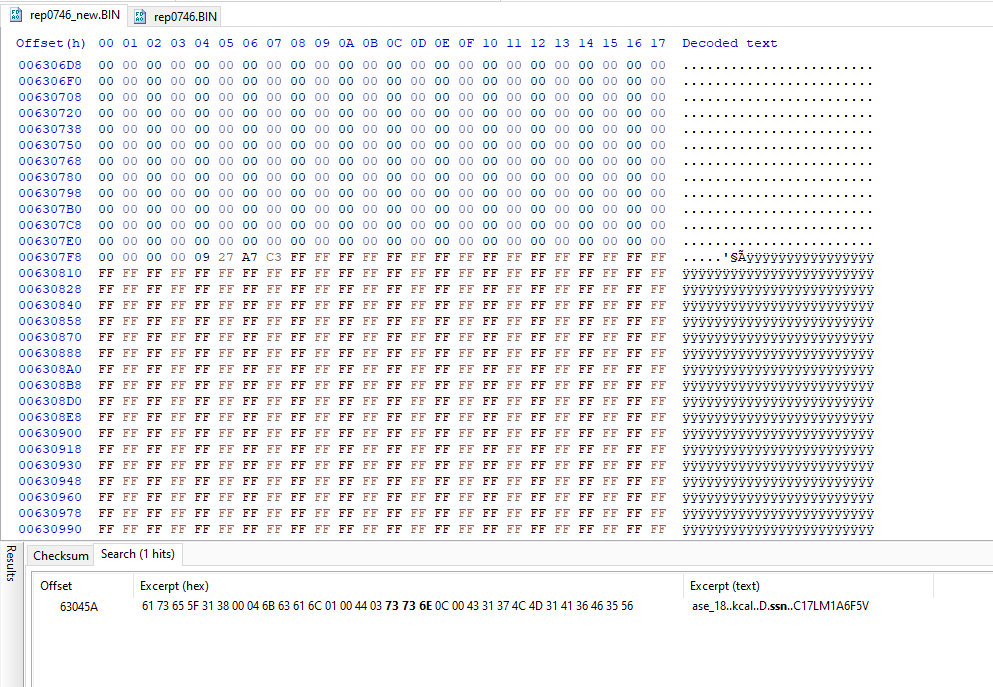

                      • GfilipeZ
                        • May 2021
                        • 43
                        • Portugal
                        #51
                        Re: EFIBIN File MacBook Air A1466 (EMC 2632) 820-3437-B
                        Originally posted by piernov
                        Serial number has to be edited and Fsys checksum corrected accordingly.
                        Sorry i know this is an old topic...
                        I'm trying to edit this efi firmware, but I'm facing some problems. I was able to edit SN and the last 4 digits, but I can't find Fsys checksum part, to correct.
                        The logic board version, is the same of this topic.
                        The problem: if i let the macbook rest for about 10/15*min, when I try to boot, the fan spins only 1/4 and stops. I press again the power and the fan spins normally, but there is no boot, neither image. So I have to shut down, and when i press the power button again, it boots normally.
                        Best regards!
                          • 22424
                          #52
                          Best regards!
                          09 27 A7 C3 ,open the bios with UEFITool it will tell you what the checksum should be
                          https://www.badcaps.net/forum/showpo...43&postcount=5
                          4.3. Apple
                          For 2017 and older machines, serial number is stored in Fsys store of BIOS and can be edited with hexadecimal editor. Fsys checksum needs to be fixed afterwards
                          Search for "ssn", edit the serial number, save, open dump in UEFITool, go to the Fsys store and write down the suggested checksum in the panel on the right. Checksum is 4 bytes at the end of the Fsys store, between one zone of 0x00 either Gaid or another zone of 0xFF, it must be written in reverse order (so last 2 characters from UEFITool must be written first).
                          See: https://www.youtube.com/watch?v=poA8HByYqTM
                          • GfilipeZ
                            • May 2021
                            • 43
                            • Portugal
                            #53
                            4.3. Apple
                            Thank's for the quick reply.
                            Yes, i'm following exactly that video. With UEFITool, i was able to find the checksum. What a can't find, is the part on bin file "Gaid". Like the tutorial video, on min 5:55. It appears like i send in the last picture.
                              • 22424
                              #54
                              Listen carefully to the video from 6 minutes,piernov explains that newer bios versions have no gaid string. Watch the next part at 7:20
                              • GfilipeZ
                                • May 2021
                                • 43
                                • Portugal
                                #55
                                I'm so sorry SMDFlea...
                                Many thanks!!!
                                  • 22424
                                  #56
                                  Many thanks!!!
                                  I`m happy youve got it now
