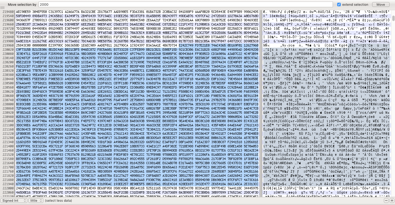

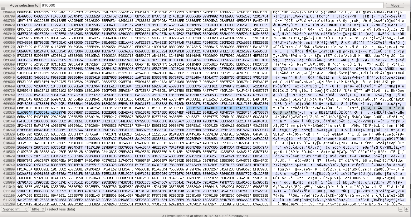

                                      this is a very circuitous lesson you're trying to teach. i wasn't asking for somebody to do the work for me, and for somebody as kind as SMDflea to teach me how to do this unforeseen task myself, posting my original dump still remains unnecessary.
                                      all in fact i needed was a working dump, which i received (many thanks!)
                                      here are photos of the key and DMI info from my corrupt dump. i'm going to just overwrite these chunks into the working dump...
                                      just posting them here in case i missed something or made an obvious mistake.
                                      cheers

                                        in the future should i encounter this again, are these standard offsets for these data in PC bios? or is there something i should be searching for...
                                        i work primarily on apple EFI, which is structured nearly identically across all systems depending on model year.
                                        thanks again
