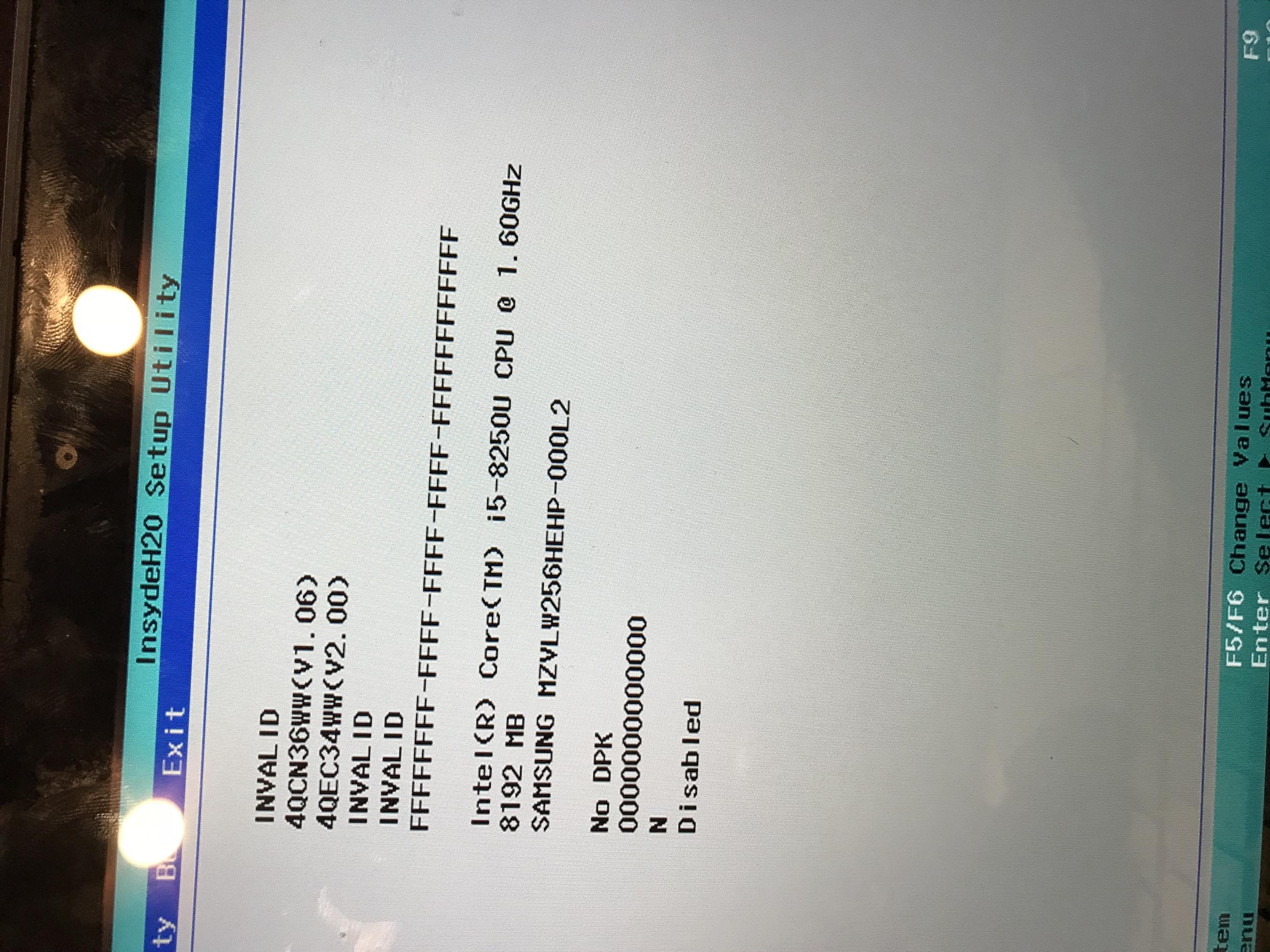

      curiously, i noticed this while fussing with the laptop... not only is the windows info gone, but the hw UUID, serial number, etc...
      in apple EFI it's very easy to find hwsn, uuid, MLB.no, etc when replacing logic board, but these PC bios are greek to me!

        SORTED. all is well with my lenovo Flex 5.

            existing bios was corrupted. replacement bios worked fine, but had to copy windows licensing info over. unfortunately I haven't spent much time working with PC laptop bios, not since modding SLIC tables for win7 activation heh
