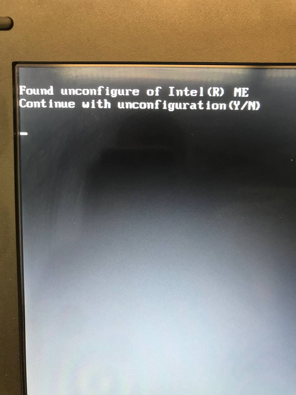

                  #128
                  Re: Panasonic touchbook cf-53 mk2/mk4
                  i was able to unlock another MK2.... thank you very much for all your help
                  this time on boot is other LOGO not Panasonic Logo and one error see Picture
                  any idea how to change the Logo?
                  Thank you very much

                    #129
                    at the end of the string there is 01. Do not change it to 00. Otherwise Panasonic logo at boot will go away.
                    you haven't read all thread

                              #134
                              Thank you very much
                              here . EDIT: bios removed.
