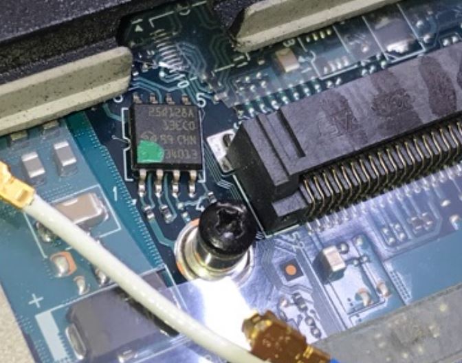

    Hi to all.
    I have two touchbook cf-53, one mk2 the second mk4.
    The bios has a password.
    Help, prompt you successively the process of removing the password.

    Re: Panasonic touchbook cf-53 mk2/mk4
    Hi.
    Post your dump bios .
        Read full bios via programmer .
            You find spi eeprom in motherboard ?

              dump Bios eeprom25Q128A- Panasonic touchbook cf-53 mk2
              I ask for help in finding a BIOS dump 16mb-
              with
              a known password or without a password.
              Thanks adavance (My chip has broken)
                      Hi to all,
                      Can someone help me remove the password from my cf-53 mk4 bios? It seems I've tried everything and nothing helps. Thanks in advance!
                        Originally posted by nolina
                        Hi to all,
                        Try this...
                        • nolina
                          • Jan 2019
                          • 2
                          • Lithuania
                          Originally posted by rioreno
                          Try this...
                          It works. Thank you very much!
                              Hi to all,
                              Can someone help me remove the password from my cf-53 mk2 bios? It seems I've tried everything and nothing helps. Thanks in advance!
                              • peste
                                • Dec 2016
                                • 13333
                                • ROMANIA
                                bios is not ok, half is empty...
                                  Hi, and how do I read it. What program to use?
                                  Thanks for understanding.
                                  • peste
                                    • Dec 2016
                                    • 13333
                                    • ROMANIA
                                    you have to remove the bios chip from the motherboard, put it in a programmer (tl866, ch 341, etc), read the bios chip, make a backup, check the copy in the hex program to see if it is right, put the copy here, and someone when they have time will help you ...
