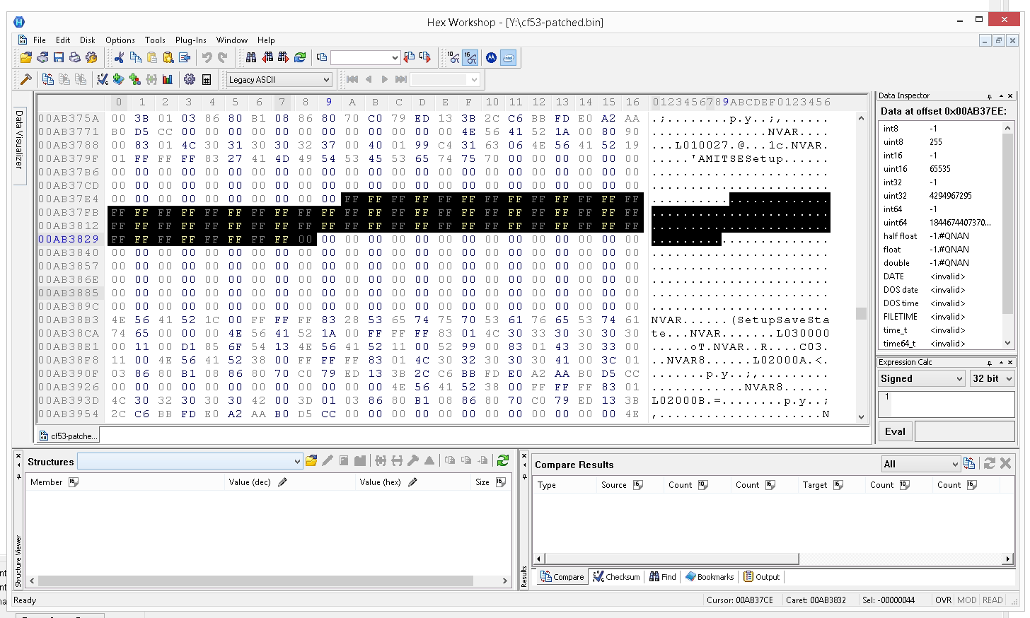

    Originally posted by flecom
    I cleared the section with FF and replaced the 01 with 00 as pictured but I still get asked for a password on power-up (user password?) is that in a different location?
    Upload both dumps here if you want help, it won't get any better with storytelling.
    Become a Badcaps supporter
    Thanks to all supporters.​
    • flecom
      • Sep 2015
      • 3
      • Murica
      #202
      Re: Panasonic Toughbook CF-53 Mk3 BIOS Password Removal
      I would much rather learn to fish than have someone hand me a fish... if that's not ok here that's fine just let me know
      I replaced the section that was mentioned here:
      with FF and 00 as the person I was quoting described
      but I think that may just blank out the BIOS password and not the power-on password (password prompt you get when powering on before you even get an option to go into the BIOS), hence why I was asking if anyone knew where to locate the user/power-on password in the dump
      but I attached it anyway if you don't want to share your secrets

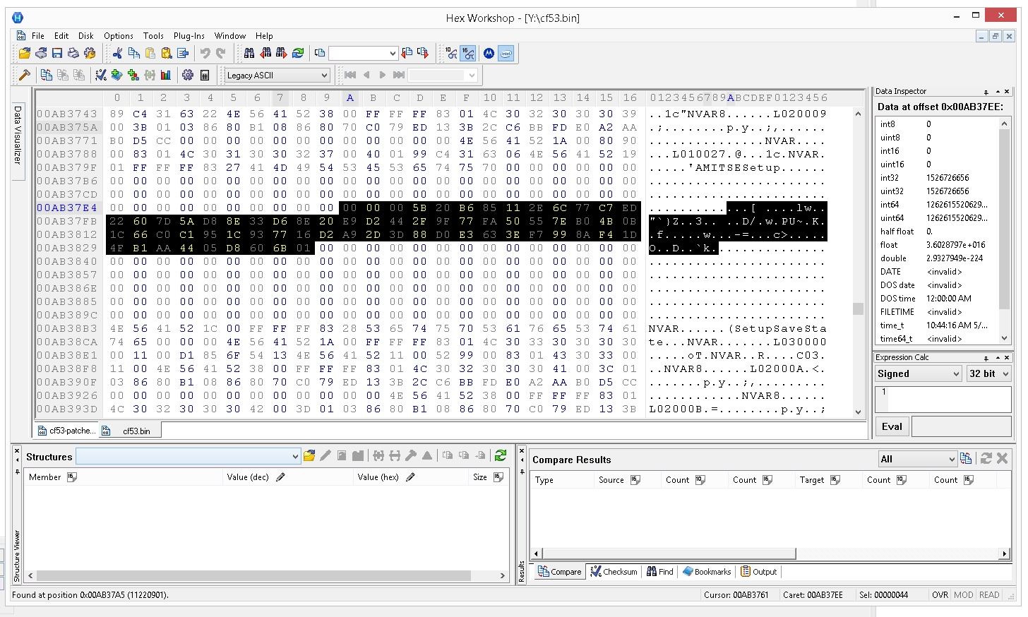

        Ok, go fishing then if that's what you want.
        I said BOTH dumps, to be able to look what you've done, and not storytelling and pictures again.
        So I can be able to tell you where you're going wrong after you've failed already. That's what you want, isn't it?
        • flecom
          • Sep 2015
          • 3
          • Murica
          #204
          I posted the original dump and exactly what I did to it as posted by the other member, here's the output of that
          • Vesko356
            VIP Moderator
            • Aug 2018
            • 4386
            • Bulgaria πŸ‡§πŸ‡¬
            #205
            Re: Panasonic touchbook cf-53 mk2/mk4
            It turned out that the model is CF53-4, that's why I'm moving the comments to the "cf-53 mk2/mk4" thread.
            Below is your unlocked dump, you can compare mine and yours in hex editor to see where you went wrong:

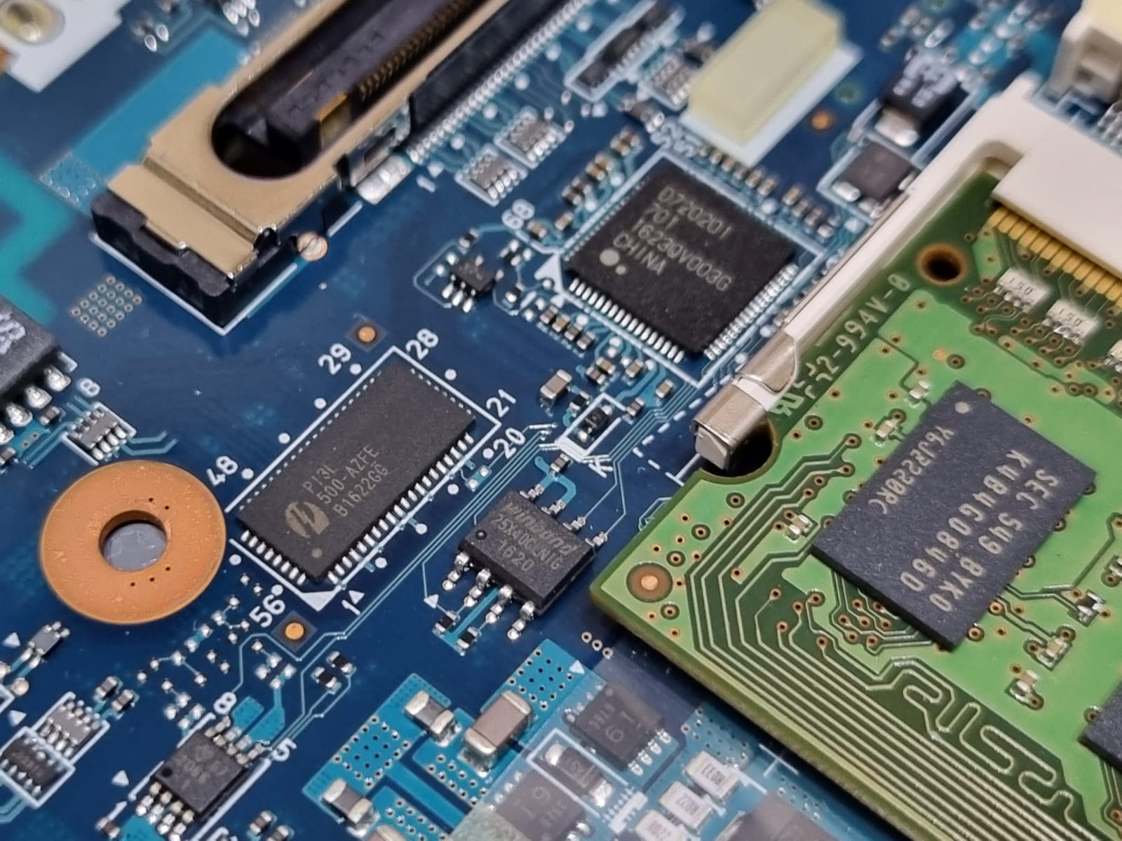

                              Originally posted by iska84
                              Good day friend! Can u help me ? At last I backup dump. Please verify this bios now. I need in it please.
                              You dumped the wrong chip. W25X40CL is not the right one. Bios chip must be 16Mb, for example MX25L128 or W25Q128 and so on.
                              • iska84
                                • May 2023
                                • 5
                                • Azerbaijan
                                #215
                                There is no other chip on this board labeled Winbound. Or I can't find that chip. Motherboard in front of me. This chip was next to the RAM.
                                • Vesko356
                                  VIP Moderator
                                  • Aug 2018
                                  • 4386
                                  • Bulgaria πŸ‡§πŸ‡¬
                                  #216
                                  It doesn't have to be exact Winbond, it could be Macronix or some other brand as I mentioned. Inspect the motherboard more carefully.
                                  • iska84
                                    • May 2023
                                    • 5
                                    • Azerbaijan
                                    #217
                                    Good day! Finally i can find BIOS chip and dump it. Can u check this BIOS and repair if its broken ?
