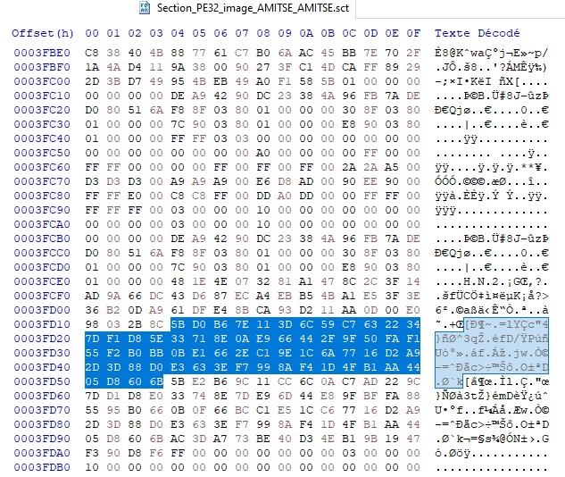

      Re: Panasonic CF53 MK4 CF-532S74RMG
      Originally posted by LenBios
      thank you unlock ok but asking for password after defaults setting the bios
      weird that

        #103
        weird that
        try test
        i can test it tomorrow and give feedback

          #104
          weird that
          try test
          with this file no display

              #106
              Try this one .

                #107
                Originally posted by SMDFlea
                Try this one .
                asking directly for password

                  #108
                  try
                  @smdflea rest amitsetup in your file

                    #109
                    Sorry,forgot to remove some sections.

                      #110
                      unlock ok, but after bios defaults setting password returns

                          #112
                          After unlock dont do default before default user password put own any password and restart.Then try again

                            #113
                            @SMdFlea try this maybe ? write 2 times again

                                  #116
                                  already tried but no success (after defaults bios setting asking for original password)

                                      #118
                                      Re: Panasonic touchbook cf-53 mk2/mk4
                                      If at first you don`t succeed,try try again.
                                      File Try3 is working
                                      which amitsetup did you delete? from which line to......
                                      thank you very much for all your help
