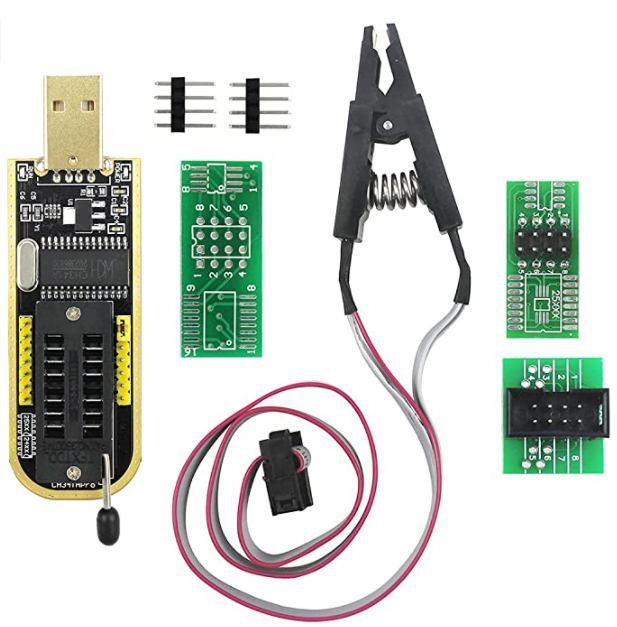

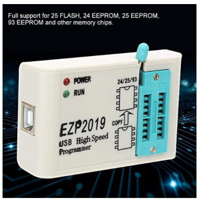

            now I have to backup the BIOS. Being able to access windows 10, with which program can I make the backup to post it here?
            or do I have to access the bios chip and extrapolate the backup with a programmer?

              Yes you have to extrapolate the backup with a programmer

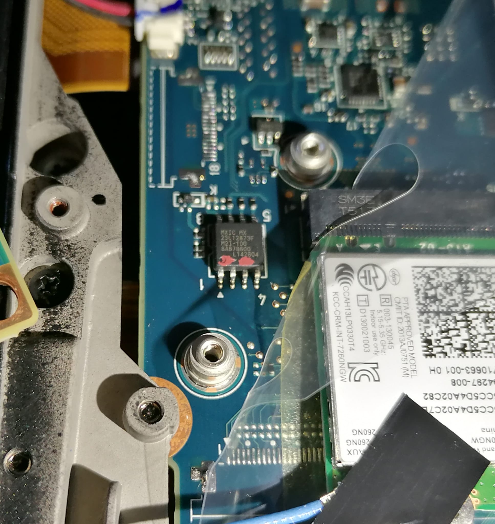

                Can you kindly confirm that the chip in question is the one in the picture and that it can be read by a tl866 or ch41 programmer?
                • Vesko356
                  Confirmed.
                  You are good to go for extrapolation.
