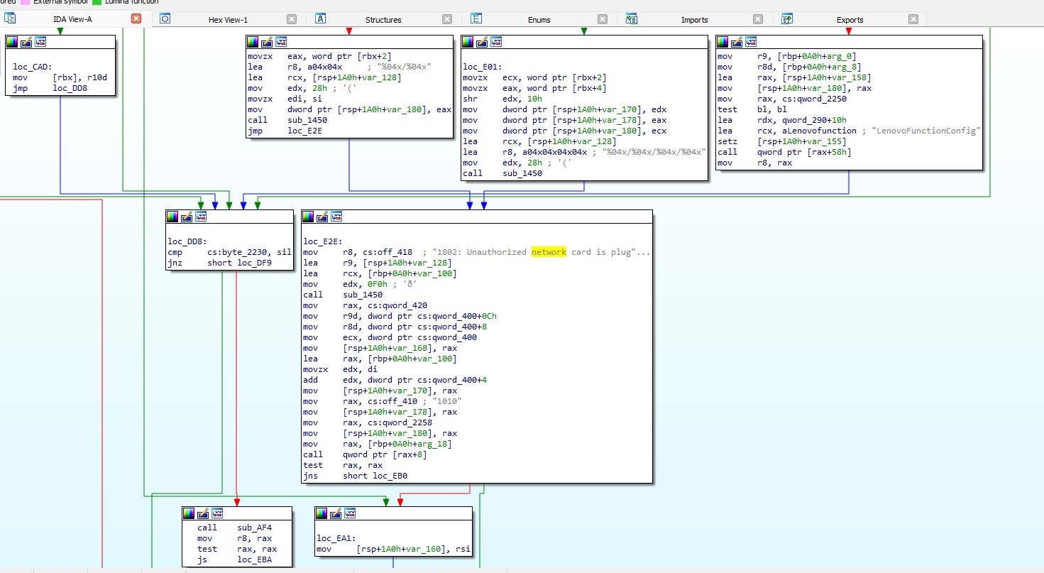

                  T560 bios needed!
                  Hi there, a corrupted BIOS image of my lenovo T560.
                  I am able to do a dump.
                  But how can I obtain a valid BIOS image for this machine?
                  I just wanted to change the wificard since then it doesn't boot no longer.
                  There is just the post screen then it goes to a boot loop.
                  I also have a dump from another board, so can I just replace the BIOS chip?
                  No passwords are set.
                  Thanks in advance!

                    #49
                    Re: T560 bios needed!
                    Thanks in advance!
                    Put the old wifi card back in and it will boot.The wifi cards are whitelisted in the bios,only lenovo FRU approved cards will work unless the bios is modified to remove the whitelist.
                    There isn`t much bios modding at this site,if you want it modding try somewhere else such as bios-mods.com .I don`t know if it even possible or not,newer models are hard to mod afaik.

                      #50
                      it should get error 1802 for the bad card
