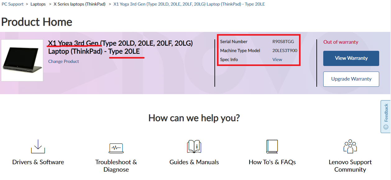

    Serial number ?

      Hi hoaca388,
      S No is R9-0S8TGG 18/11
      Just to know, why serial number is necessary?
      Thank you bud

        Originally posted by Loki_Fido
        Hi hoaca388,
        Thank you bud
        It helps determine which bios model to load.
              Hoaca, any update bud?
              X1 Yoga 3rd Gen Laptop (ThinkPad) - Type 20LE

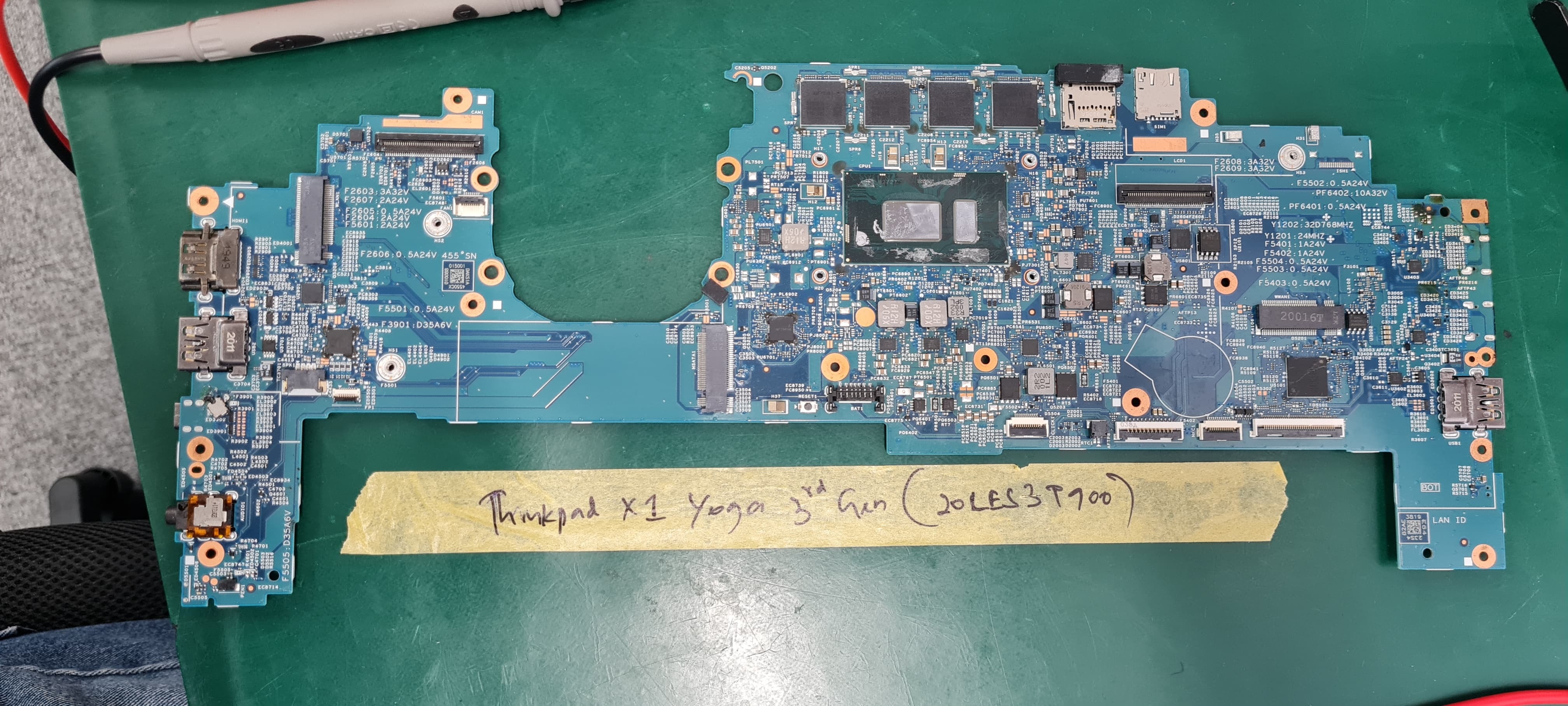

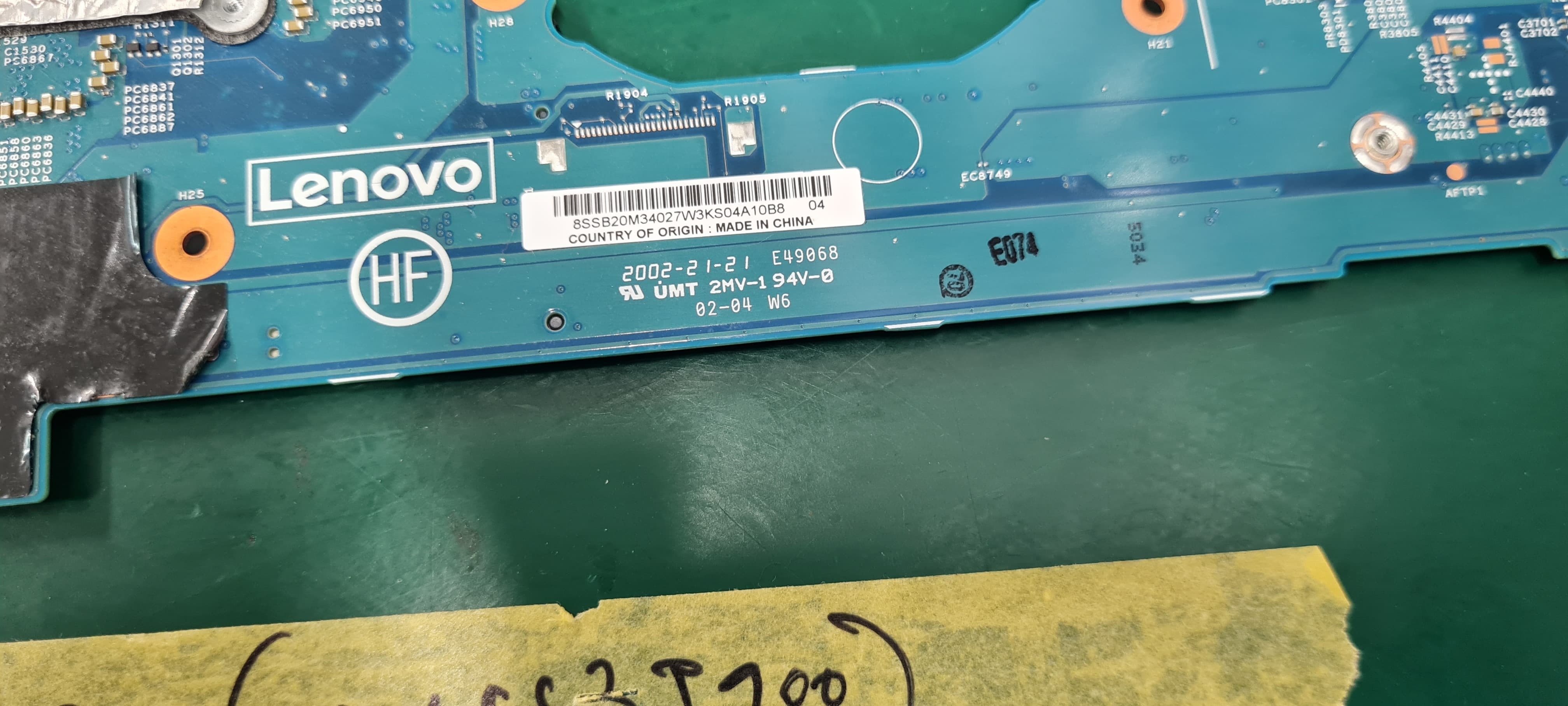

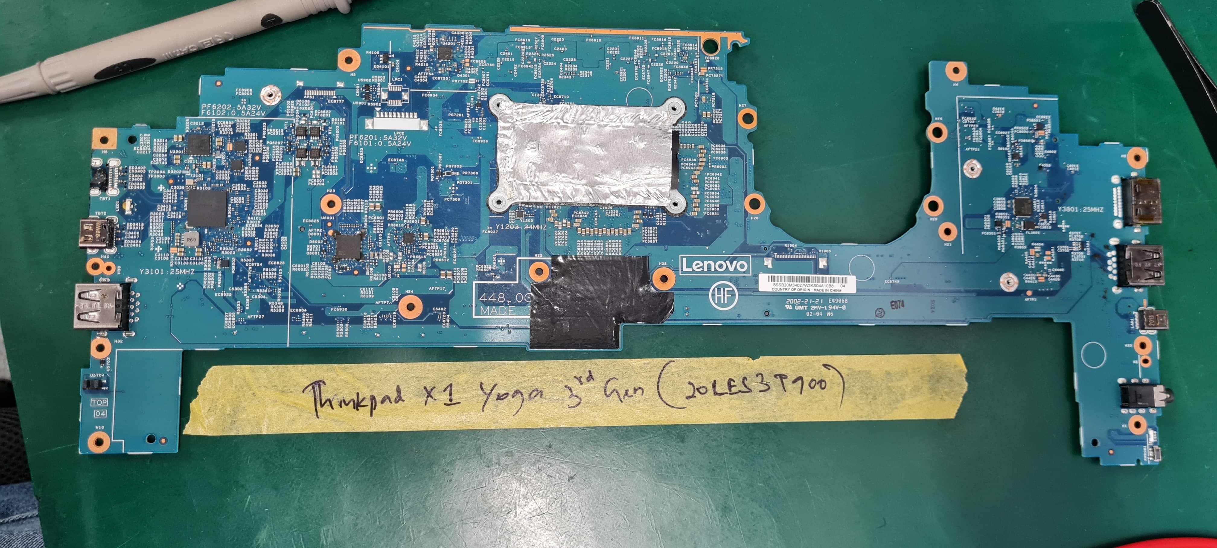

                      Hi rybskej,
                      Please find attached pic of the whole motherboard and the location of the BIOS chip and its markings.
                      Picture 1 and 2 are front and the back of the motherboard

                      Picture 3 is the location of the BIOS chip

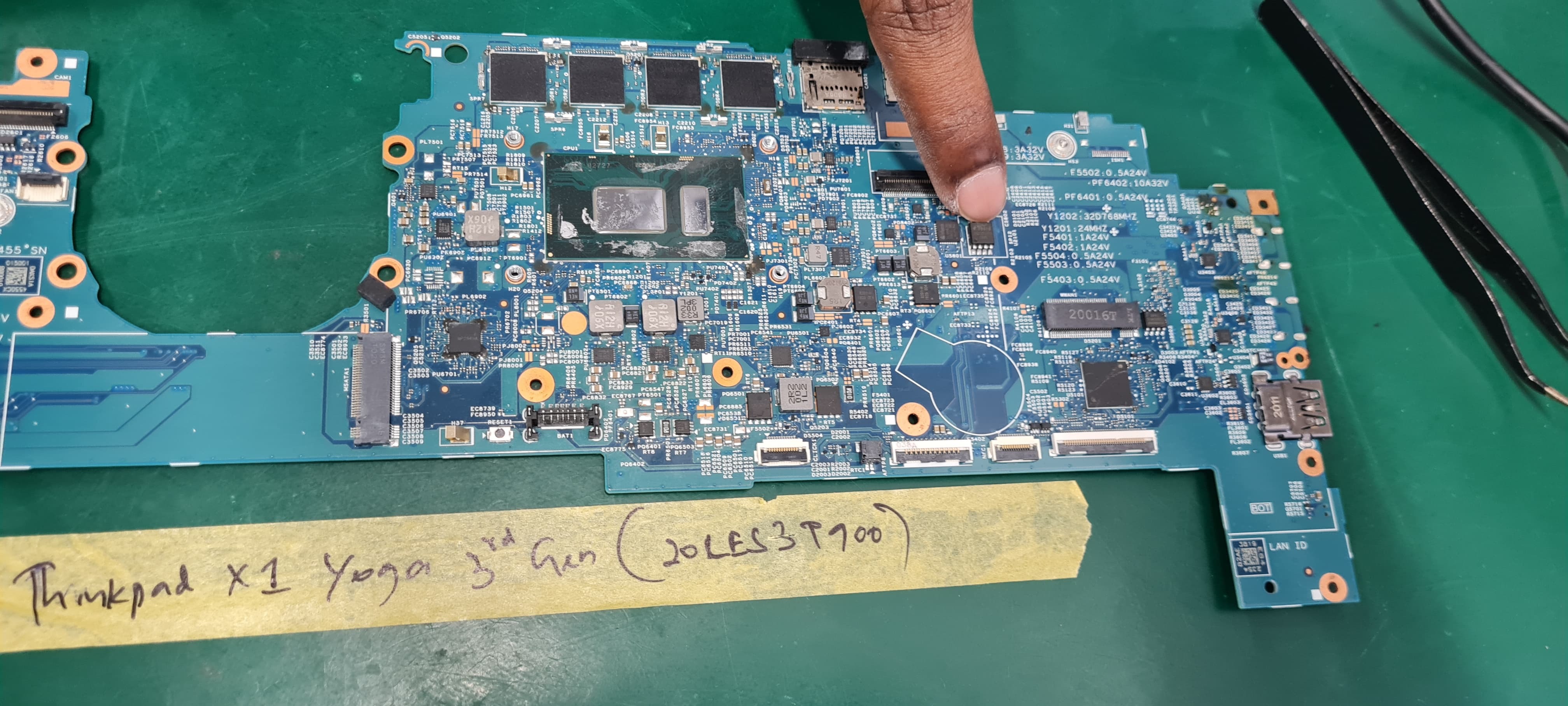

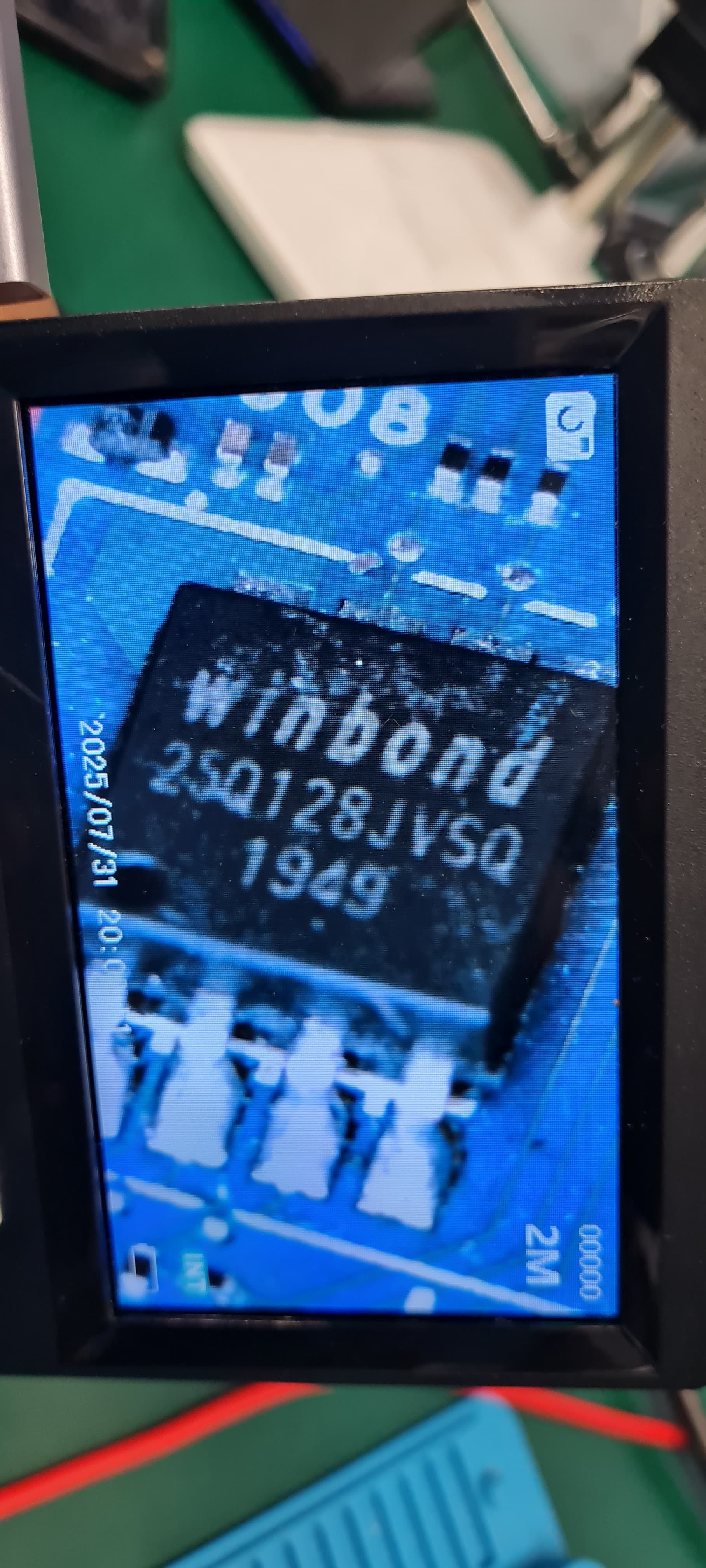

                      Picture 4 is the markings of the BIOS chip

                      Picture 5 is the markings of the motherboard.
