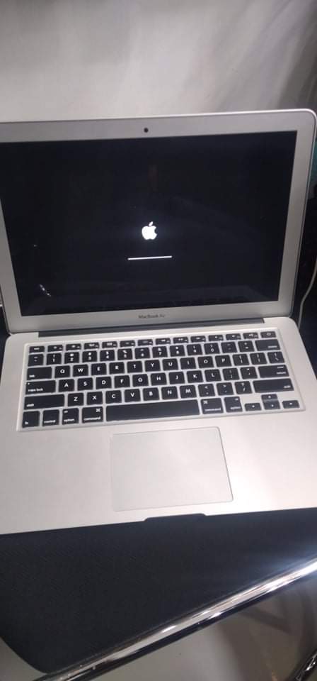

                Macbook Air A1466 EMC2925 EFI LOCK
                Good day to all. I am a newbie here. Can someone help me to remove the EFI password of this BIN file? My customer forgot the password of this. Thank you in advance. God Bless.

                          Re: Macbook Air A1466 EMC2925 EFI LOCK
                          Originally posted by Vesko356
                          Not working sir. It is still locked. Thank you sir. I appreciate this.

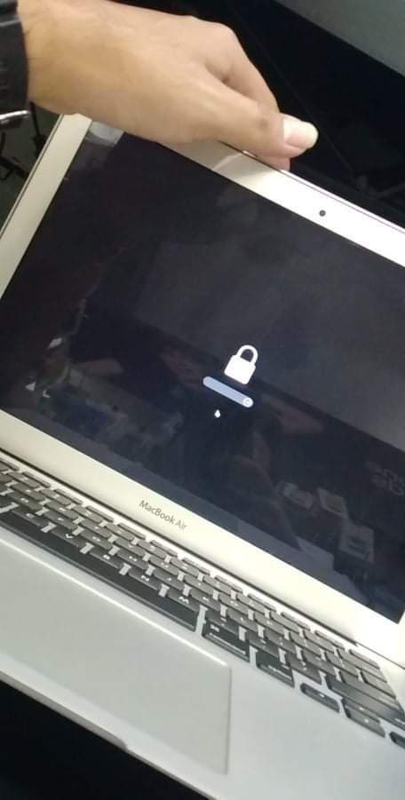

                                  Re: Macbook Air 1466 EMC2925 password
                                  Originally posted by DenzFlores
                                  Still the efi password is there...
                                  Post screenshot.
                                    Post screenshot.
                                    This is the picture after i flash. Still have lock
                                      Post screenshot.
                                      I have tried another BIN file, which is posted in other thread. After the flash there is no efi password. But the problem it is stuck up in the apple logo. after 2 hours nothing happen. This is the picture sir...
                                        Use this, do PRAM rest after flashing
