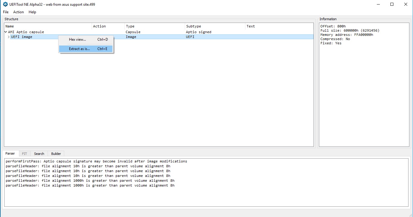

    here is quick tutoril working on most of asus boards with intel cpu
    tools:
    1. uefi tool
    2. original non working dump
    3. update file from asus site
    4. little comon sense

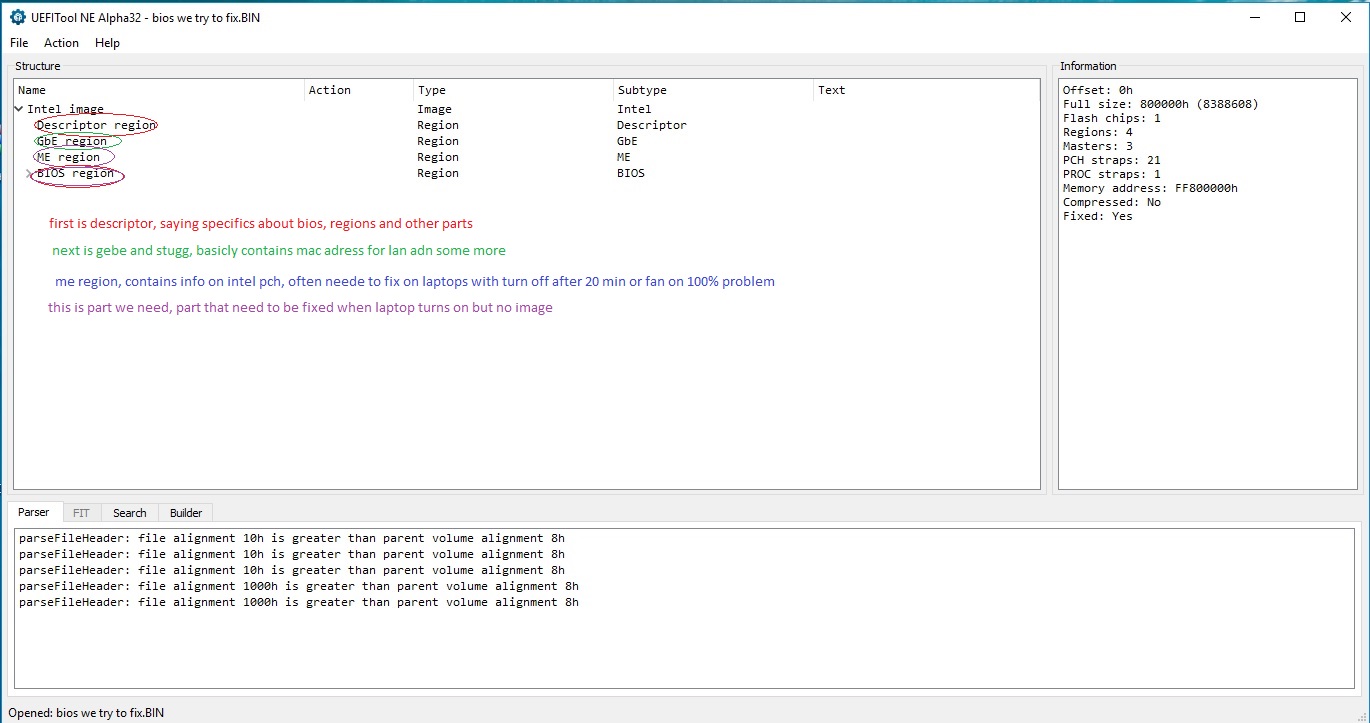

    first, uefi bios contains from few things but oll you need to know is this
    name files as i do not to get confused, later on when you do this few times you can do how ever you like

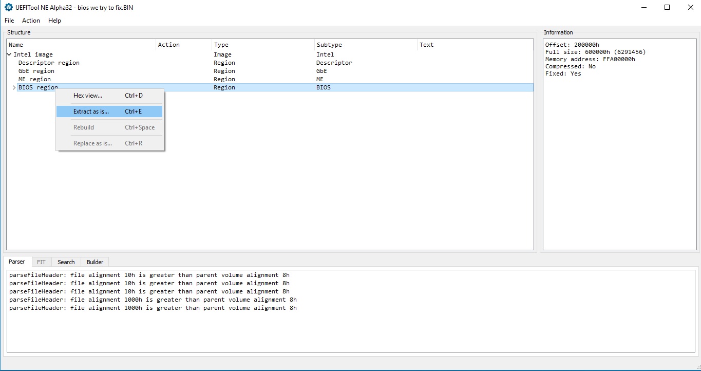

    1. first take look at bios:
    2. extract main part of bios and save as BIOS_region.rgn
    3. extract main from web update and save as UEFI_image.rom

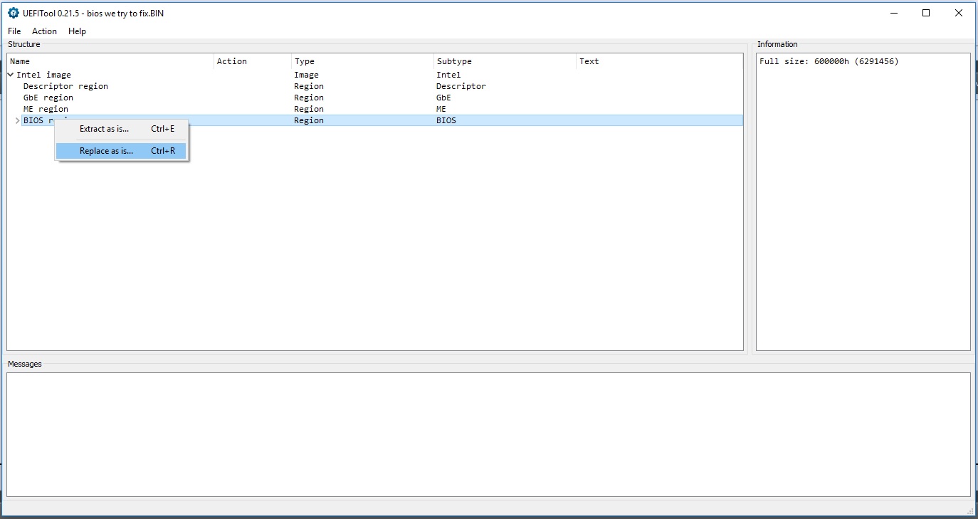

    4. replace in bios we try to fix.bin a part from web update we extracted before this UEFI_image.rom
    and save file
    note that in order for this to work main part called BIOS_region.rgn and extracted from web update called UEFI_image.rom needs to be SAME SIZE!!!! or it will not work
    this method sometimes looses bios key only cos update bios does not contain cers and keys for that
    i dont say its working for all boards, but it worked for me for many many times
