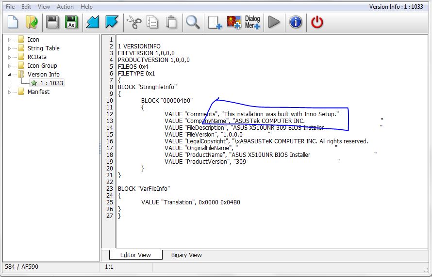

                Re: [TUTORIAL] fix asus bios with bios from asus web support
                Asus have started to include a Windows installer besides the normal updates. If there`s only a win update listed on the site the update can be extracted from the exe using innoextract . https://constexpr.org/innoextract/
