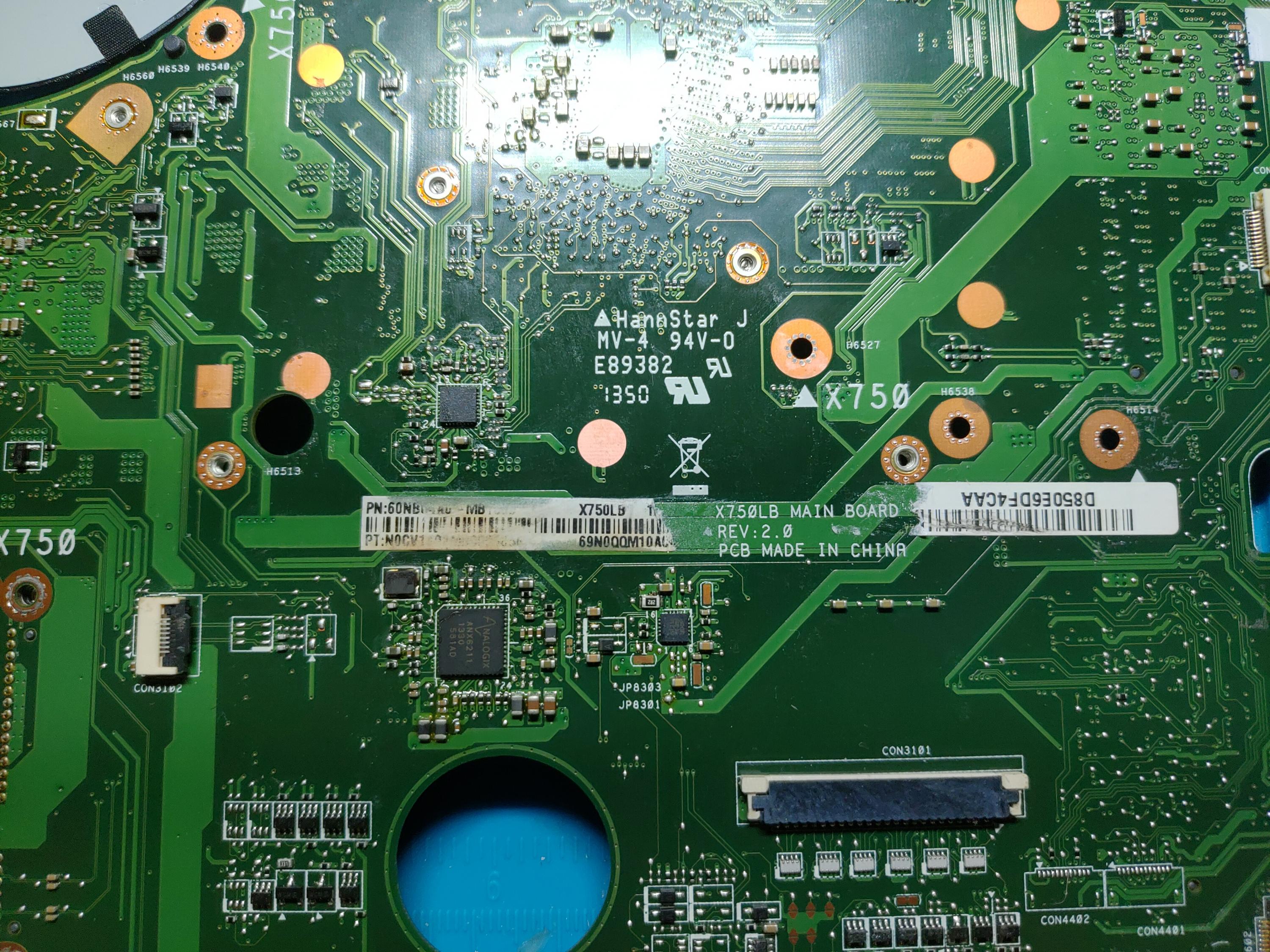

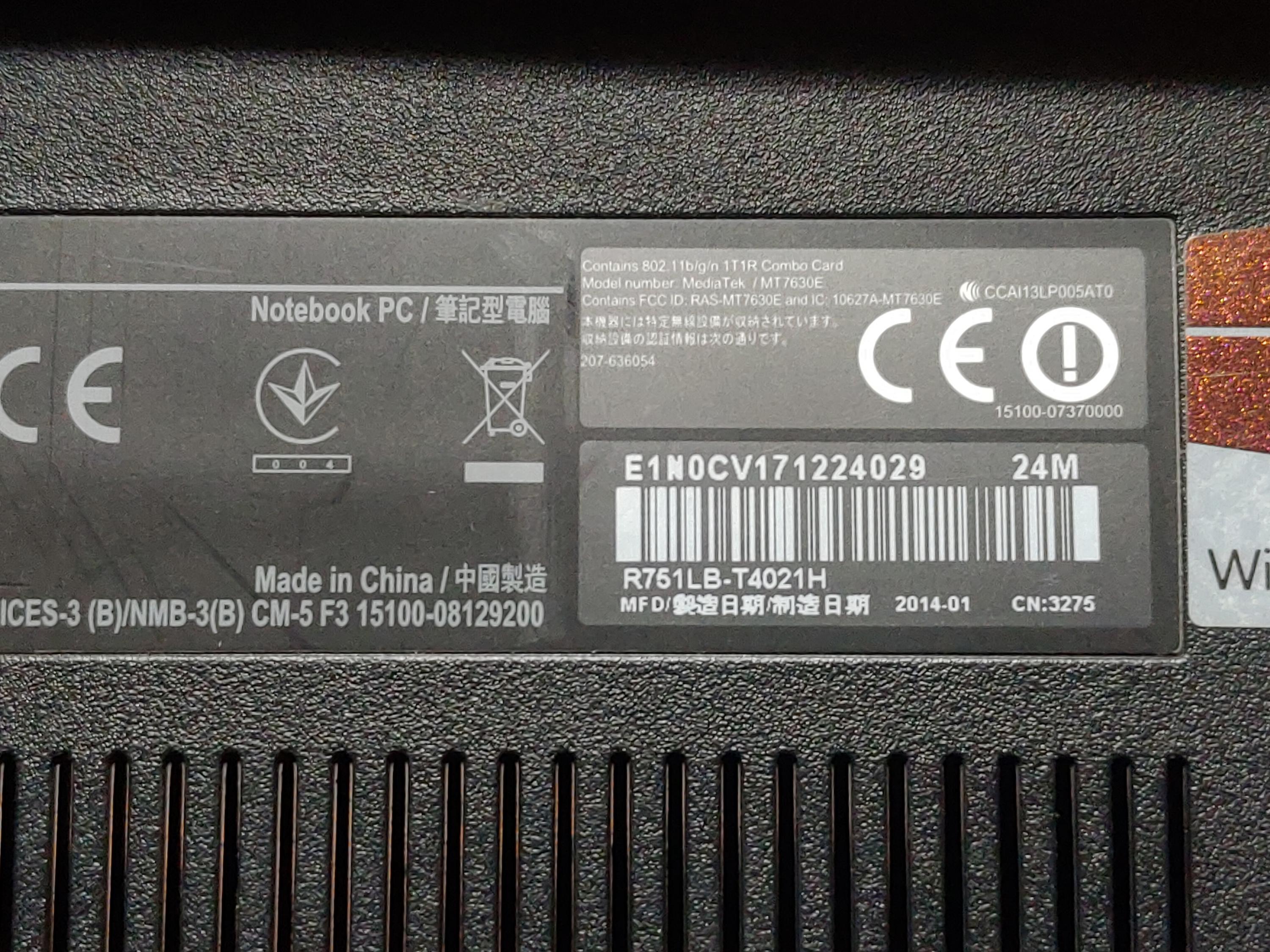

                            Re: Asus R751L Black Screen (MB: X750LB) bios
                            Hi guys, I have a question, I have the same laptop with the same issue starting up nothing on screen, Ive measured board everything looks fine, but as far as I can see somebody tried to flash bios and for 100% its not the original one, can someone give me any advice what now, like I understatnd u need old dump to clean Me but what in this situation if I dont have it ??
                              • 21922
                              Post the laptop serial number, your bios backup (even if it is the wrong one) and a picture of the white barcode stickers on the motherboard
                              • pcrepai
                                • Jul 2021
                                • 46
                                • Nederland
                                okay, all I could find in attachments, as you can see sticker looks bad, sorry man but this is how I get this laptop, obviously somebody tried to fix it You can see flux etc but its not a point, If you can help me Ill be gratefull.
                                  • 21922
                                  Try this one.If it doesn`t boot i don`t think its a bios problem.
