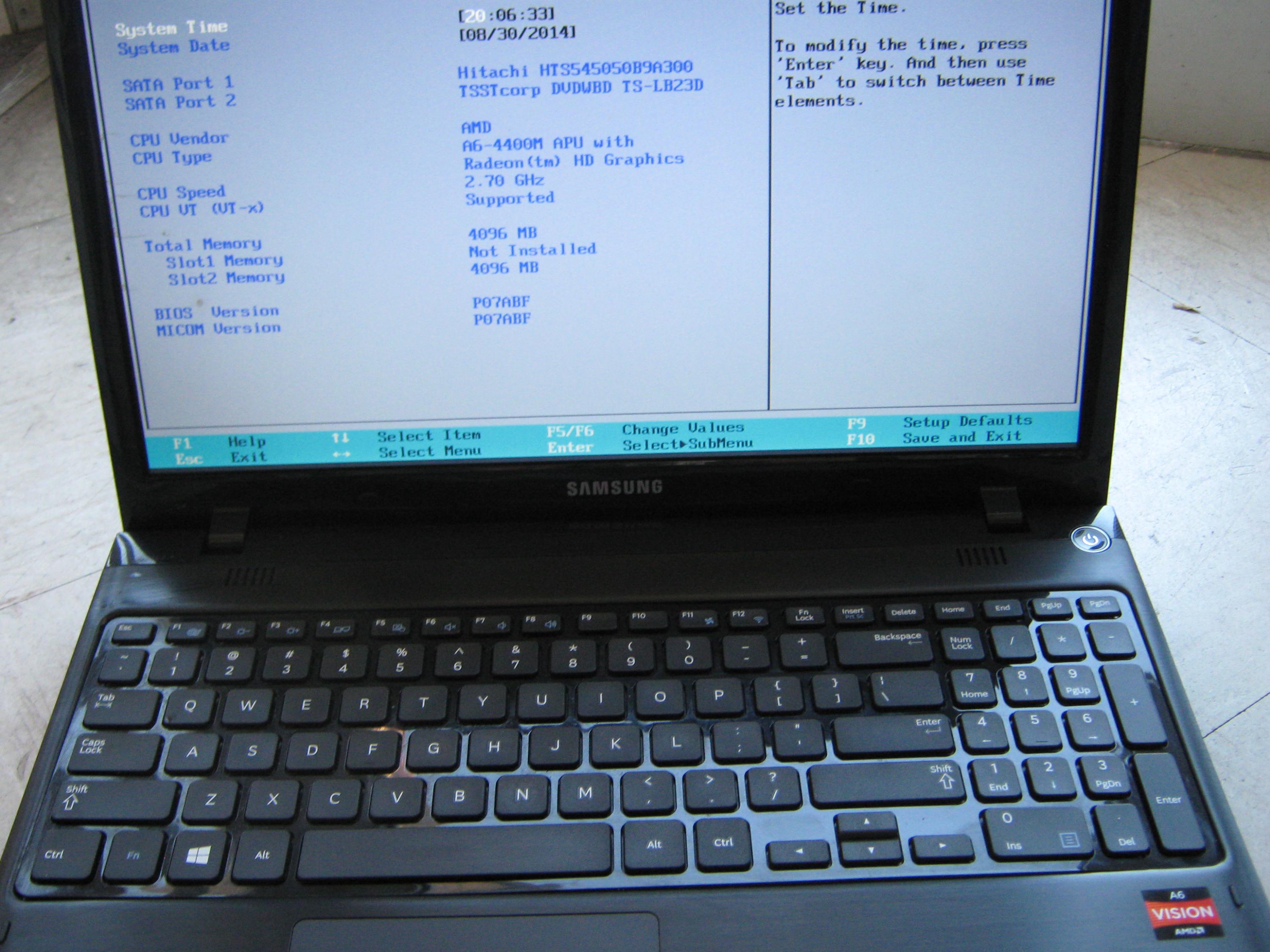

    Hi, Every time power on this laptop goes straight to Bios screen, there is no memtest or anything else boot up screen.
    Brand: Samsung
    Model: NP-365E5C
    I suppose could be a BIOS problem is anyone come cross with this fault?

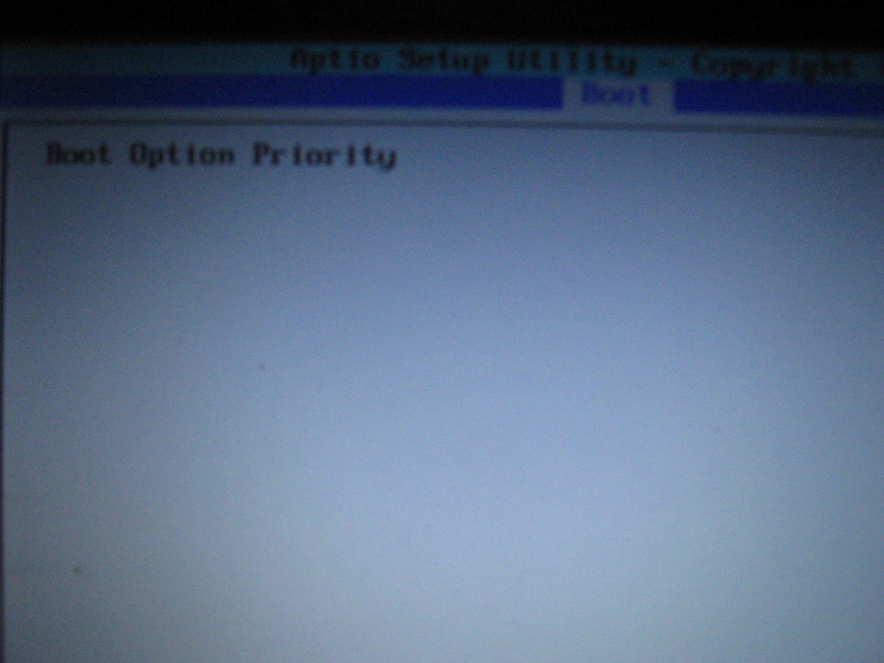

                      Re: SAMSUNG NP-365E5C Goes straight BIOS Screen

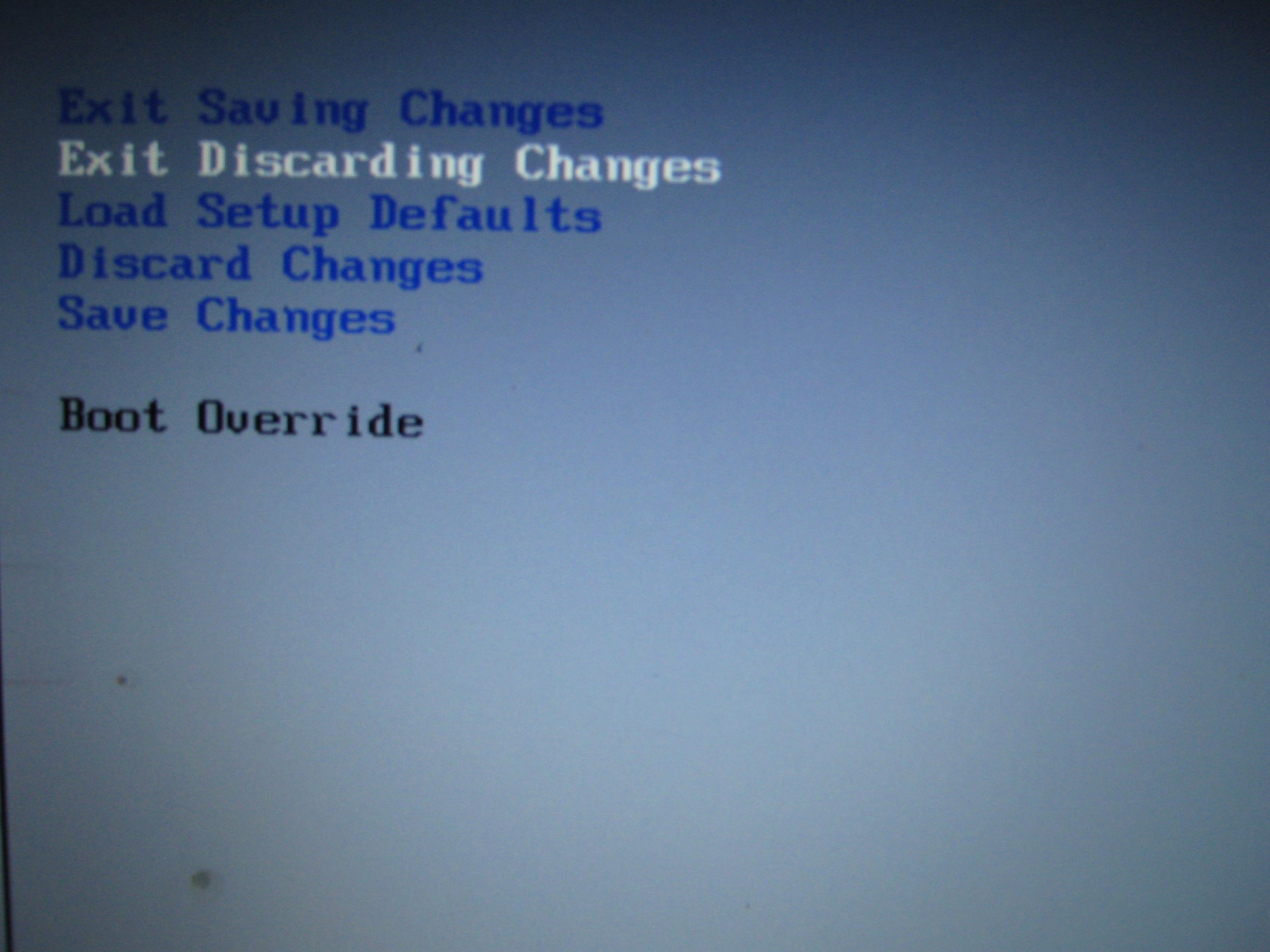

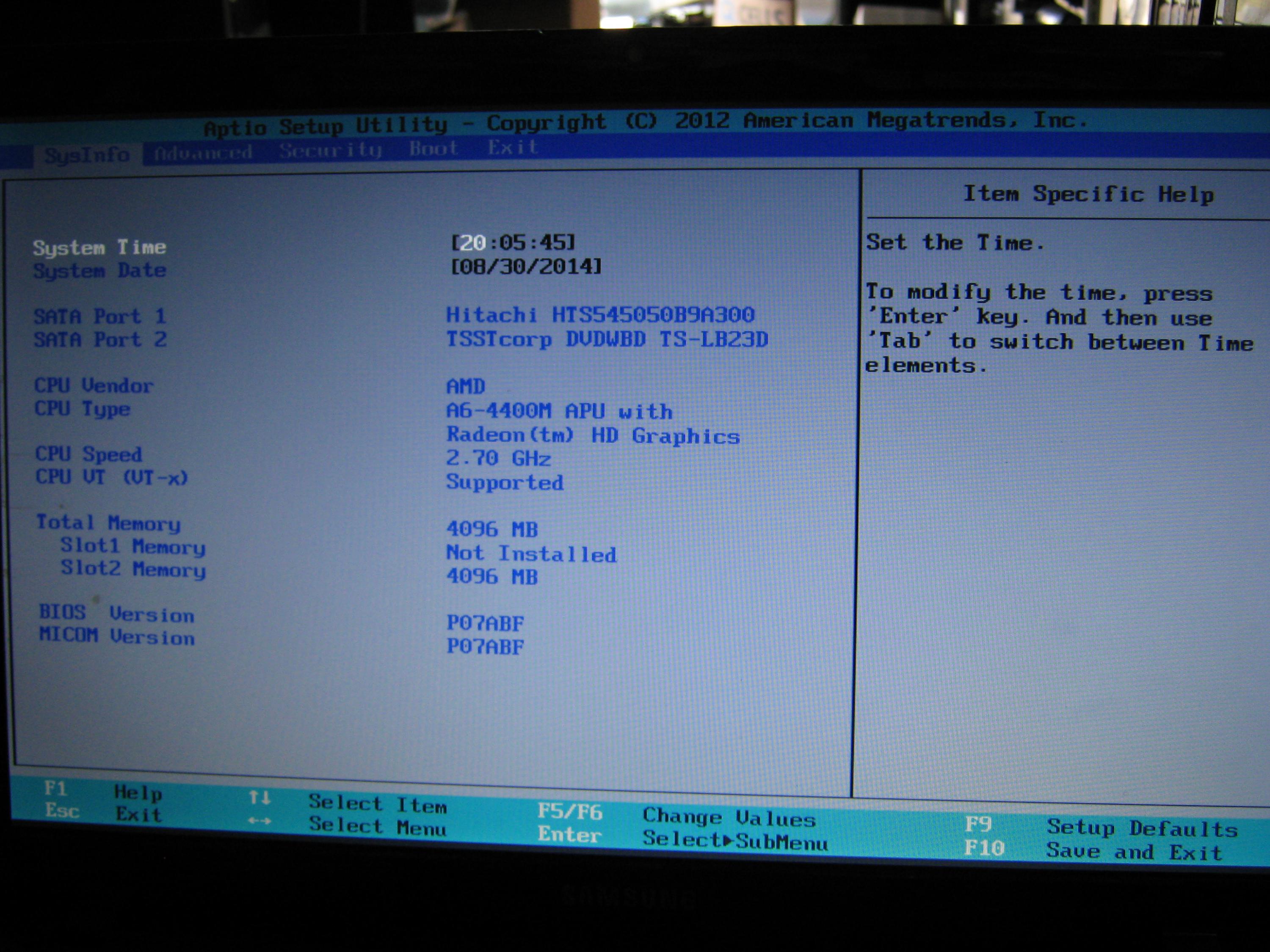

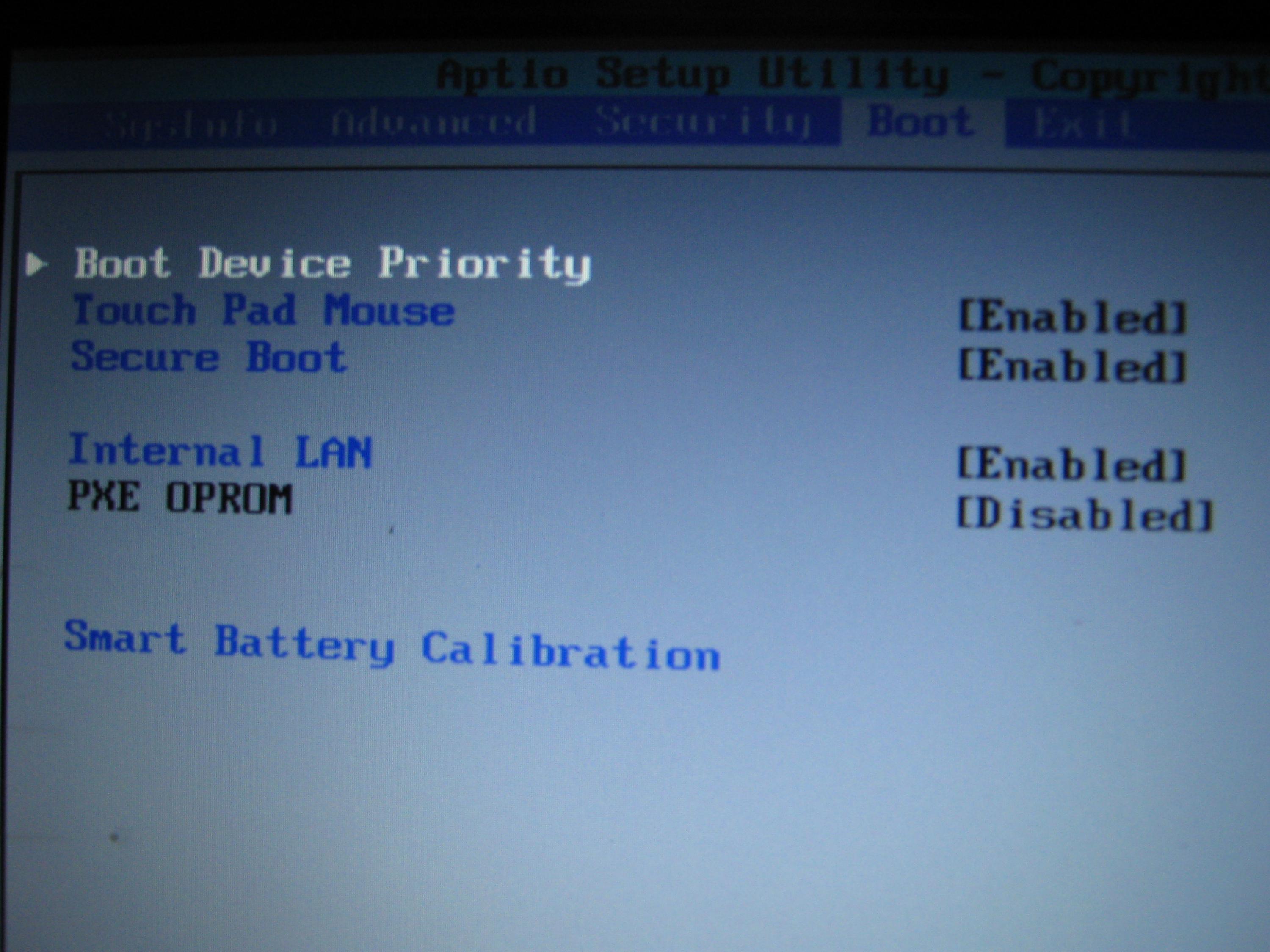

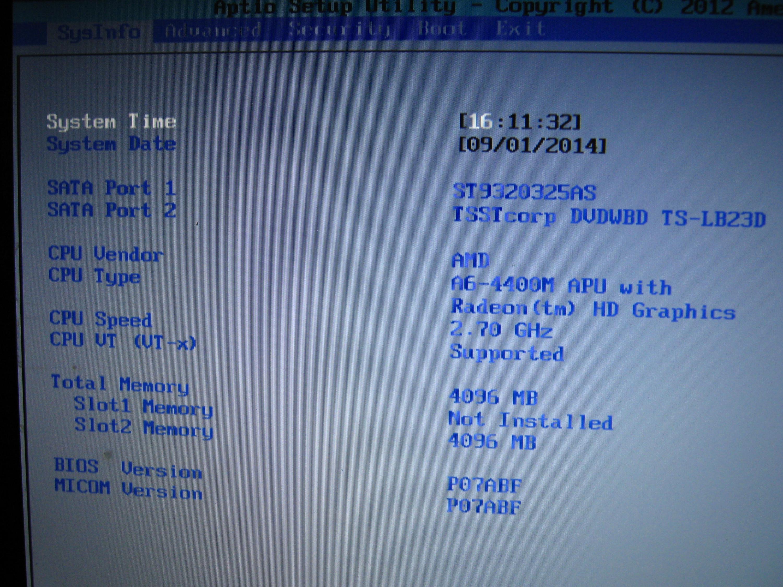

                      I found missing device (empty) in propriety boot up page although on the first it was detecting DDRW and HDD. Bios page pictures attached.
                        Looks like a southbridge problem to me.
                              Disappearing devices from the boot menu cannot be a BIOS issue, it's 100% got to do with the SB.
                                disable secure boot and try to boot from a cd or pen drive and also check for uefi boot option if available change it to legacy boot
