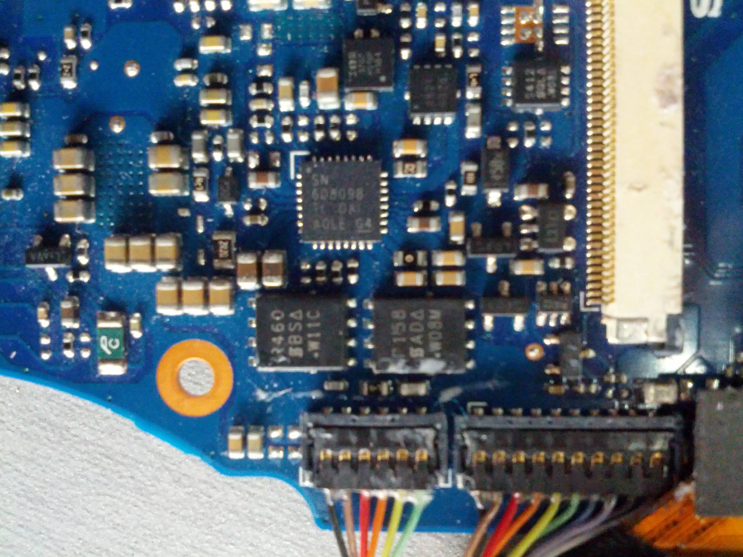

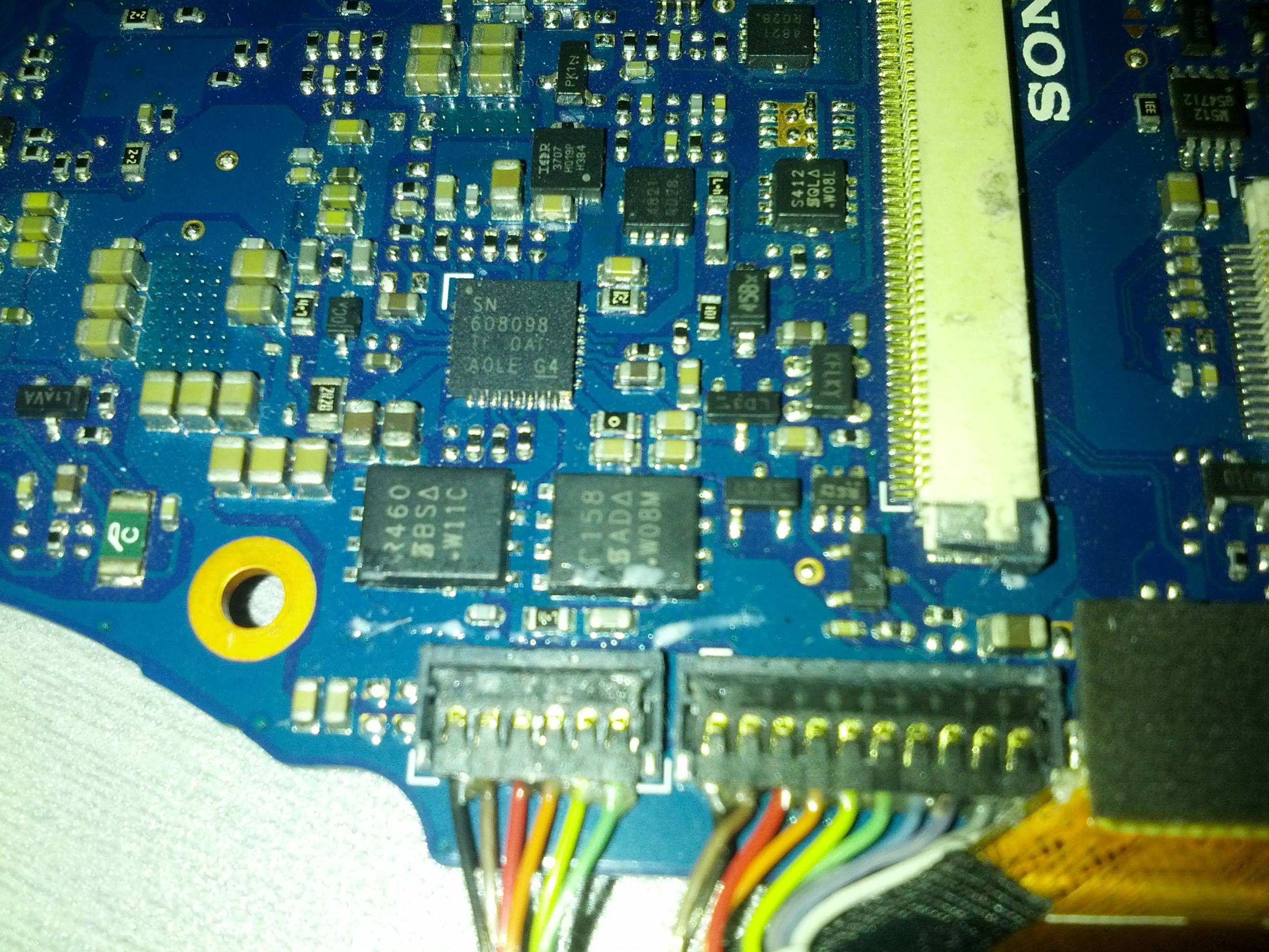

How do you know that's PC205?
I've got a volt reading here:

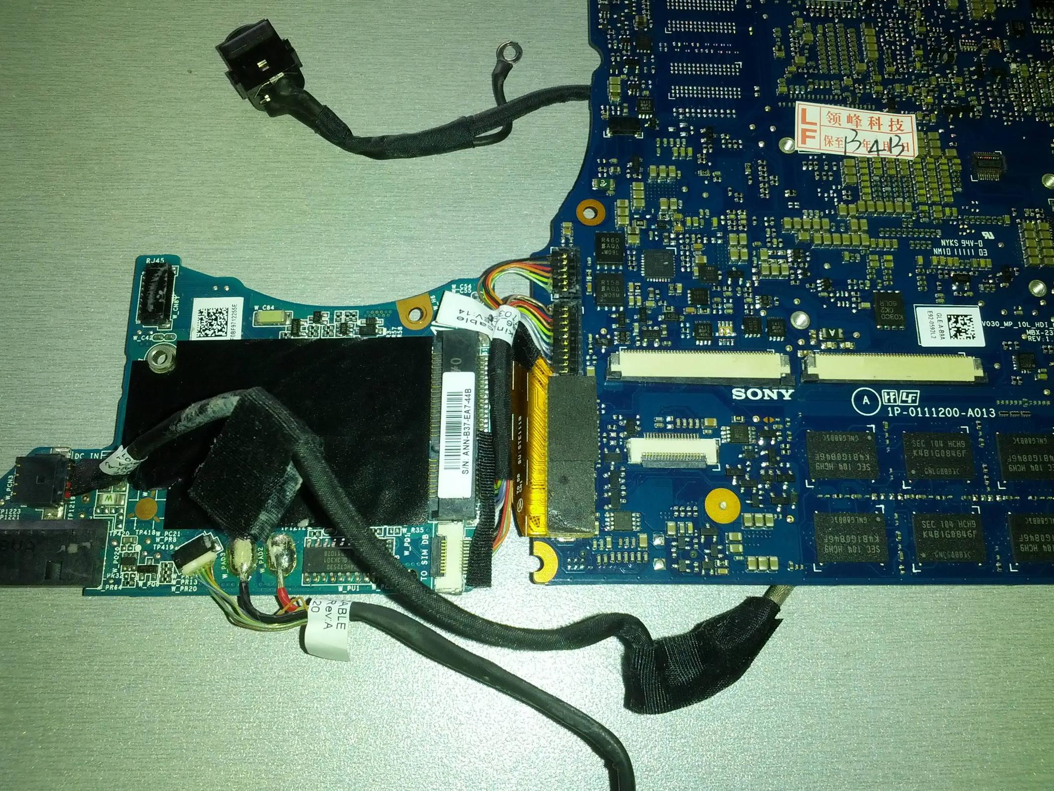

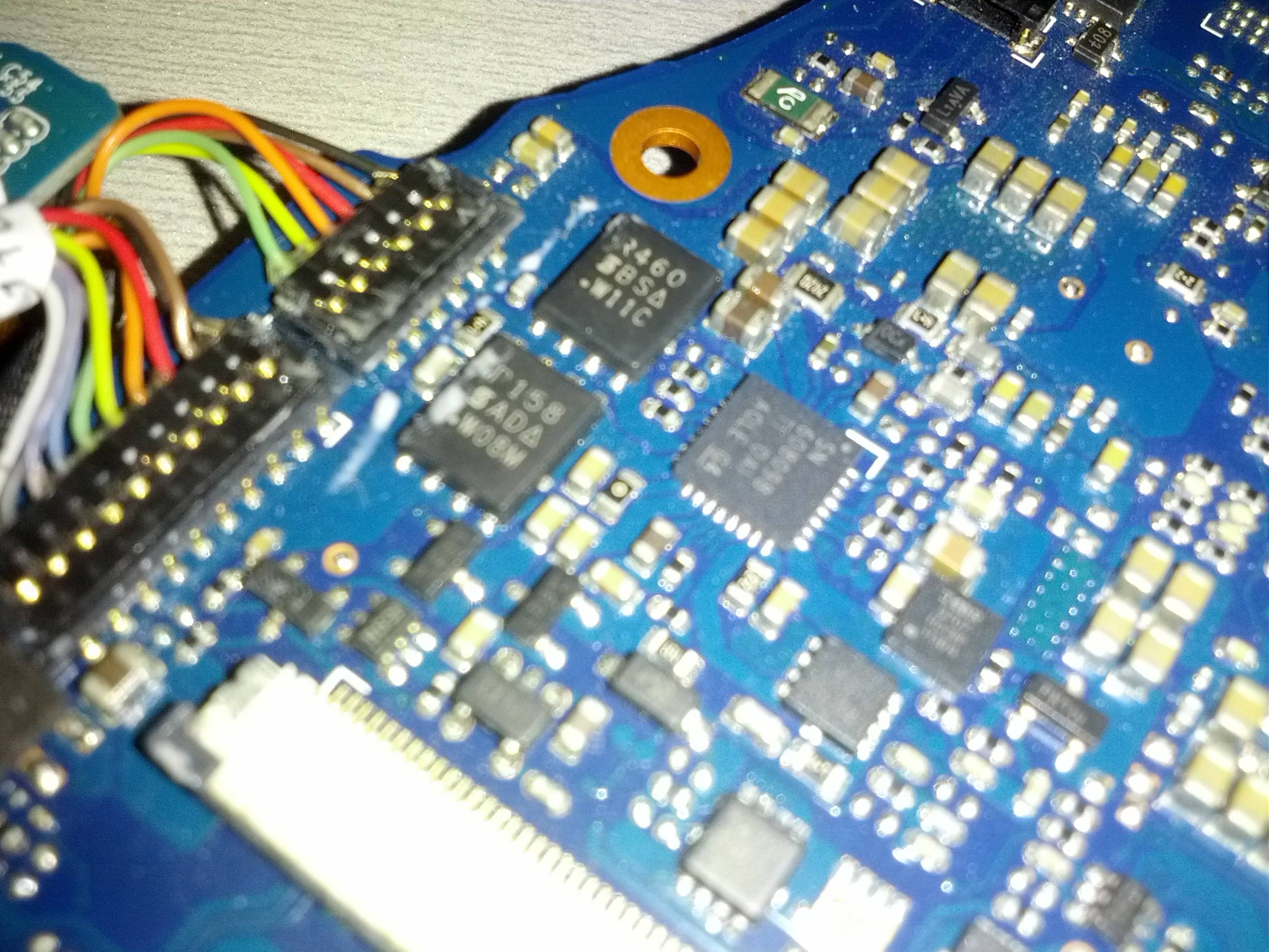

Here are some extra images you can see to look for DCBATOUT:
you don't need to find PWRSW#_DB and +ECVCC, pin 7 of SN0608098 must have more than 3,3 volts, as you can read in the data-sheet of ISL6236, that is almost pin to pin compatible, so SN0608098 probably is asking to be changed.
