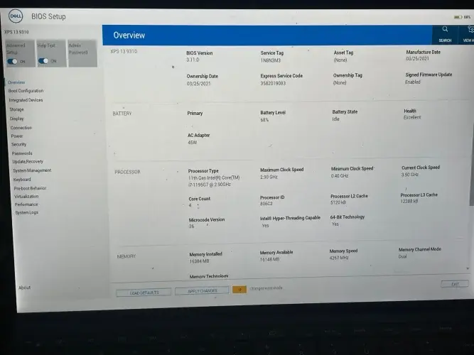

                  Good evening, everyone. I have XPS 9310 LA-J144P Rev 2. S/N: 1N8N3M3
                  The unit with original file was doing loops on logo (After Update). I've flashed this file that I have found here (I think), and it's the only one that worked.
                  This file works after couple of reboots but takes me to BIOS GUI. NO SSD Detected, and the issue isn't the hardware, it's the BIOS file itself, because i've had a very similar issue with LA-L882 in the past with the same issue. Good is the file that i got from somewhere online...Bad is the original file. I'd really appreciate it if someone could help. Many thanks!

                    #29
                    Hello you can try this file ...
                    • iTec
                      • Oct 2017
                      • 29
                      #30
                      I appreciate the reply, sir. The machine didn't power on with the file above.
                      • Markus1741
                        • Sep 2020
                        • 925
                        • N/A
                        #31
                        It's a shame to hear it didn't work, but Dell XPS 9310 are difficult candidates when something goes wrong with the BIOS.
                        Just try that one again, otherwise I don't know what to do.
                        Feedback is always nice.
                        it's the only way to improve.
                        • iTec
                          • Oct 2017
                          • 29
                          #32
                          Sir, thanks again for trying. The file above gave display, but freezes on logo. I appreciate you trying.
