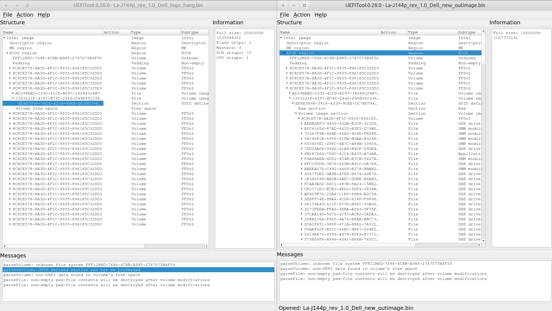

Dell XPS 9310 LA-J144P REV 1.0 bios fix
  • down1nit
    • Oct 2016
    • 29
    XPS 9310 gets image of dell logo and powers off after the 6, 3.
    Service tag: 2C1B3F3
    I tried my hand at it with FIT and ME Analyzer but was not successful

    Re: Dell XPS 9310 LA-J144P REV 1.0 bios fix
    Here's your New BIOS file, try it and let me know the results.
      No worky. I love you though.
      Flashed using a xgecu II. Seems to do the same as before. Dell logo comes on, it goes away briefly, comes back, does the 6 white, 3 amber about 4 times in a loop and powers off again. Pulling plenty of current when off so it's charging battery ok.
      I have tried all the ways I know how of performing a recovery (i think i've only had ONE dell bios recovery go to plan), ctrl-esc, fat32 on a 8gb usb 2 drive, ntfs just in case too, bios_img.rcv BIOS_IMG.rcv etc.
      Is there an EC bios too?
        As far as I know, your BIOS file contains an EC Region (Shared Storage). I have no idea if your SIO is Programmable or not.
        You could have a Hardware Issue, create a New thread there:
