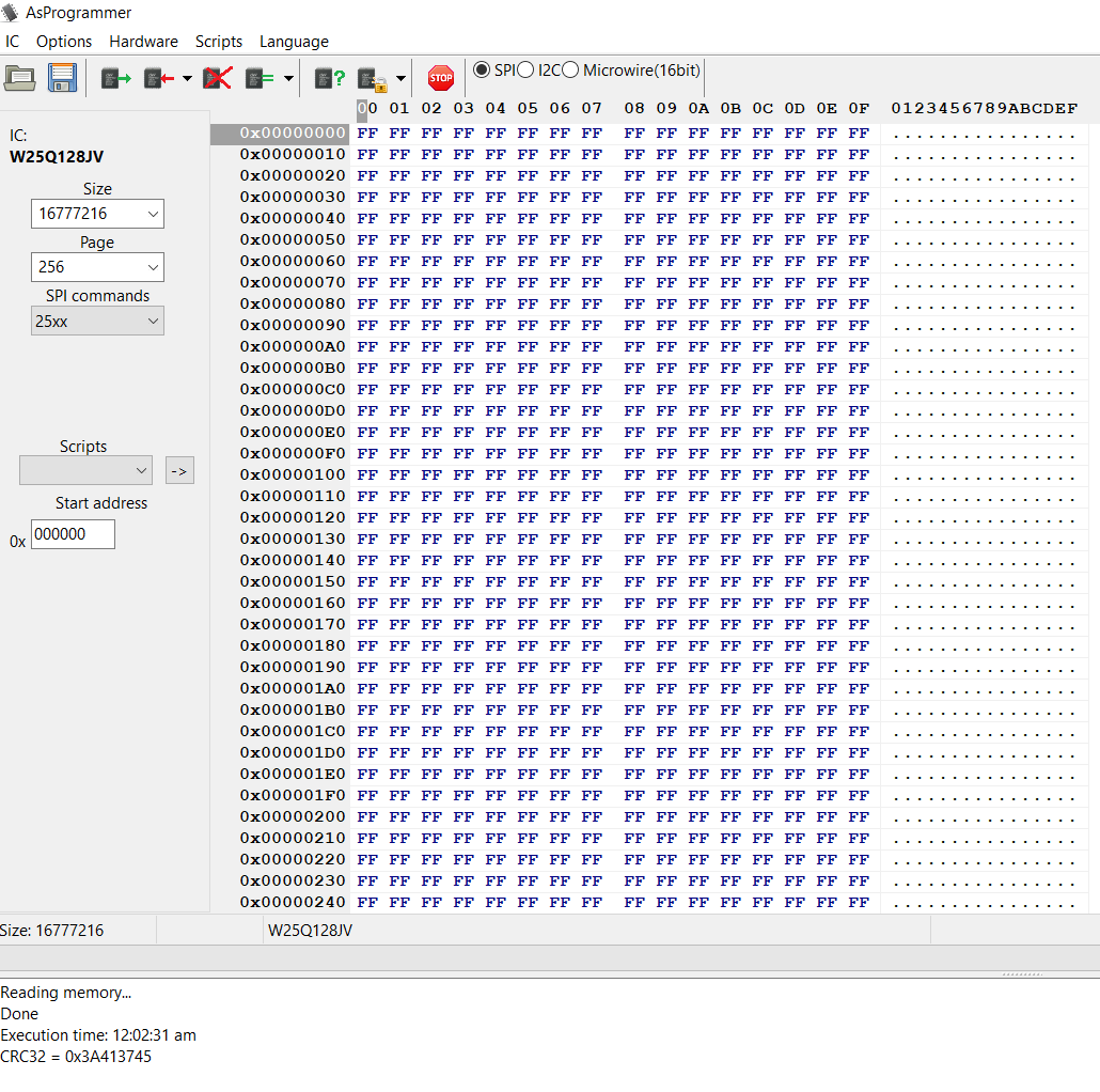

                  Hi good sirs,
                  Model : Lenovo Ideapad 5 15ALC05
                  MO : PF9XB1530160
                  MTM : 82LN00EMSB
                  S/N : PF2X5P8J
                  When i power on the keyboard lights up and goes off ... nothing on the screen ... no boot.
                  Appreciate any help. Thank you.

                    #129
                    post the original content of the bios chip, even if it is corrupted..

                        #131
                        Hi Peste (again)
                        I misunderstood that I needed to unsolder the bios chip and place it into a gadget to reprogram it.
                        It seems that I can use a wired clip instead ...
                        Let me dig around more on the forum, please bare with me .. 60s boomer here; but i'm willing to learn if u can guide.
                        Thank you

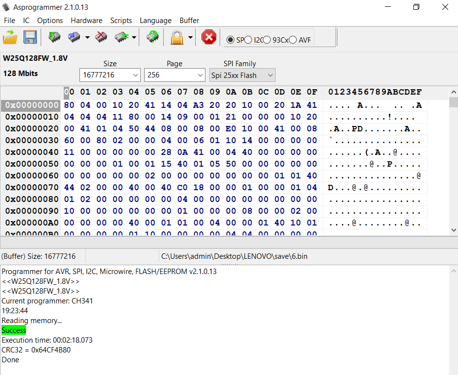

                                15alc05.zipHi Sir (again) !
                                I managed to order a CH341a (green gadet with the voltage selector switch at 3.3v) ... the bios chip on the Ideapad5 15ALC05 is a Winbond 74M12JWS1Q .. but on ASProgrammer 2.1.0 it is not listed .. I used W25Q128JV (taken from one of the posts earlier) .. this is the 1st time im doing this , so im not sure if thats the .bin you require ... i can redo again as needed.
                                Thank you

                                  #137
                                  Thank you
                                  your chipset 74M12JW is 1.8V, use W25Q128JW and 1,8V adapter.

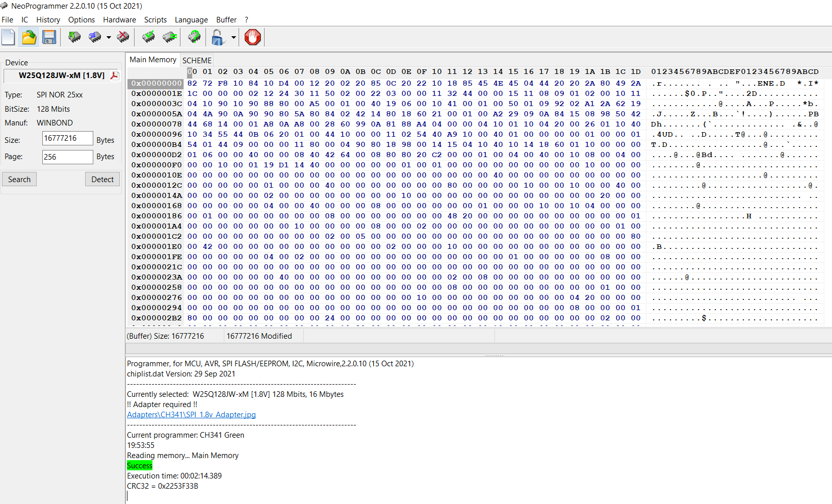

                                    #138
                                    Hi good sirs,
                                    1.8v does read alot more than just rows of FF.
                                    Heres the zip. hope it helps
                                    Thank you

                                      #139
                                      Hi good sirs,
                                      Thank you
                                      nope, your backup is not good. Check contacts and let NeoProgrammer to autodetect chipset, even is not listed it should detect ID (i.e EF4018). Do more readings and compare them, when you have 2 identical it means you have a good backup.

                                        #140
                                        Hi!
                                        This time I used NeoProgrammer. Hope it is fine.
