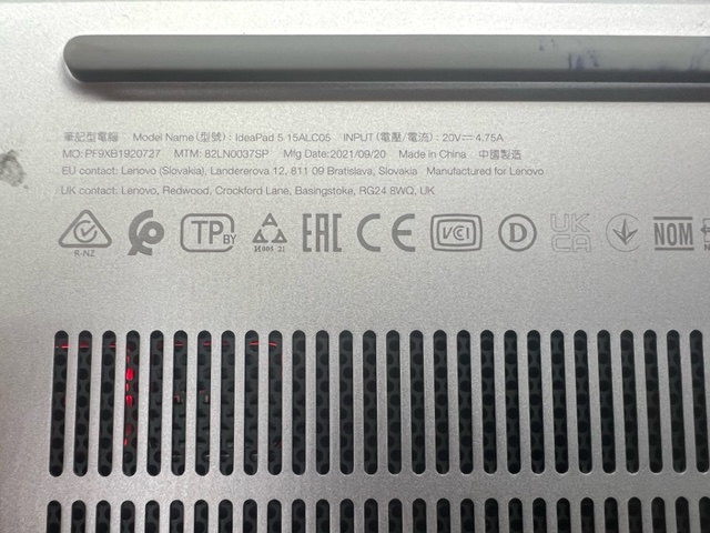

                  I have the same model on my table, the new ideapad 5-15ALC05 (82LN) died after the bios update.
                  Completely new, just while preparing for the customer.
                  Bios version H2CN31WW
                  After update - just keyboard lights and a black screen after the power button.
                  Maybe You know some kind off bios recovery, from USB or something?

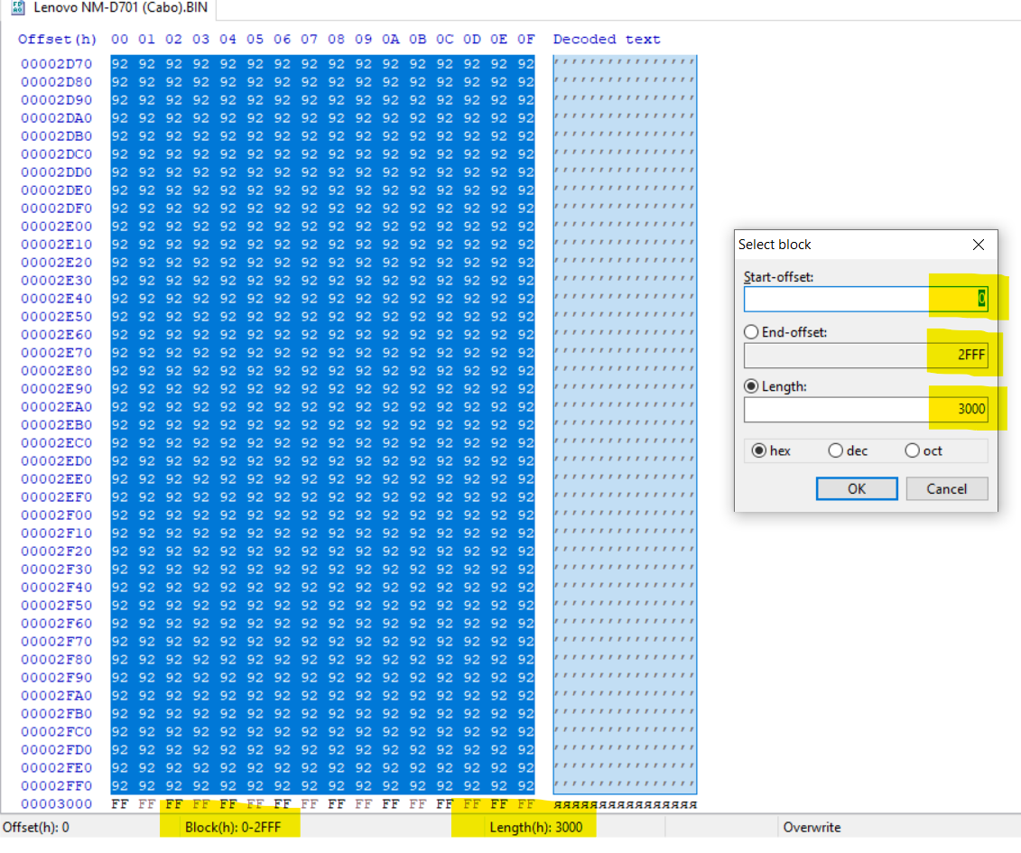

                                    But before that replace the DMI with yours - see the attached image:

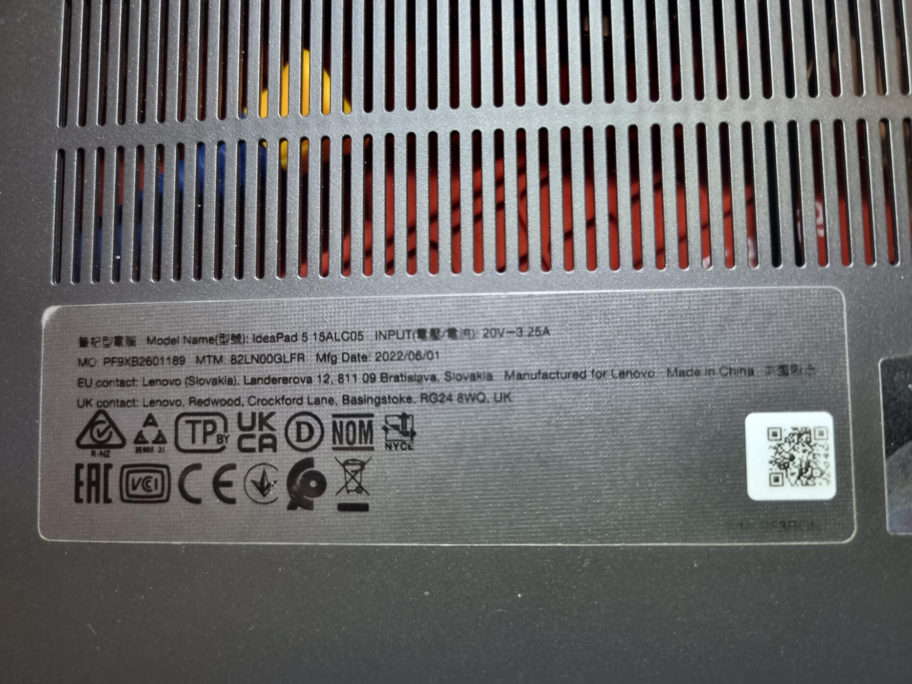

                                        Lenovo Ideapad 5 15ALC05 , HS553 MN-D701 Rev 1.0 Rayzen 7 Black Screen
                                        Please, repair this Bios , Machine respond to Power on But without image (Black screen) , Thanks in advance!
