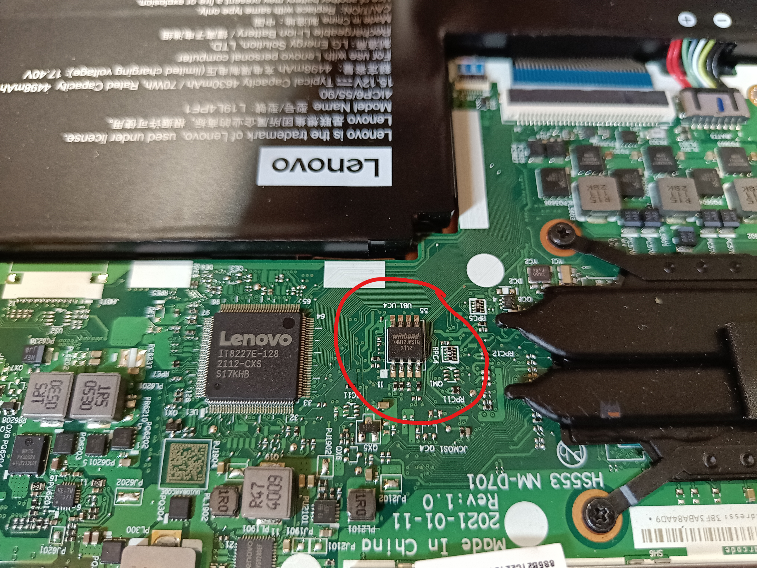

                            Hello, i'm very new to all this. I also have this laptop "Lenovo IdeaPad 5 15ALC05" wich doesn't boot (screen is black). What do I have to do to flash that bios chip? I don't know anything about all that and would be happy for some information or resources (:
                            "Winbond 74W12JWSIQ"
                            is this the bios chip? The 'W' could also be an 'M' I think.
                          • thesumate

                            #94
                            Okay, thanks so I'll have to get such a programmer. Is this the bios chip? It says "Windbond 74M12JWSIQ 2112". I don't have that programmer yet but I already downloaded its software. I couldn't find this chip there. Is there another chip on the other side of the board so I have to take the laptop apart? Or is it the right one?
                            Click image for larger versionName:	image.pngViews:	0Size:	7.94 MBID:	3290329

                              #95
                              Ok, so on the front of the mb there is nothing but this one chip that looks like it could be a bios chip. Since this is all over this laptop model, does anyone know where its located? The back of the motherboard also has some sort of shield on it and I dont really want to unscrew it and take that shield off.
                              EDIT:
                              I removed the board now and also looked on the underside under the shield thingy for possible bios chips but there weren't any chips at all. The only one that looks like it is the one from earlier called "Windbond 74M12JWSIQ 2112"
                              • peste
                                • Dec 2016
                                • 13422
                                • ROMANIA
                                #96
                                EDIT:
                                Winbond 74M12JWSIQ is the bios chip...

                                  #97
                                  Ok perfect. But I can't find this chip in the software for the spi programmer. This chip isn't listed there. What do to? Or do I have to get another program?
                                    SMDFlea commented
                                    Editing a comment
                                    Choose W25Q128FW manually from the chip list

                                  #98
                                  use one of these programs.. if you can't find it, get a chip from the database equivalent to what you have in your laptop..
                                  don't forget to make a copy of the original bios before writing with new content..
                                  https://www.badcaps.net/forum/showpo...6&postcount=10
                                  https://www.badcaps.net/forum/showpo...postcount=7​

                                    #99
                                    Alright thank you very much!!
                                    "get a chip from the database equivalent to what you have in your laptop", so do I have to look for a chip that's available in the software with the same properties as here:
                                    https://www.winbond.com/hq/product/c...artNo=W74M12JW

                                      #100
                                      yes..yes.. but try the two programs, maybe you have the chip there..
