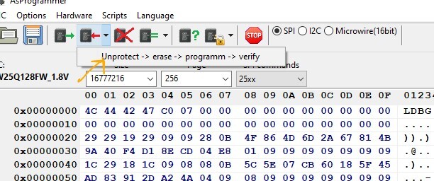

    #101
    I downloaded multiple programs now but I can't find my chip in any of them. What do I have to select instead now? What could go wrong if I select another chip so read another chip?
    • thesumate
      • Jun 2024
      • 11
      #102
      ok, if i select this chip "W25Q128FW". I can read and write without issues event tough my chip is called "74m12jwsiq" ? So I can write the bios from lenovo website right on it and then it should work?
        • 22114
        #103
        Make a backup and post it here.
        • thesumate
          • Jun 2024
          • 11
          #104
          Ok, perfect! I just wanted to make sure it's working for my chip before I buy something. This programmer is fine? https://www.amazon.de/EEPROM-Program...ustomerReviews
          And I can basically use any ch341a programmer software right? Or should I use a specific one?

                #107
                I got the programmer and read the bios of my 15-alc05 now. My Bios chip is called "74m12jwsiq" but asprogrammer automatically suggested "W25Q128FW". What do I have to do now? How do I add that DMI info and what is this? is it necessary? Here is my bios backup (i have packed two files into the folder on one I just clicked save and on the other i added .bin when i saved it)
                • peste
                  • Dec 2016
                  • 13759
                  • ROMANIA
                  #108
                  try the bios from post #55, there is also the interval where the DMI information is found, use the HxD program (you can find it for free), enter both bios into the program, select the interval in both bios and pass the interval from your bios to the interval from the bios from postl#55 (copy-paste), that's all..

                    #109
                    Ok, so I select the hex values from 00001000 to 0002FF0 (there is no 2FFF) and copy all that in the file from your post#54 (h2cn31ww.rar) even though I can't read anything there right?
                    the text says this:
                    "LENVk������� ¦O†Mm*gKš@ôÑŽÍè \^Ë`_E­ƒ‘-¢J
                    8<:><0=?9;1;:\^Ë`_E­ƒ‘-¢J *ç~á®â‰æ1ú¢¡CÐ8âø´4‚ C°£*«Ë{ \^Ë`_E­ƒ‘-¢J YO;SDLHJ\^Ë`_E­ƒ‘-¢J Z\^Ë`_E­ƒ‘-¢J @mlhYhm)<)8<HEJ9<\^Ë`_E­ƒ‘-¢J​

                      #110
                      the text says this:
                      well, there's nothing to read there, because it's empty, the bios being virgin...yes, you have to fill that empty space..

                        #111
                        ok, I edited that file now and pasted all that unreadable decrypted stuff from my backup to the virgin bios. Now I can upload it to my bios chip right? Do I have to click on that in my asprogrammer?
                        And I just copied everything in a range from 1000 to 2FF0 from my bios to the virgin bios. The start (0 - 1000) on my new created bios is just empty FF everywhere is that right?

                          #112
                          And I just copied everything in a range from 1000 to 2FF0 from my bios to the virgin bios. The start on my new created bios is just empty FF everywhere is that right?
                          yes, you can write the bios chip with the newly edited content..I haven't used that program and CH341A..I don't know to tell you anything about it..

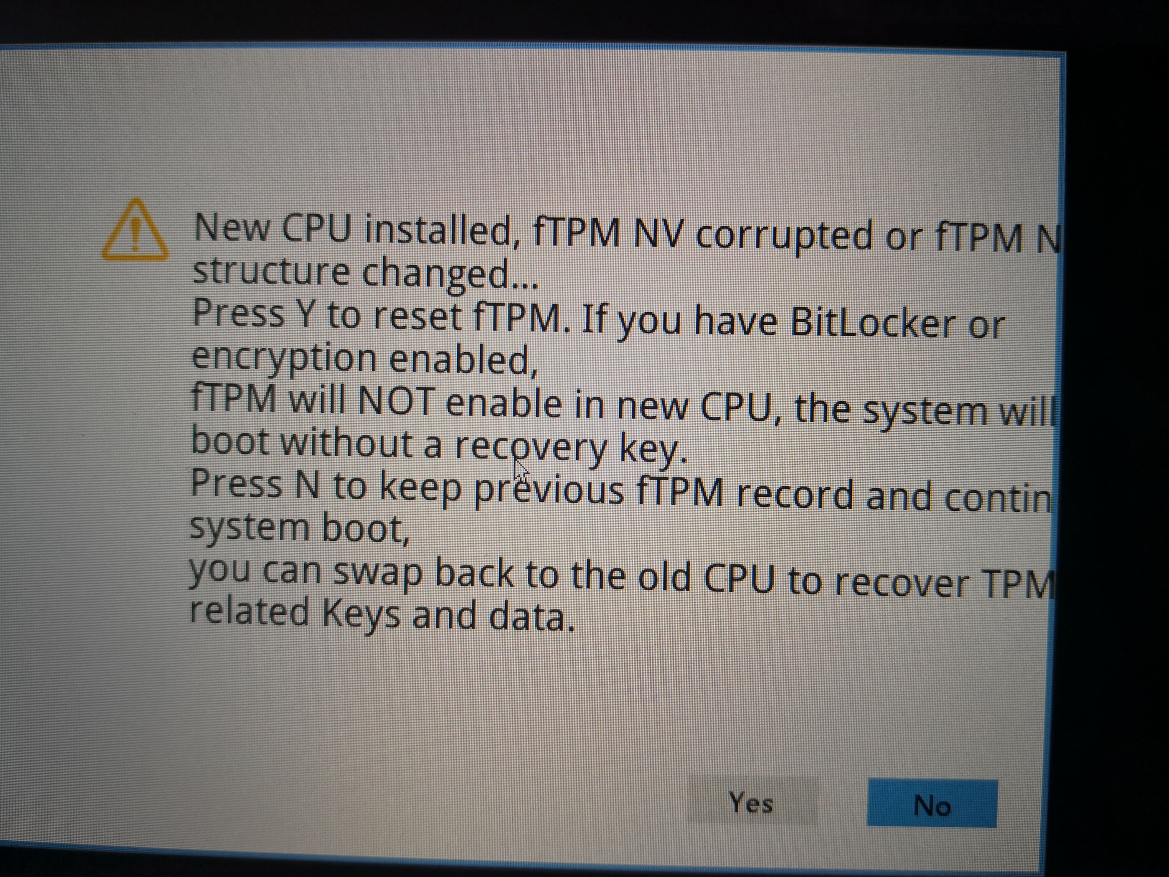

                                        #119
ID:	3486383 after the latest BIOS update I encountered a situation when during computer boot a message appears stating that "new cpu installed, ftpm nv corrupted or structure changed" and I have to press NO to continue boot. A checked Lenovo's forum and found that to fix the situation, I need to make a correction in the BIOS. The problem is that I forgot the BIOS password, or it was corrupted as well, and cann't enter it.
                                        How to get out of this situation?
                                        Computer Lenovo ideapad 5-15ALC05 Type 82LN, Bios Version: H2CN35WW, S/N PF39F46R
                                        P.S.
                                        The computer boots and works without problems after closing the message.

                                          #120
                                          Originally posted by aalex64
                                          P.S.
                                          post bios
