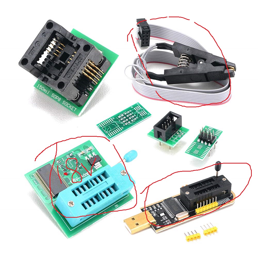

                Hello everyone, I have 2 questions to ask you.
                1. Is it necessary to use the 1.8v adapter to read the BIOS?
                2. What is the DMI and how do I change it when saving the new BIOS?
                I hope you can help me. Thank you very much in advance.
                • qayyum786
                  • Aug 2018
                  • 1959
                  • INDIA
                  #48
                  Re: IdeePad 5 15ALC05 bios please!
                  ans 1> Some bios chip work with 1.8 volt and some work on 3 volt
                  if your programmer is work only with 3v than you have to get a 1.8v adapter
                  ans2> dmi its a information regarding your laptop like your model/or serial number etc etc
                  when you make a bios backup it will save automatically in backup bios file

                    Hello.
                    I was wondering if the adapter was necessary since I have the same laptop model (15ALC05 82LN) and I need to reprogram the BIOS.
                    I am looking forward to your response.
                    • qayyum786
                      • Aug 2018
                      • 1959
                      • INDIA
                      #50
                      Originally posted by JeffCortez23
                      Hello.
                      Yes you must have
                      CH341A USB Programmer Kit with 1.8V Adapter to read and write bios file

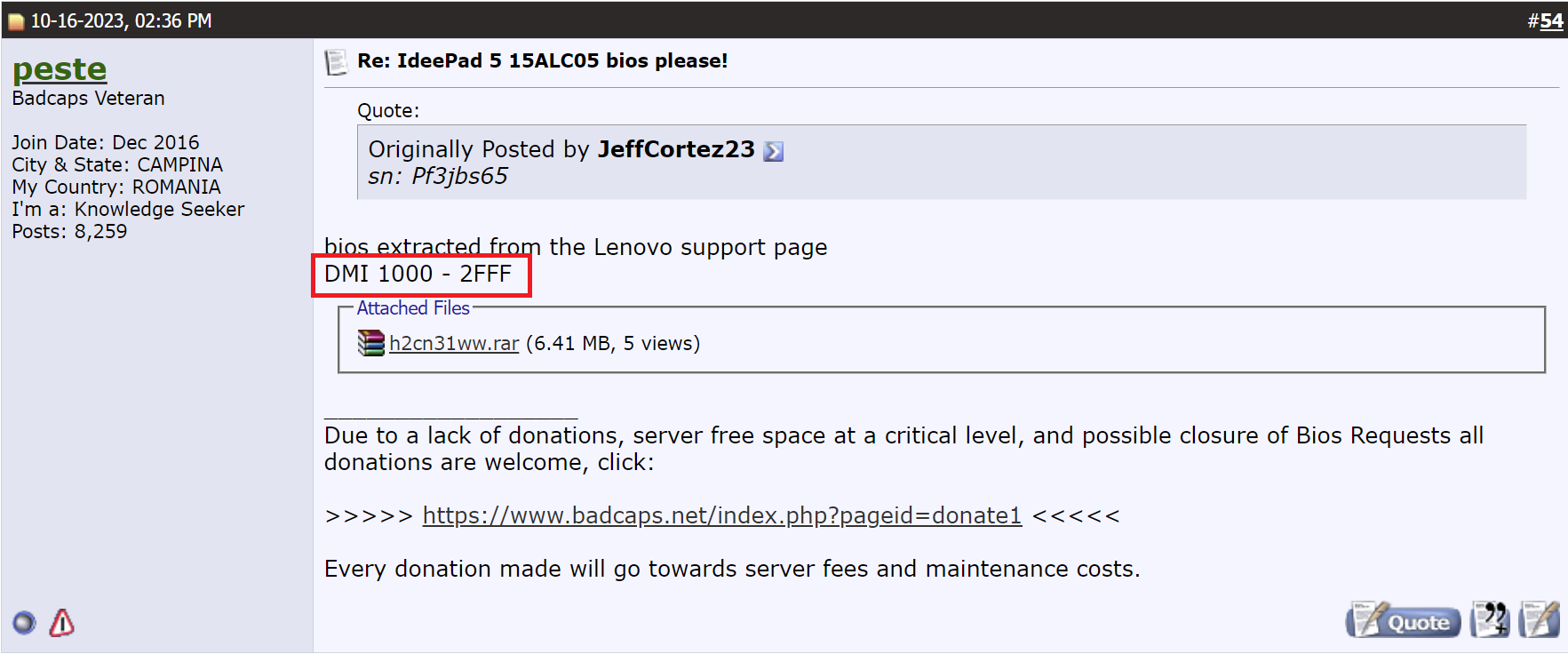

                            sn: Pf3jbs65
                            • peste
                              • Dec 2016
                              • 13422
                              • ROMANIA
                              #54
                              sn: Pf3jbs65
                              bios extracted from the Lenovo support page
                              DMI 1000 - 2FFF

                                It worked, but I don't have the serial number of my laptop.
                                • hoaca388
                                  Badcaps
                                  • Jan 2022
                                  • 12268
                                  #56
                                  Peste said "DMI at 1000h to 2FFFh", just copy it to the new bios file

                                        I tried, it works, but different serial numbers. How to change the serial number?
                                        • hoaca388
                                          Badcaps
                                          • Jan 2022
                                          • 12268
                                          #60
                                          Yes but I don't remember which program.
