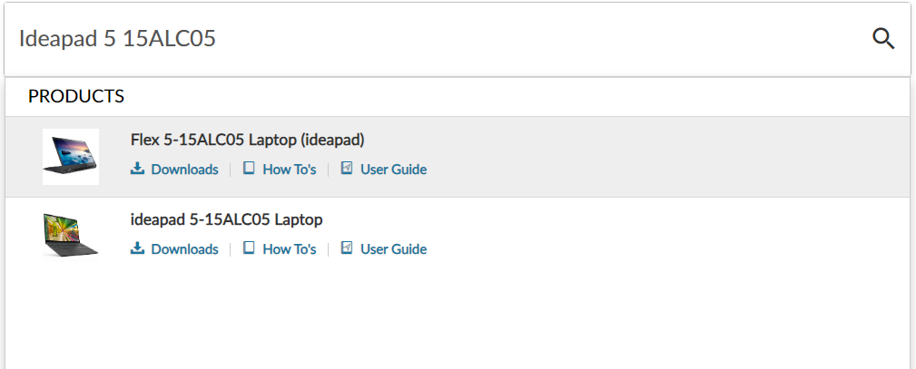

                                hi guys! Lenovo ideapad 5 15alco5 MO: PF9XB2825084 MTM: 82LN00HMPB S/N: PF42BSDD
                                HELP ME!
                                I downloaded the BIOS firmware from the Lenovo website, and now the caps, num, esc, power indicators light up when turned on. black screen. I don't have the original BIOS. what to do how to resurrect a laptop!
                                • hoaca388
                                  Badcaps
                                  • Jan 2022
                                  • 12268
                                  #76
                                  HELP ME!
                                  The original bios is obtained from reading the bios chip on your device.
                                  https://www.badcaps.net/forum/troubl...21#post1622421
