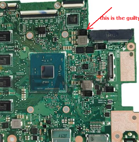

    I haven't worked with electronic components in years and some of the current smd's are difficult for me to identify. In this case, is it a capacitor? which measures 4.5 x 7.4 mm. and is 1.9mm thick.
    The text on it is: 330 then comes a logo and follows 2R0 and below G39.
    Can you help me to identify it?
    This is to order the spare part because this one has a short circuit and the encapsulation is open.
    Thanks in advance.

      Appears to be a 330uf tantalum cap.
      Does it have 2 leads (top side & bottom side) ?
      Then it is a capacitor. Post more pix from the other side of the part.

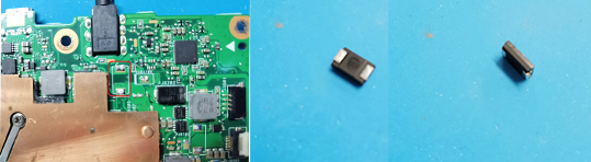

        SMD CAP Aluminum Solid Electrolytic Capacitor - ECAS series

          Originally posted by Repdata
          what kind of name is on the board ?
          Sorry but there is no printing on the motherboard component.

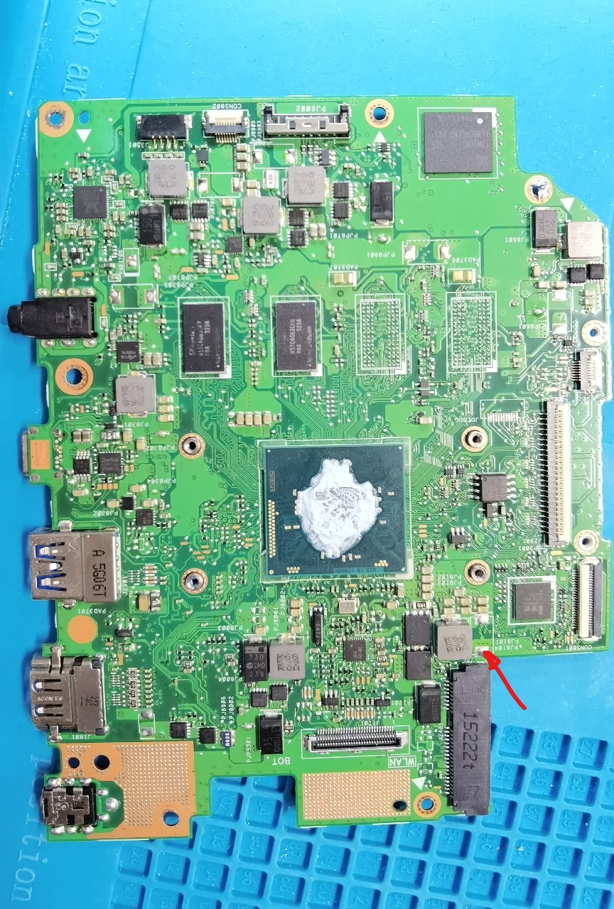

              An complete view of this small motherboard.
              Fron the information posted by J_R (thanks) I assume my cap has to be ECASS‐331E09 and triyin to get some on Google I only find the flier with the specs.
              Could some of you teach a newby how to purchase a cap with this specification number, please?

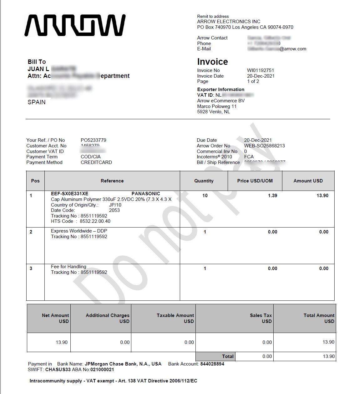

                                I've received today the capacitor. I'm happy. See the invoice
