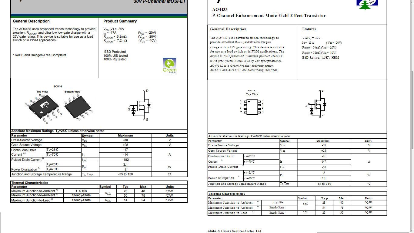

              Re: lenovo y50-70 VIN mosfets gets hot & possible short
              can i change ao4455 to ao4433, some values are diffrent a little
              • mcplslg123
                • Jun 2015
                • 7262
                • india
                No, there is huge difference in pulsed drain current. 4433 Will instantly burn out.
                • swammyw
                  • Apr 2021
                  • 66
                  • finland
                  ok thanks
