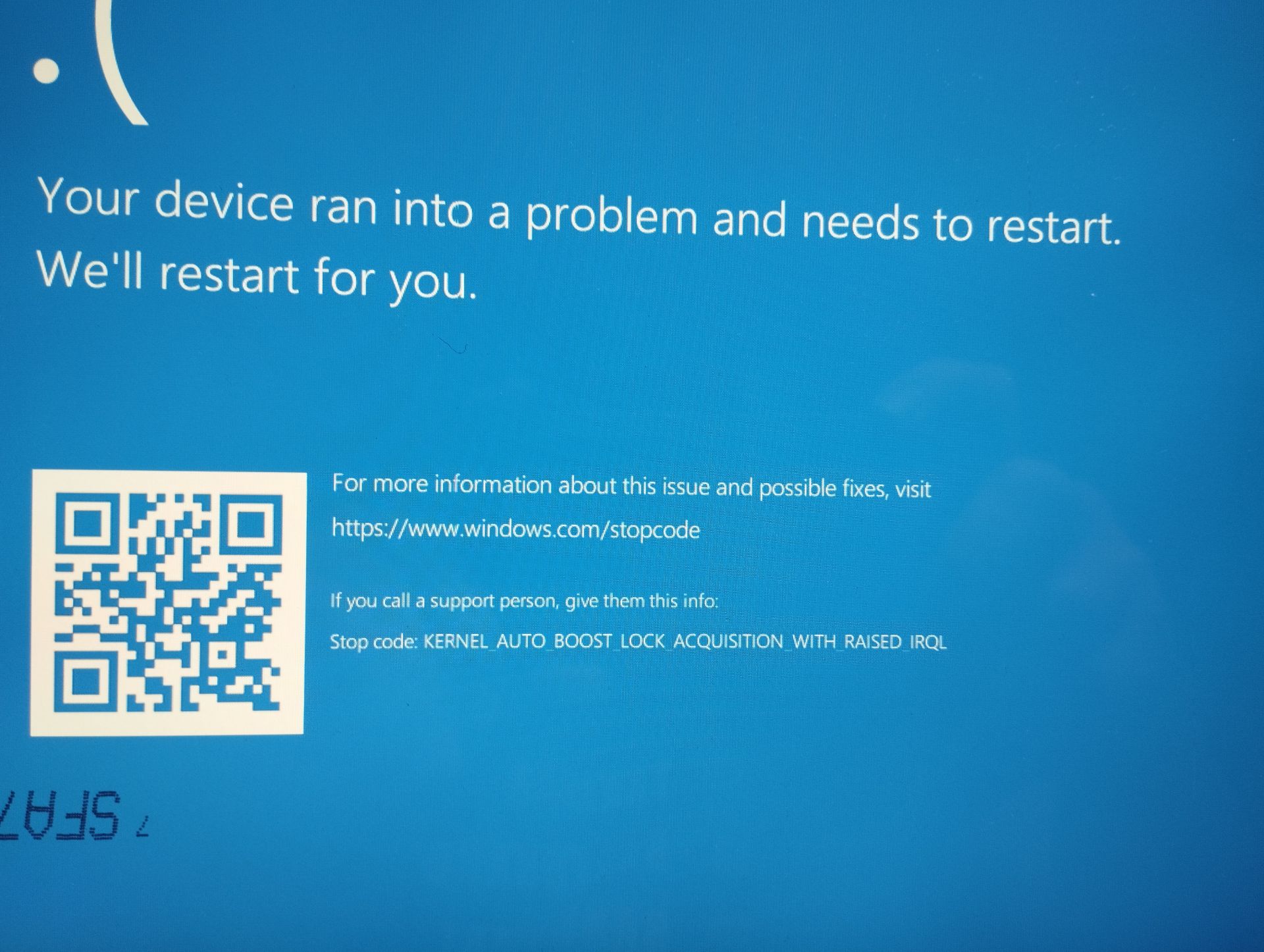

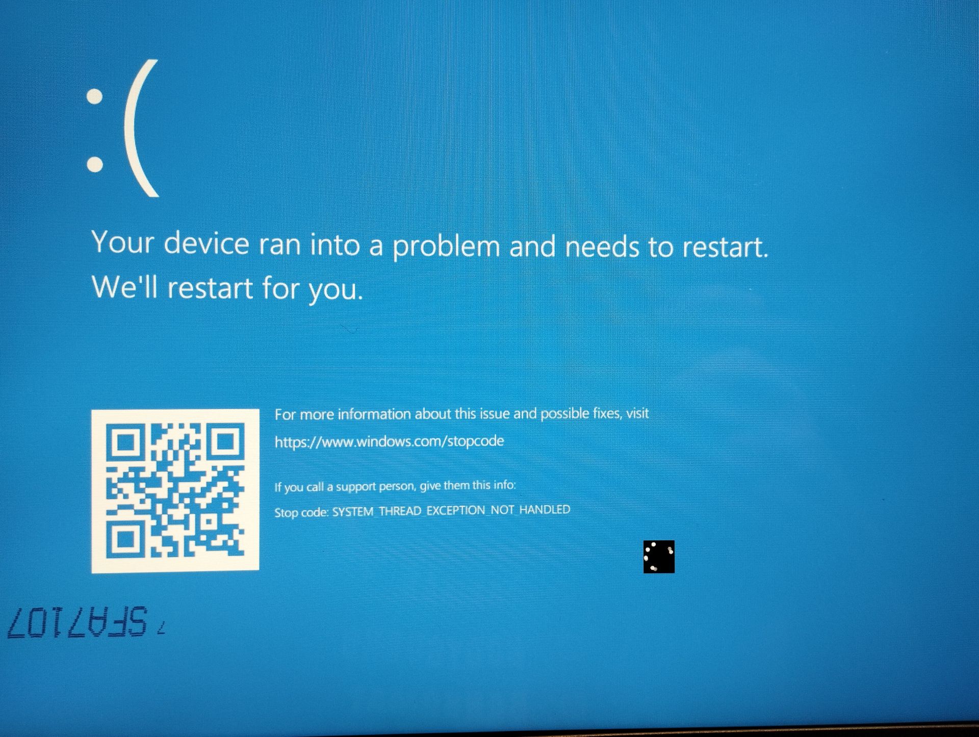

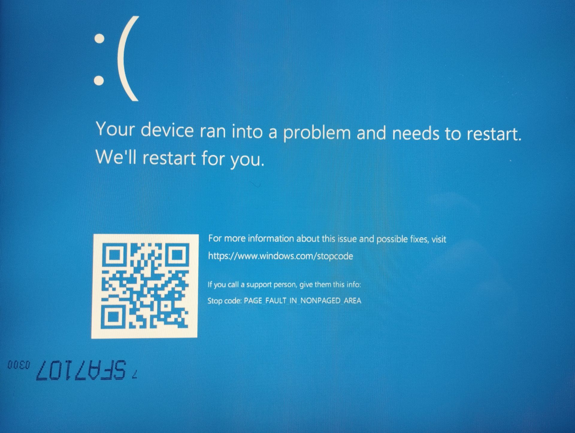

    Hi friends,
    I have a big problem with Lenovo Legion 5 15ach6h, MB Hy660 (661 ...) NM-D562 Rev 2.0.
    Originally, the defective EDP cable found, also a defective LCD panel. After the replacement, the image goes to the BIOS, but it is not possible to boot the system, or install the system, always falls, or restarts directly. Occasionally different BSOD (attached in the attachment).
    So far tested:
    - RAM exchange
    - disconnecting all peripherals
    - Disconnect the battery
    - I have another with a different defect, so the swap of KBC
    - Another nvme disk, test in the second M.2
    No change.
    Any suggestion, what else to try, or where could there be a problem?

      it can be dead soc or gfx, just for make sure check all caps filter on gpu & gfx core. I got problem like yours before on ROG and Legion, First i assume dead gfx before i found culprit caps on gpu core fet

        Very likely SOC fault

          Thanks for the answers.
          So GPU or SOC is not very good news, both are very hard to find and very expensive
          I would need to be sure which one is faulty, but the GPU probably won't turn off so I can only test with the Vega chip.
          In addition, a different solder is used on this board, apparently it melts at a much higher temperature than the usual PB free. Or is it only very difficult with Kingbo RMA 218 flux?

            Yes, the solder is very difficult to melt on many gaming motherboards. I beleive its SOC or corrosion somewhere in S0 rails.
