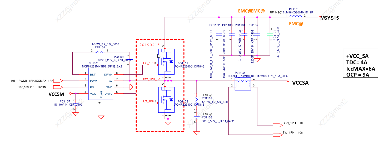

    Hello Badcaps, got a Lenovo Thinkpad E15 G1 Gen 1 NM-C421 with a short i've found on a mosfet. When plugging the USB-C meter, it cycles 20V-off-20v-off. On mosfet PQ1102 i see a short a 12ohm to gnd resistance. Removed the mosfet, measuring on the board gives same result. Checking on a previous post i saw this schematic picture, but not sure if what i'm seeing is normal and what would be the proper tests to do from here. Not an expert by any means by trying to learn. Thanks

    Resistance is ok for VCCSA rail. Problem lies elsewhere.
