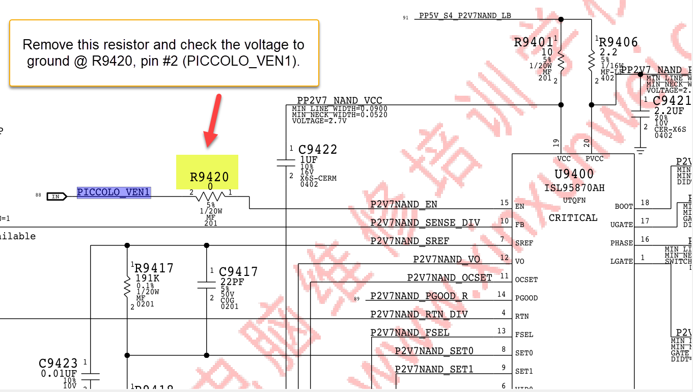

    #41
    Re: MacBook Pro A1706 820-00239 no power
    Remove all power. Meter in resistance mode.
    What is the resistance to ground of PICCOLO_VEN1 ?
    We want to confirm that an excessive load on this signal line is not pulling down the enable voltage.
    After this check, consider to remove with care, the 0 ohm resistor @ R9420.
    Then power up again and check the voltage @ R9420, pin # 2 to ground.
    Do you have a valid EN voltage now ?
    Use ample flux + low air pressure and enough hot air temp to remove the part. Do not lose the part but if lost, you can bridge it later with a blob of solder.

      #42
      PICCOLO_VEN1 to GND = 1.680M oHms
      Then power up again and check the voltage @ R9420, pin # 2 to ground. = 0.020
      Do you have a valid EN voltage now ? = I am not sure what is the valid voltage but I got 0.020
      Use ample flux + low air pressure and enough hot air temp to remove the part. Do not lose the part but if lost, you can bridge it later with a blob of solder. = I manage to remove it without losing it. Max temp @ lowest air.

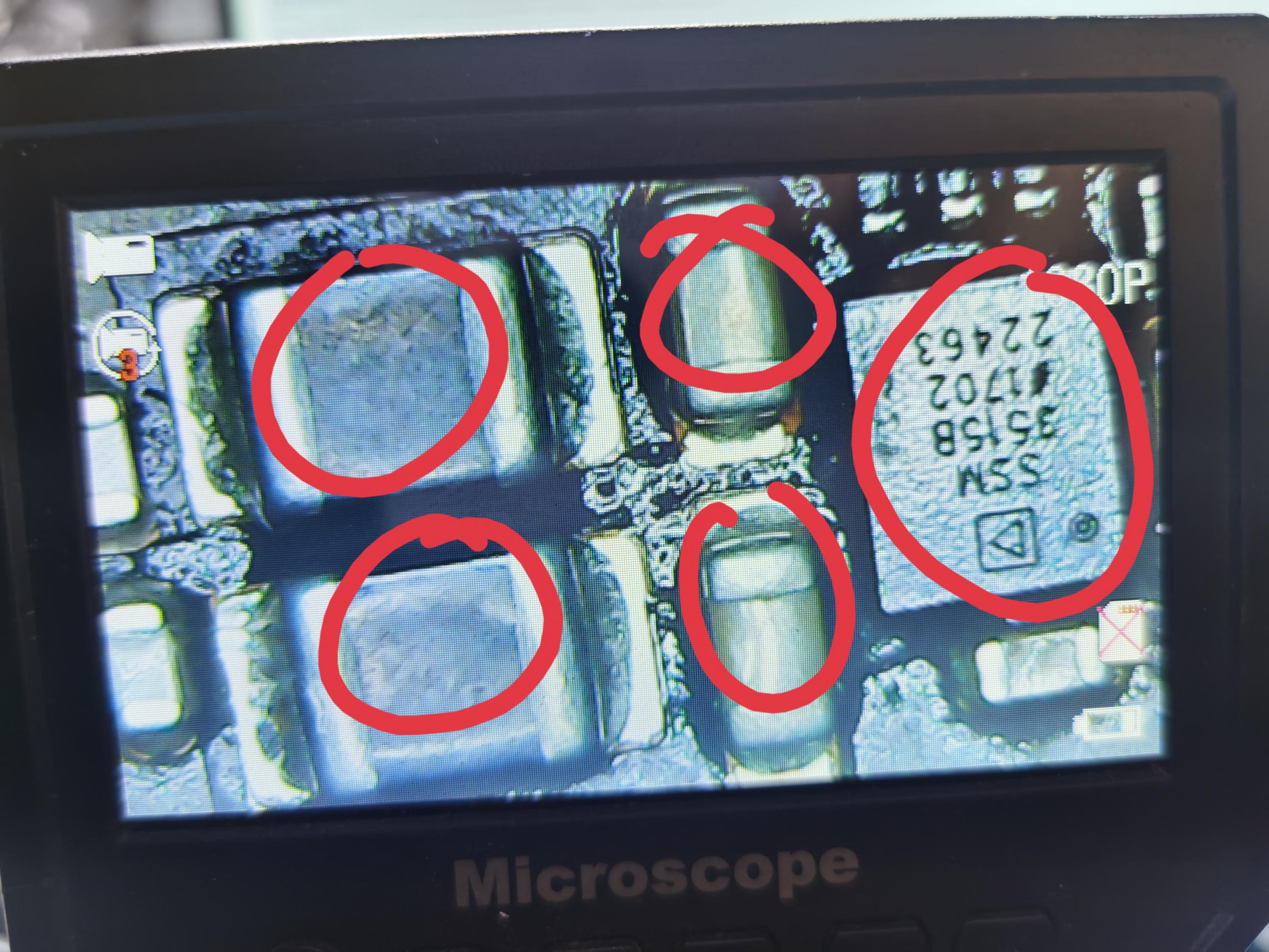

                #47
                Originally posted by mon2
                Remove F7000 again.
                Inject 1 volt (not higher) again onto the fuse pad that shows the short. Increase the current a bit if required.
                Monitor who heats up. Does the regulator you have worked on heat up? Do also monitor the output side mosfets present on the same voltage rail.
                If still not found, check the resistance to ground of each large coil / inductor. Note any very low resistance readings.
                I found five more components heating up on the same setup. Aside from the U9400 which was initially detected heating up during voltage injection, there are five more parts that are heating up as well not that hot but the alcohol on top of them dried faster than other components and it is warm to the touch.
                Components are : FL6500, FL6501, C6506, C6507 and U6500
                Please see following image.

                      #50
                      I switch from using alcohol to rosin it clearly shows what is heating up. It is one of the capacitors near U9400 the C5910
                      • Xenoaeuriix
                        • Dec 2022
                        • 36
                        • Philippines

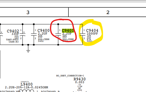

                        Sorry the capacitor is C9401
                        • Xenoaeuriix
                          • Dec 2022
                          • 36
                          • Philippines
                          #52
                          I see that this is connected in parallel to the other capacitor that I knock out while trying to re-attach the fuse F7000
                          The red circle is what's heating up while the yellow is the one I knocked out.

                            #53
                            Good. With flux and low air pressure, carefully remove this capacitor. After the part is off the board, allow it to cool and measure the resistance of this removed capacitor.
                            One meter lead on each side of the cap while it is on your work table.
                            Confirm again the resistance to ground of PPBUS_G3H with this cap off the logic board.
                            Do you still have a short?
                            The lost cap will not be missed. It is not critical to the operation of this logic board. Different cap values filter out different noise.

                              #54
                              Doing it now, by the way U9400 is not actually heating ut at all, I just thought it is because I got burnt while touching it but it is because the capacitor that is heating up is too close to it.
                              • Xenoaeuriix
                                • Dec 2022
                                • 36
                                • Philippines
                                #55
                                = The reading is 000.0 ohms
                                Confirm again the resistance to the ground of PPBUS_G3H with this cap off the logic board.
                                = short now is gone for the ppbus_g3h value keeps on changing start with 1.000M oHms and keeps going down to 0.786M oHms so I stop there. Should I wait for the reading to stop?
