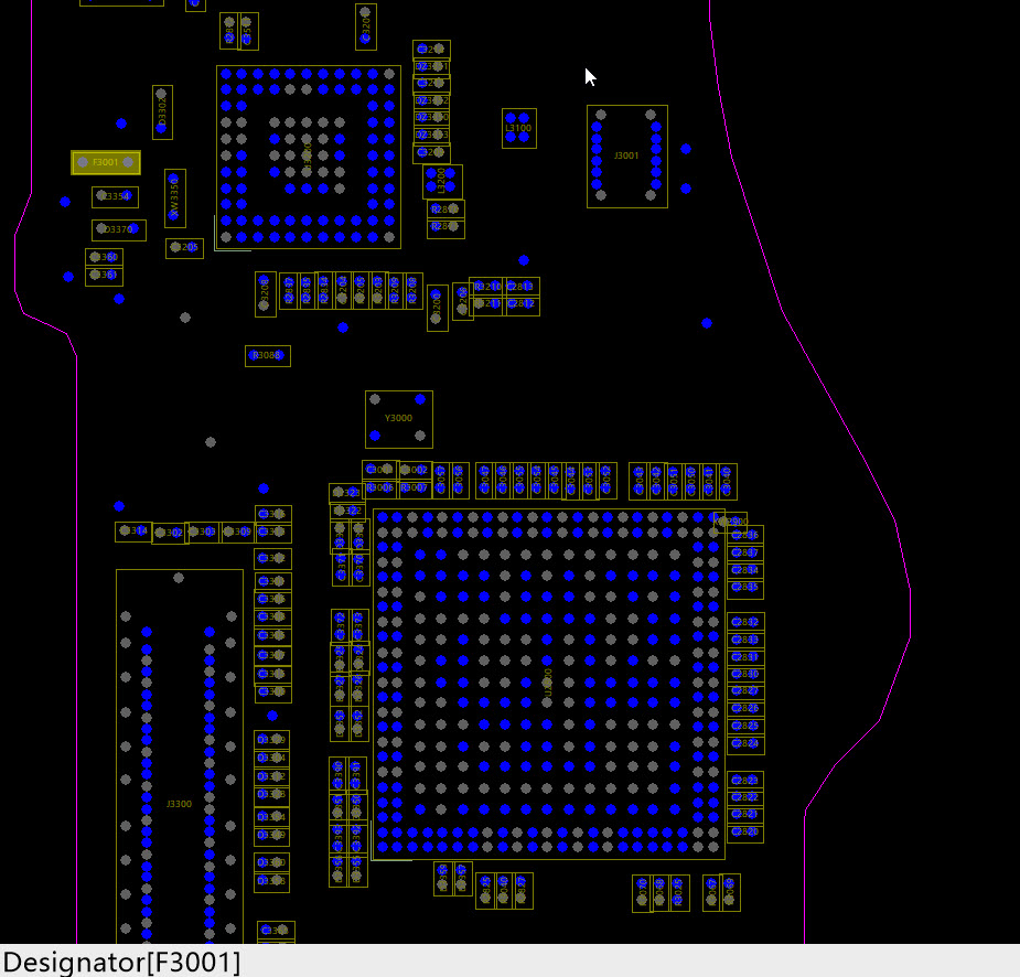

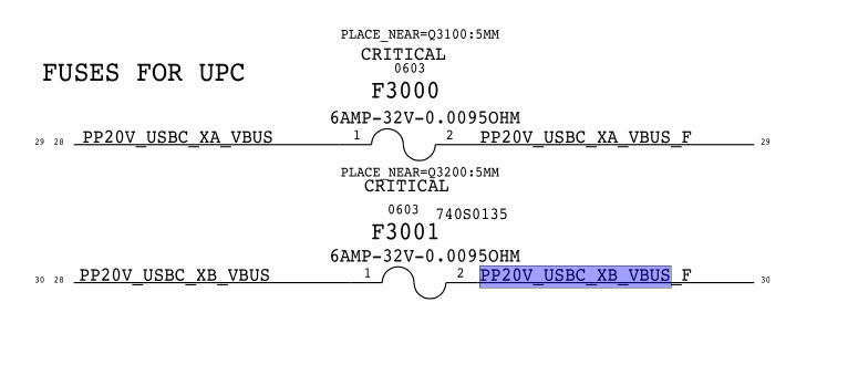

      On the case you noted with no power, check the local fuse for each such Type C connector.
      U3100 and U3200 are the Type C controllers (ACE Pri / Secondary)
      Check fuses @ F3000 and F3001 and report the voltages on both ends of each fuse. Alternatively, power down and place meter in resistance mode.
      Check the resistance of the above fuses to check if either one is blown.

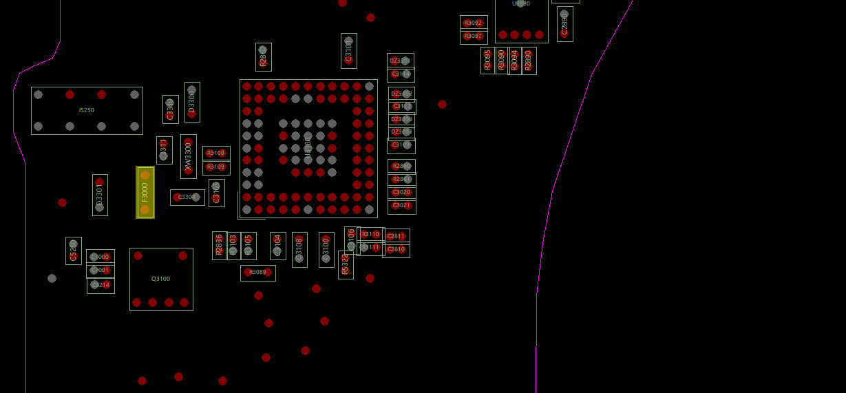

                      Ok. PPBUS_G3H is not working but you have the proper PPDCIN_G3H rail going into the U7000 circuit.
                      Remove all power. Meter in resistance mode (2k should be ok).
                      Red meter probe on F7000, pin # 2. Black meter probe to ground.
                      What is the reading ?
                      Is the F7000 fuse still in tact and conducting between pins 1 & 2 ?
