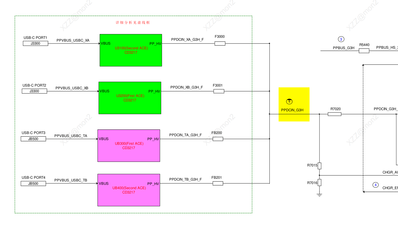

    I got a 16inch MacBook Pro showing 5v and 0,3a on the left ports and right side has one power cycling and one showing nothing. The one cycling shows 30c under thermal camera. Surrounding components show no corrosion or any shorts.
    Any ideas what to check next? The whole board looks clean compared to the other A2141s i saw.
  • mon2
    • Dec 2019
    • 14667
    See attached. You are at the power sequence #1 stage.
    Remove all power. What is the resistance to ground of PPDCIN_G3H? Issue is most likely with one or more of the CD3217 PD controllers.
      Resistance to ground is 955 Ohm.

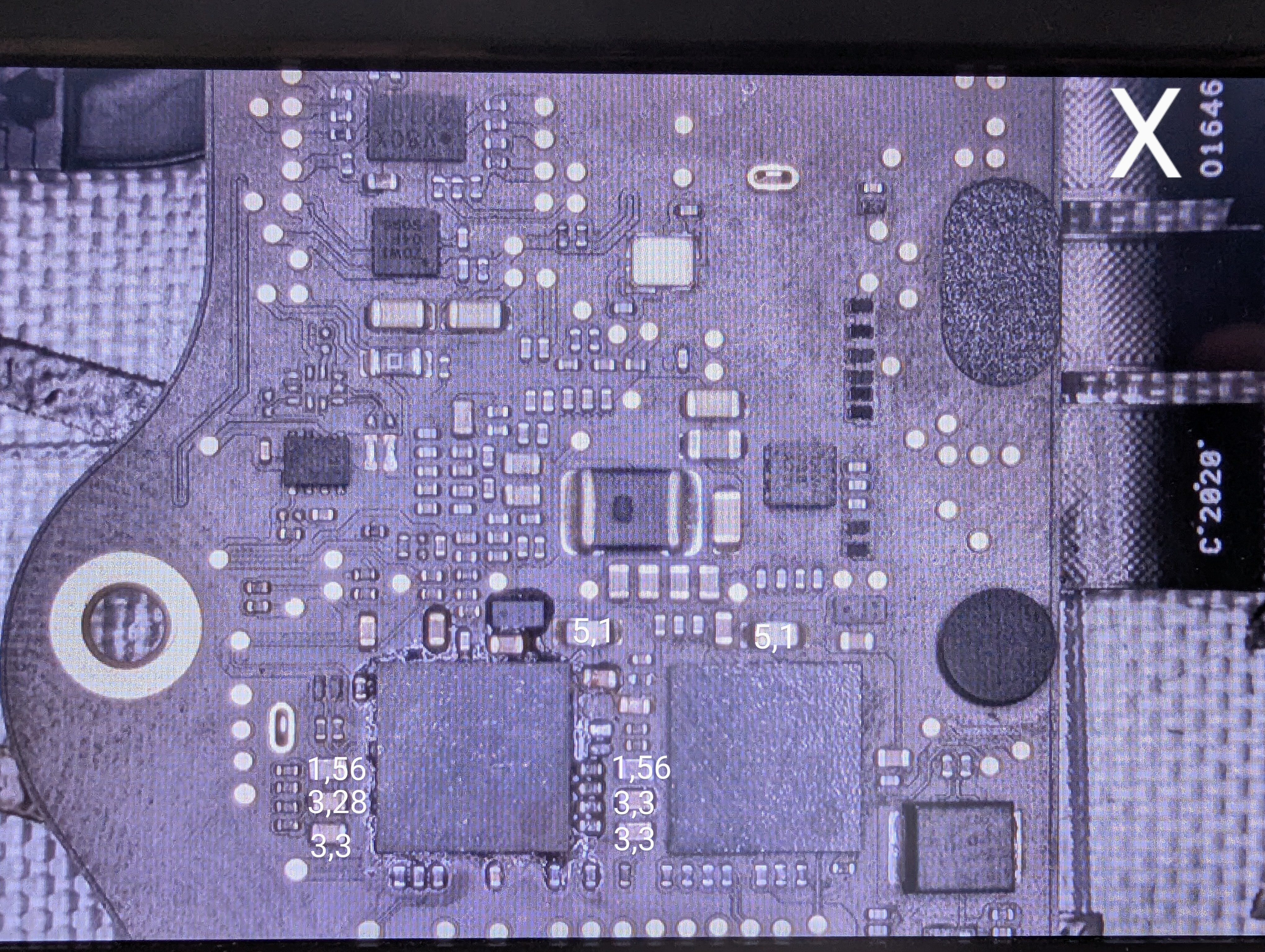

                    Sorry was busy the last days. Cap and everything around is fine and somehow my 5v port is now dead again and all others show 5v.
                    The one marked with X isn't showing anything right now. I added values i got when connecting power to the other port.
                    Can this all be the problem of a faulty UB300 or do i have to look anywhere else?

                      I reballed UB300 to see if it changes anything and all values look fine besides CB308 being at 30 Ohm.
                      But testing was not possible. Port for UB300 still shows nothing with USB tester connected (dead) and port for UB400 just flashes for a second and turns of and on again in a loop. Never had the situation where the port was "dead" so any ideas what to check or can this also be the case when UB300 needs to be replaced?

                            CB304 1,5V
                            CB300 3,4V
                            I took SPI flash out and got 0,90V on pin 5+6 and every other pin 3,3V besides pin 4 GND 0V. With SPI flash back on board i got 0,40v on 5+6 and all others showed 0V.
