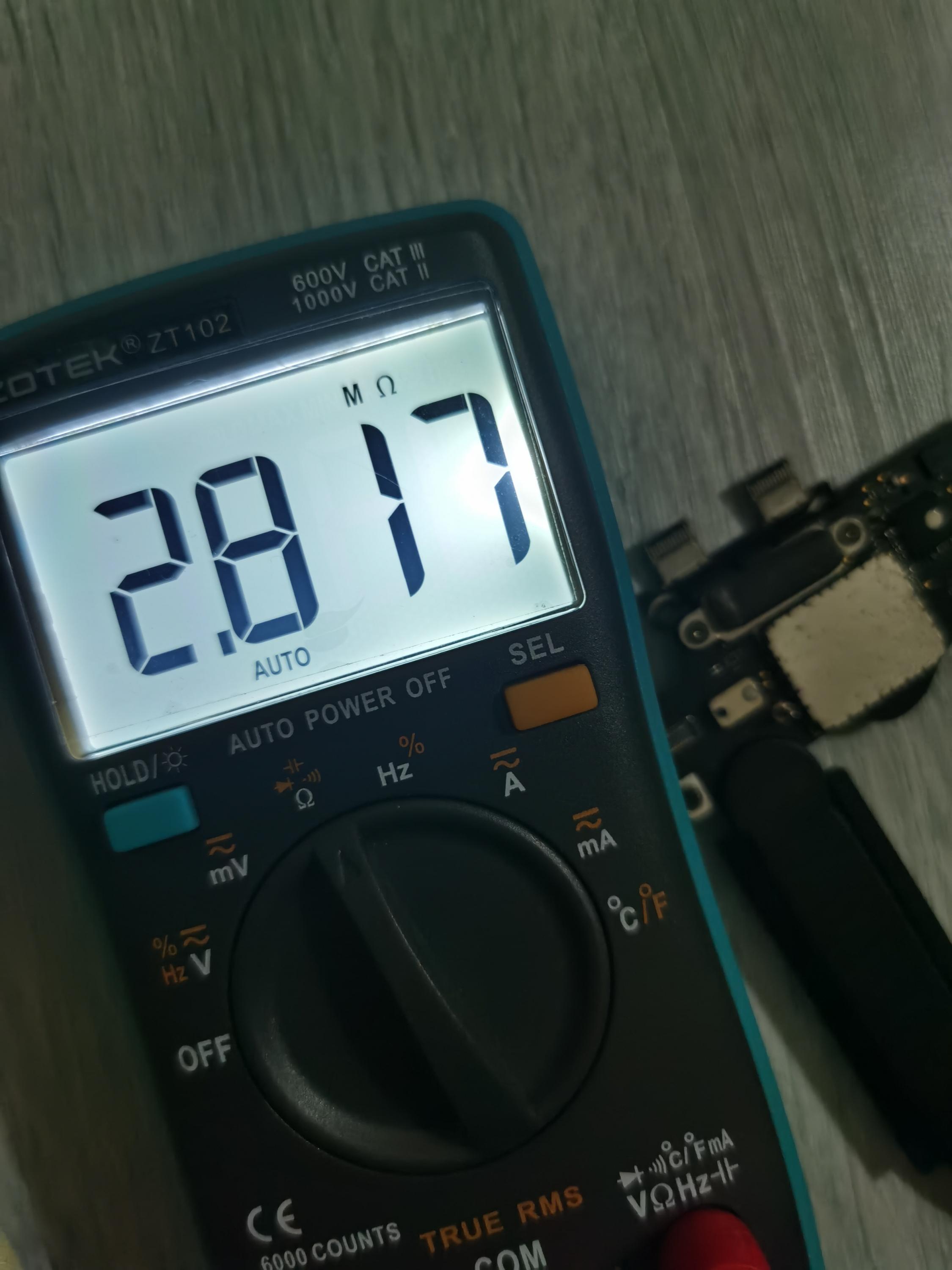

      Pin #1 to ground around 17-18K oHms Red probe to the ground
      Pin #1 to ground around 3M oHms Black probe to the ground
      Pin #2 to the ground 000.0 oHms Red probe to the ground
      Pin #2 to the ground 000.0 oHms Black probe to the ground
      Multimeter auto-ranging for the resistance I am using Zotek ZT102

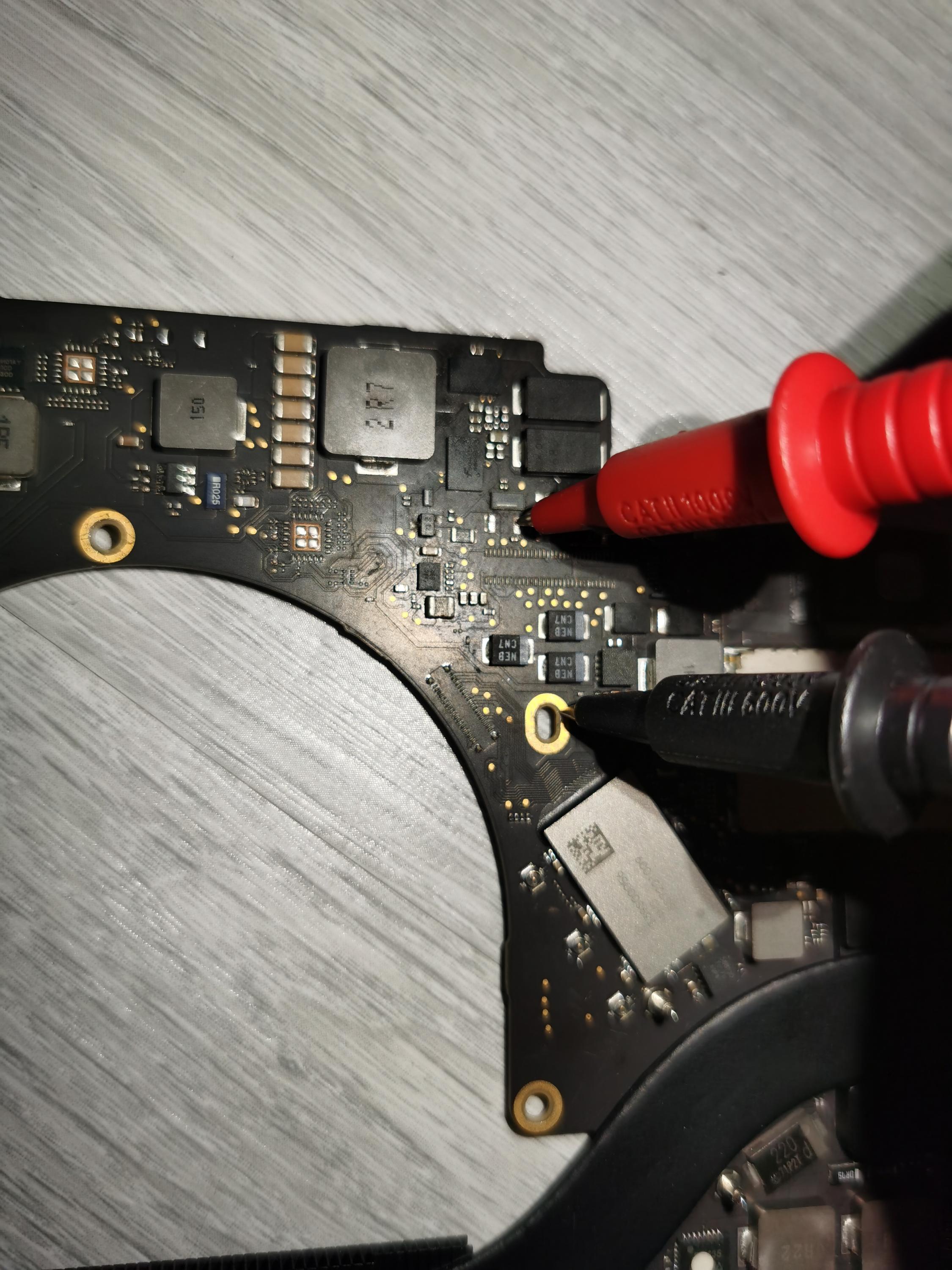

          Red probe to pin #1 of the F7000 fuse pad. Black meter probe to ground (metal shield is ok) on the logic board.
          Repeat with pin # 2 of the F7000 fuse pad. Black meter probe to ground.

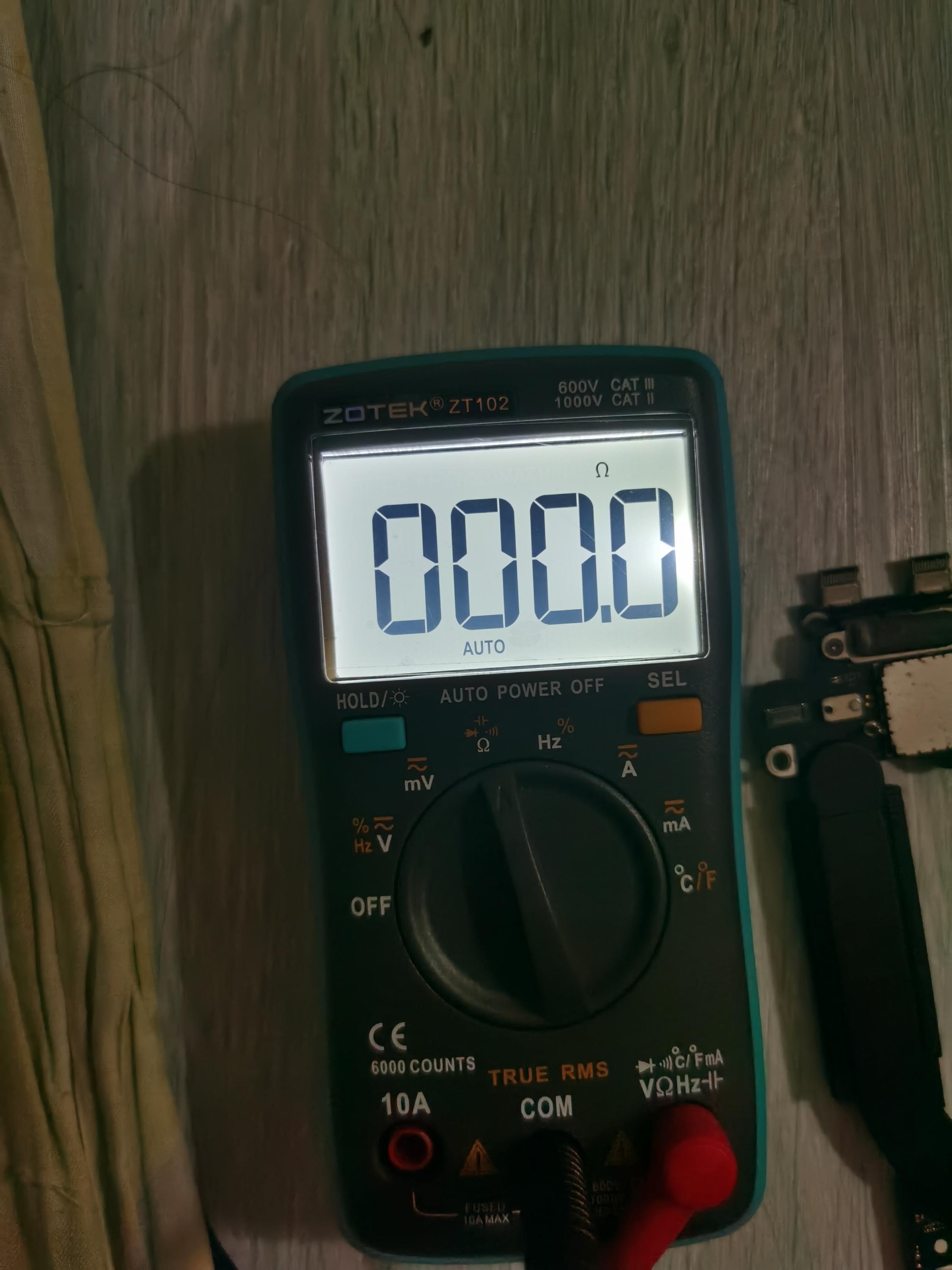

          do you still read 0 ohms on pin #2 or is it 'OL' as in the posted picture? 'OL' = over limit.
          If you short the meter probes to each other, the resistance should be ~0 ohms. Is that the same reading you are measuring with pin #2 and ground ? That is a hard short circuit if my understanding is correct.
              • Xenoaeuriix

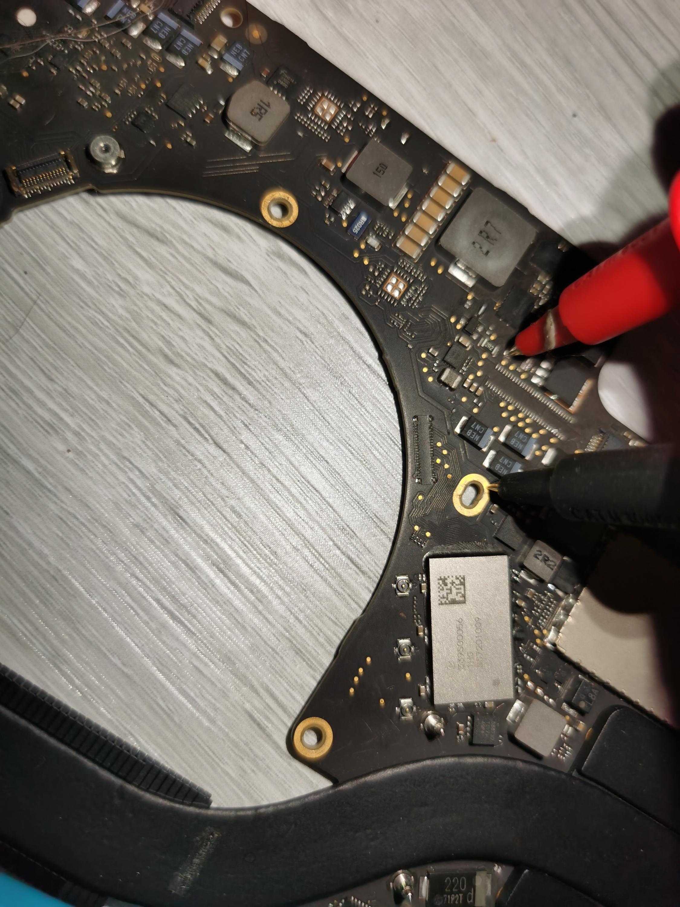

                # It changed form OL to 000.0
                # Yes it is the same reading like I am shorting both probes.

                  Here are how it looks on my end.

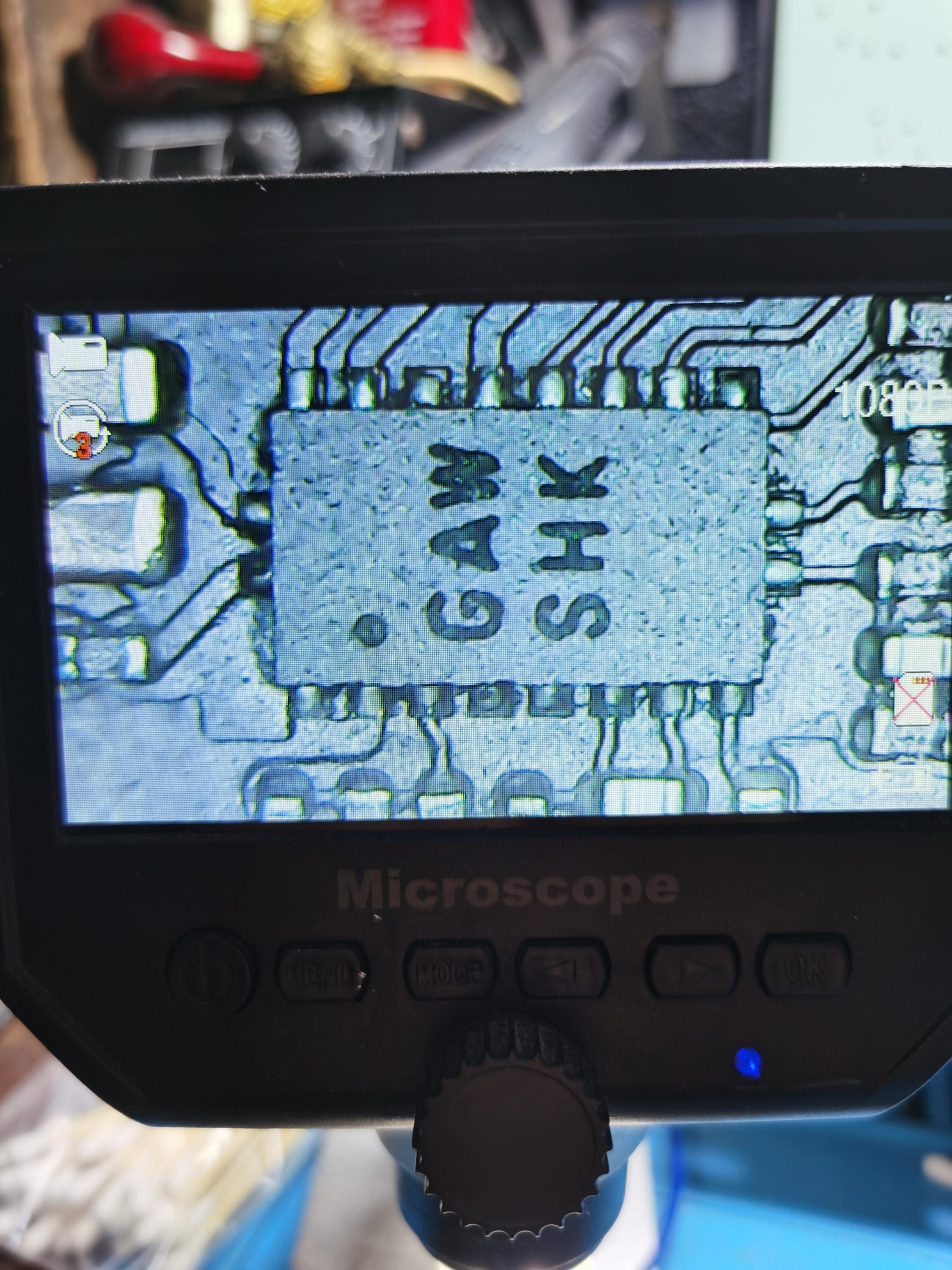

                            I did try to inject voltage 1V 2.4A to ppbus_g3h and found a component that is heating up to the point that I cannot touch too long or it may burn my skin. I did try to find other components cannot find others that is as hot as that component. I am uploading the image now.

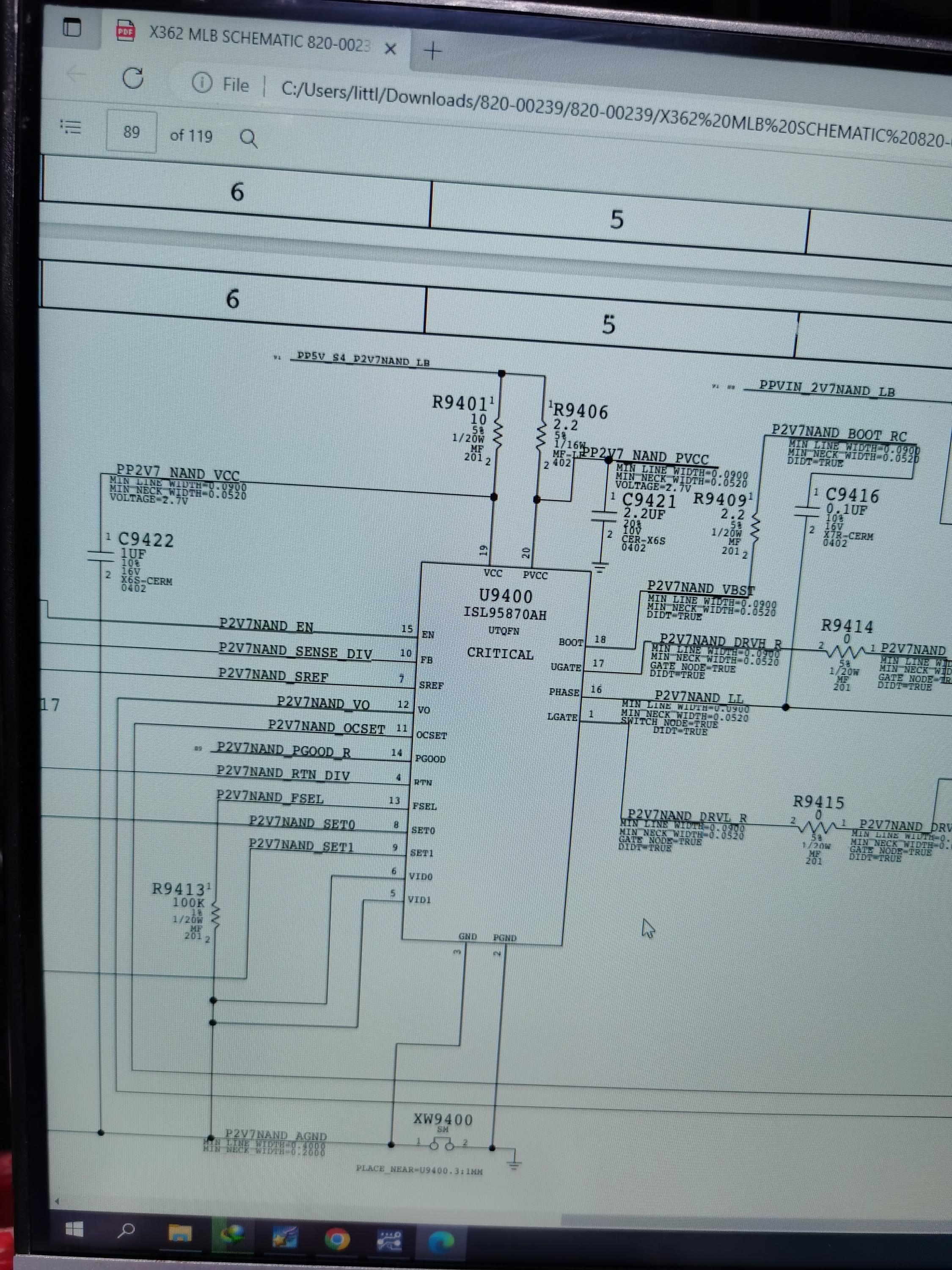

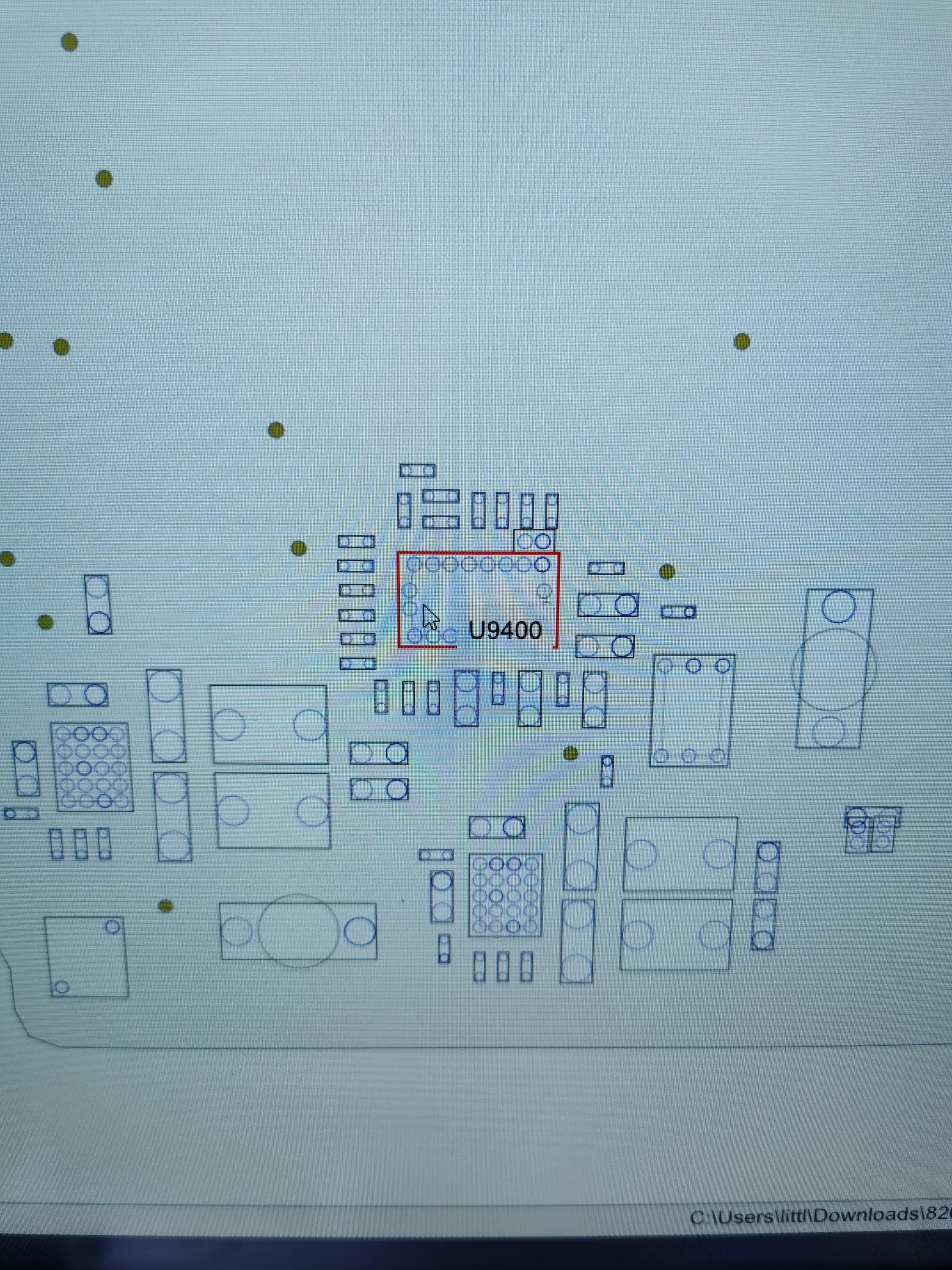

                                Here is the component I am talking about.
                                • mon2
                                  • Dec 2019
                                  • 14664
                                  #36
                                  Re: MacBook Pro A1706 820-00239 no power
                                  Ok. That is U9400 and this linked to the nand flash.

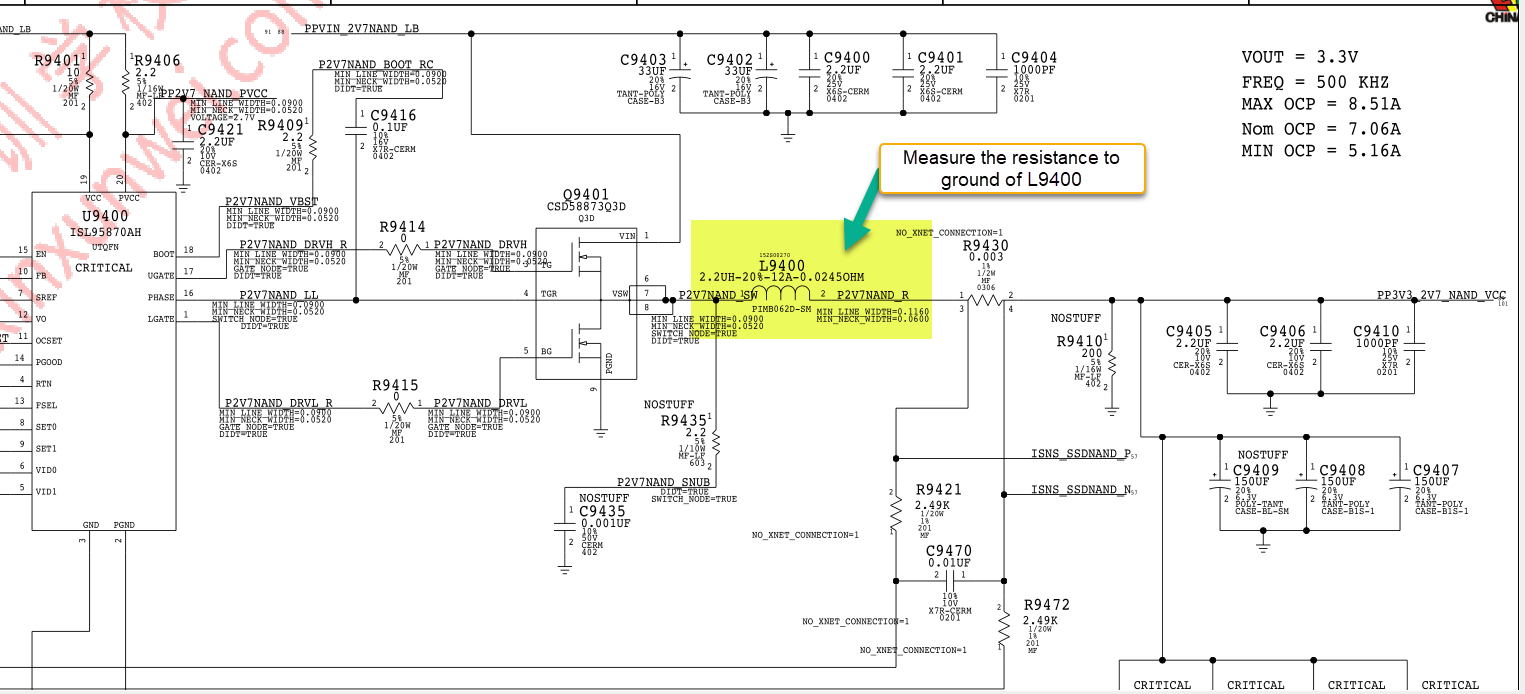

                                  Remove all power -> meter in resistance mode.
                                  Measure the resistance to ground @ L9400 which is the switching power supply inductor for this power rail.
                                  What is the reading?

                                    #37
                                    Pin# 1 is 11.49K oHms
                                    Pin# 2 is 11.49K oHms
                                    it keeps on moving till it stop on that value.
                                        So the output side of this regulator does not appear to be shorted.
                                        What is the voltage to ground of the EN pin ?
                                        We want to confirm that the regulator is being enabled.

                                          Sorry I do not know what EN pin is...
                                          Sorry my bad, could it be the pin # 15 of the U9400. If so I am trying to test it now.
                                          I am getting 0V on the EN pin#15 of U9400 I will try to solder back the fuse it could be because of that..
                                          Got the fuse re attached, but same ready 0V on U9400 Pin# 15
                                          I got 0.040V on the EN pin.
