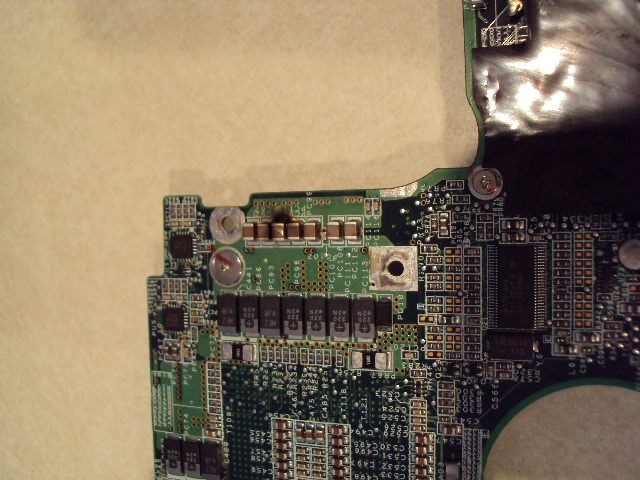

    My youngest got a used laptop about 1 week ago. Last night tragedy struck, her glass of water fell over onto the keyboard. The laptop immediately shut down. So today I pulled the MB looking to give it the usual fix, a wash with 91% isopropyl. I have had excellent results with this in the past. This time it looks bad, one of the ceramics blew out. I have pics but no real way of determining the value of the blown component. Is it likely to be the same value as the other ones in the row ? I have some "donor" boards to get parts, but this is the only 400 series Gateway in the house.
    Any suggestions, or experience with this type of failure ? I am hoping it is just a matter of ice water hitting a hot component and causing it to fail catastrophically, not an overload condition caused by some other component failure.

    Based on the theory that by design, (to facilitate rapid stuffing) many of these caps have the same value, I am now sourcing a duplicate donor board (i.e. cheap,non-functioning ). From it I will extract replacement parts that should logically be same value, but unknown condition. I will attempt to replace the visibly blown cap and reintroduce power. It has NOT been powered up since the "incident".

      Did the ceramic really blow? Or is it just char marks from a short from the water?

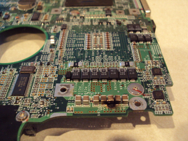

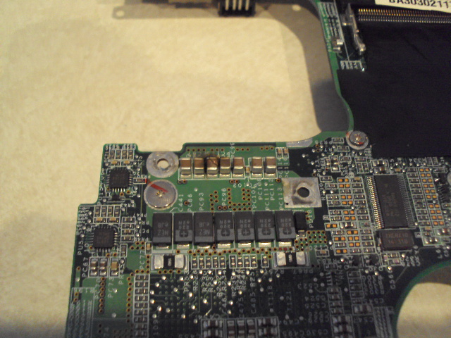

        Oh it is blown for sure, here are 2 more pics. There is a crack right through the body, not sure about neighboring ceramics... I might pull them also when the donor arrives.

          Ah yes the second photo is obvious, though now I can see it in the original photo as well.

              No way to know for sure but if the 4 that are still intact are the same value as each other then odds are better that the fifth is too.

                looks like vrm input from what i can see.desolder the damaged one and see if it fires up.it will run with one missing.

                  I found it because there is a corresponding scorch mark on the inside of the case, not because I have really mad skilz.

                  If it were not for the fact that this possesion is so important to my little one I would probably try your suggestion. I am sure you know what you are talking about. I am however, reluctant for fear that with my luck it could screw something else up. What exactly is the risk of running that (vrm) circuit minus that cap ?
