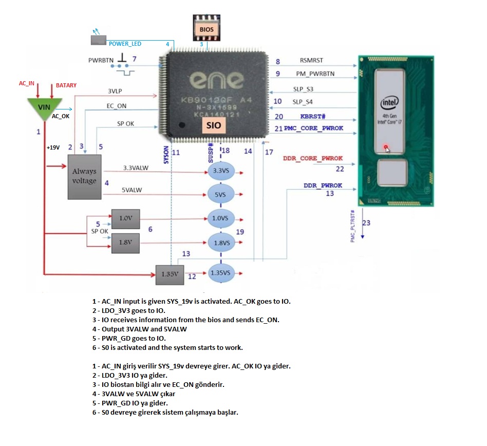

DAG37AMB8D0 very interesting problem
  • simabilisim
    • Mar 2017
    • 17
    • Türkiye
    DAG37AMB8D0 rev: D
    notebook does not start
    There is no 3.3v on the 8th pin of the bios, when I disassembled the bios integrated there was 3.3v. I wrote to another bios integrated, when I plug again, there is no voltage on the 8th leg. I deleted the software in the bios, reconnected it to the motherboard, there is 3.3v when there is no software.

    Re: DAG37AMB8D0 very interesting problem
    can you post your scheme. some notebooks have dual bios. EC and MAIN. main biosa can be active after start.
        Let's start over. Are the DC_IN entry mosfets intact? Does the charge control chip send 3v to the 97 pin of the IO chip? Are there ENBL and PWGD signals on Pu2001 pins 1 and 2?
          DC_IN mosfets OK
          IO chip 97 at 3v OK
          PU2001 EN and PWGD no signal
          Interestingly at PU2002 no signal EN and PWGD but 5v LDO OK
            PU2001 EN signal is OK when I remove the bios IC
            S5_ON signal is output on IO chip pin 100 when I remove the bios
            but PU2001 PWGD no signal
              In the scheme, when 3VLDO goes to IO, the power LED and EC_ON signal come to PU2001 with familiar information (AC_OK signal) from bios. ALW voltages are output. follow to steps
              When S5_ON signal is output, does 3VALW come out from PU2001, 5VALW?
