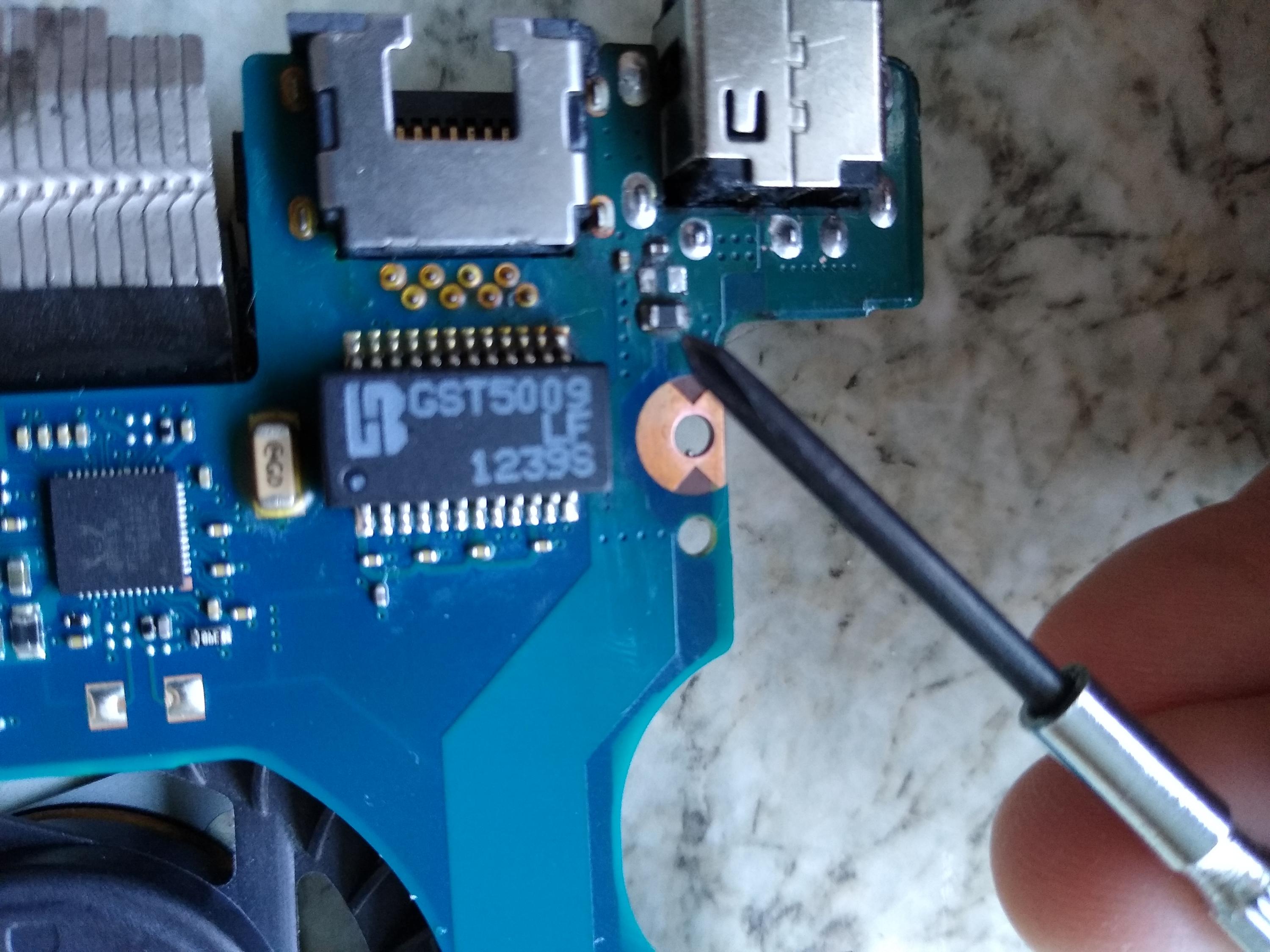

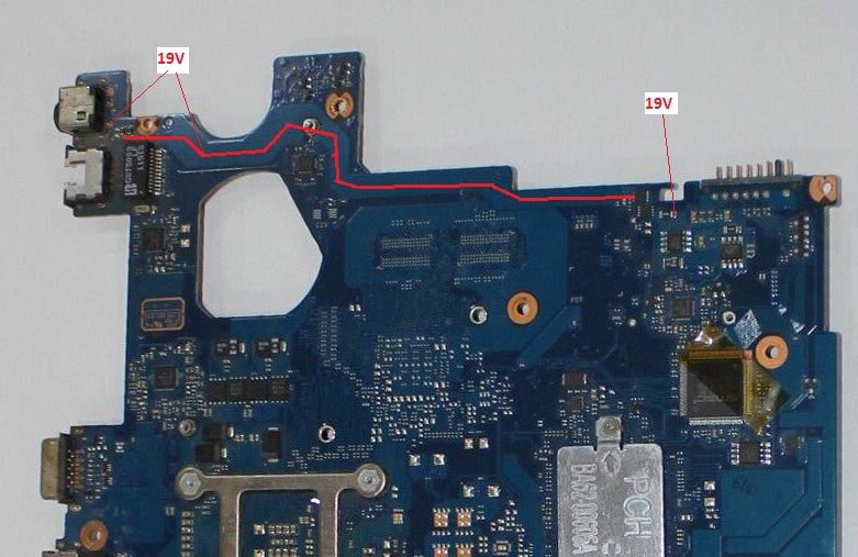

    Hi, I need to replace a smd coil/ inverter on my Samsung laptop motherboard but I cant find any information on the schematic diagram for it, it just shows a curly wire symbol without any identification, they are small black rectangles with silver ends, they sit directly after the DC jack so 19/20v and when I check the resistance on the good one it measures a very low ohm reading just like you would get from measuring a small piece of wire, I'm not sure if they are used as a kind of fuse? I need to order one but I'm completely lost to what type and where to get one from, cheers.

    It's measuring correctly, they fail and go open. Why do you need to replace it ?

      If you measure 19v from the adapter input to 0.1 ohm resistance, there is no problem with the coil. you can solder the coil directly.

        Hi the coil failed and went open circuit, the one next to it is okay, there is normally two next to eachother but in my picture the failed one has been removed, I just need to find a replacement for the failed one .... cheers.

          its just 19V filter. u can jump it

            Hi, I'd rather replace it if possible, I've found the part number its HU-1M2012-121JT can anyone recommend a good place to get components from?

                Hi I've had a look at the link, I think he eventually just soldered two fuses in place, I've found these inductors and they are the closest I can find just with a higher max amperage 5 amps instead of 4.2 amps and the DC resistance is a bit different, I think these will be okay, what do you think? Thanks.
