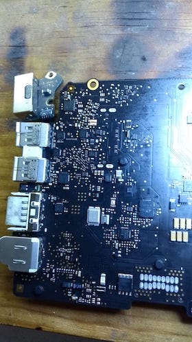

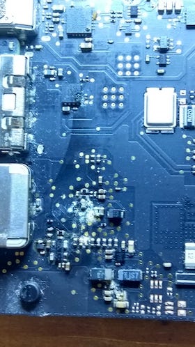

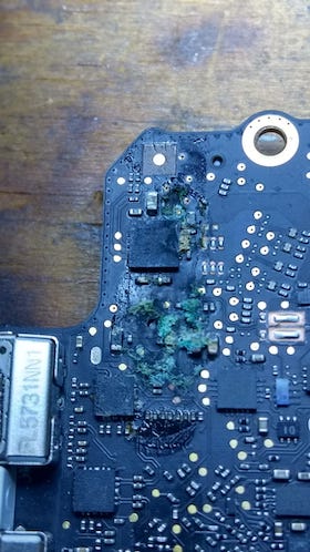

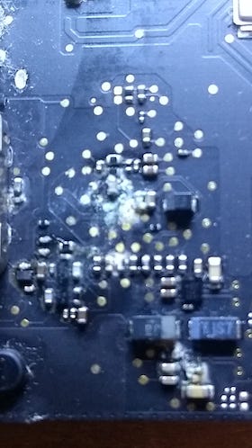

    i've got this macbook with liquid damage, you can see it in the pictures.
    i cleaned out of the wet zone.
    The mac turns on and works well, but I see the fan doesn't turn on.
    I put in a new fan, the failure persists
    I have the signals of 3.3v and 5 v, but I don't have SMC_FAN_0_CTL
    The question is, what signs should be present for the generation of SMC_FAN_0_CTL?
    Thank you for your time and your answer
