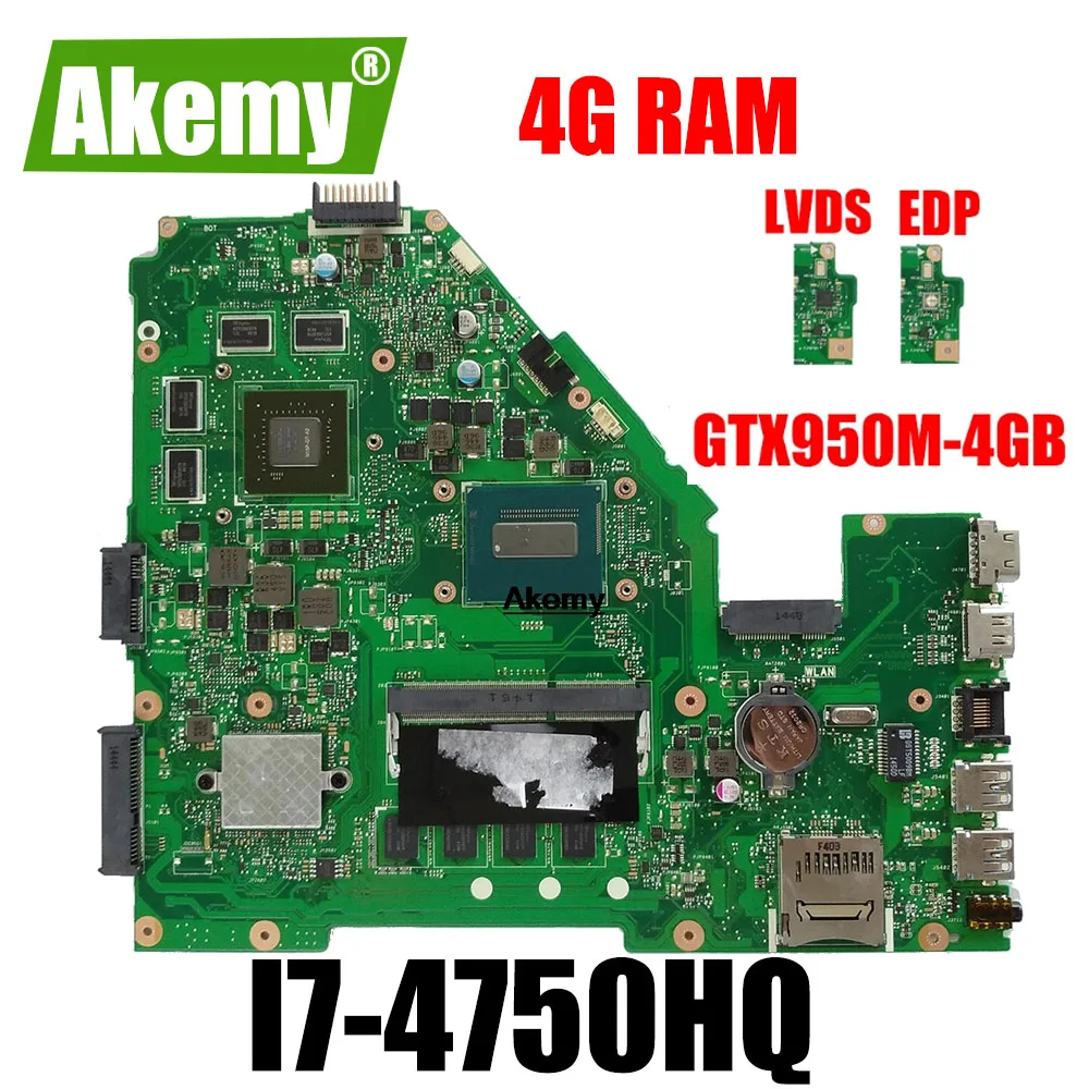

                          - Yes the oscilloscope arrived. I will check for ripples...
                          - Ok will check for 3.3 with jumper wire.
                          - 1.2vs can't be missing I think because my board is "type LDP" (link below) and does not have 1.2vs eletronics at all.
                          https://ae01.alicdn.com/kf/Hb447dceb...cM.jpg_q90.jpg
                          - Another idea: Can it be that I have flashed a "Type LVDS" BIOS and motherboard does not power on because it lacks 1.2vs?
