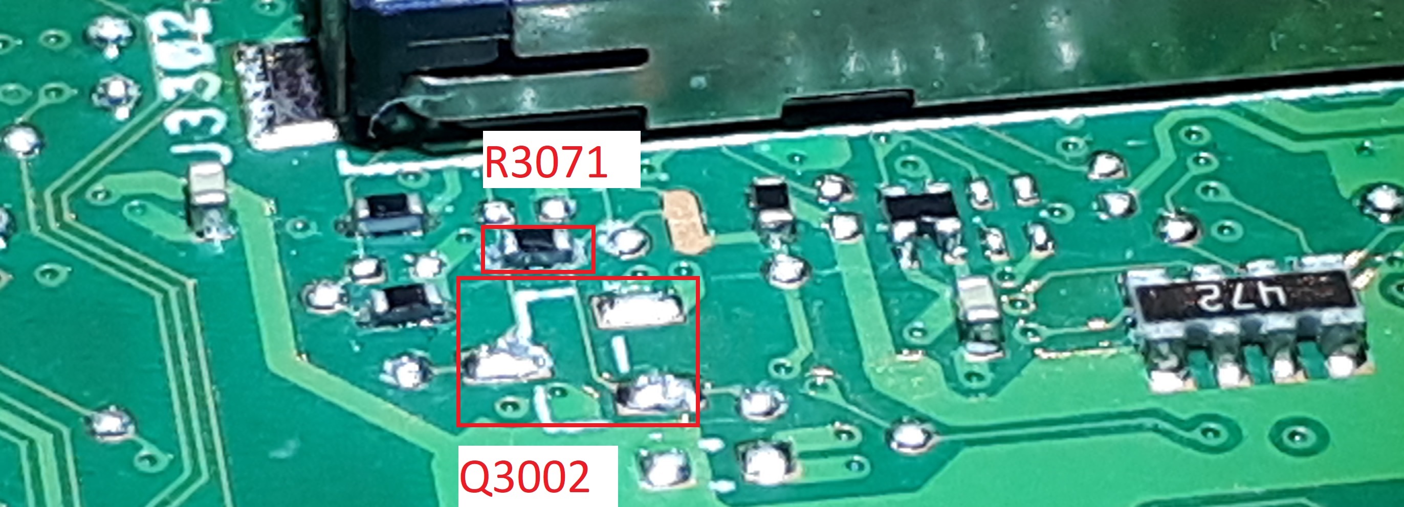

      You have board view
      Check this signal suspwrdnack is connected to which capacitor or which nodes
      Take snapshot and post

        #43
        Re: X550jx black screen but cpu heating up
        Originally posted by stingerchamp
        You have board view
        in this board suspwrdnack is actualy just connect KBC to PCH nothing fancy.
        suspwrdnack also connects to +3VSUS_ORG (measured 3v) and connected through a 10kOhm resistor.
                  Q3002 does not exist,
                  "ME SUSPWRDNACK" and "ME SUSPWRDNACK EC" is just connected trough R3071 and its a 0 Ohm resistor.
                  I will check what you suggested and get back.

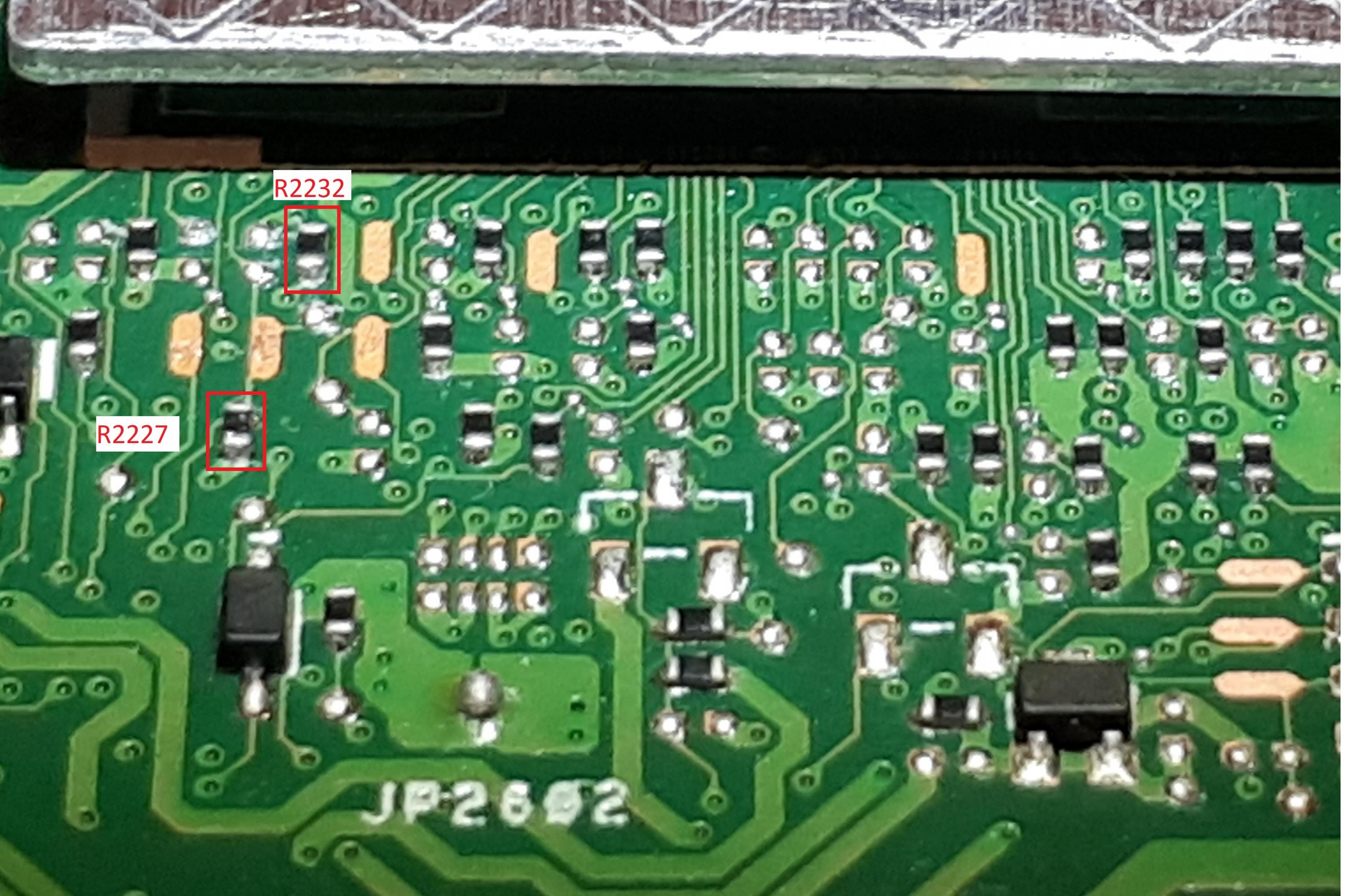

                              #54
                              PCH_SUSACK# is connected to PM_SUSACK through R2232
                              Unfortunatelly nor the schematic nor the Boardview is perfect for this model.
                              This is a minimalistic board and most of the components are missing and just connected trough direct 0Ohm resistors.
                              I'll try to make a good picture with high quality to make you a good baseline of this board.
                              I have no idea why ME_SusPwrDnAck goes down after 3.3v it does not makes sense to me. Its directly goes to KBC chip.
                              I have checked and its 0Ohm all the way through from chip to chip. No short to ground.

                                #55
                                Q3002 missing and jumpered trough 0 Ohm resistor R3071 see picture1: SUSPWRDNACK_pic.jpg (516.9 KB).
                                R3071 pins
                                1 ME_SUSPWRDNACK
                                2 ME_SUSPWRDNACK_EC
                                Made picture of PCH_Susack area balow PCH to make you see how minimalistic this board is PCH_pic.jpg (533.0 KB)
