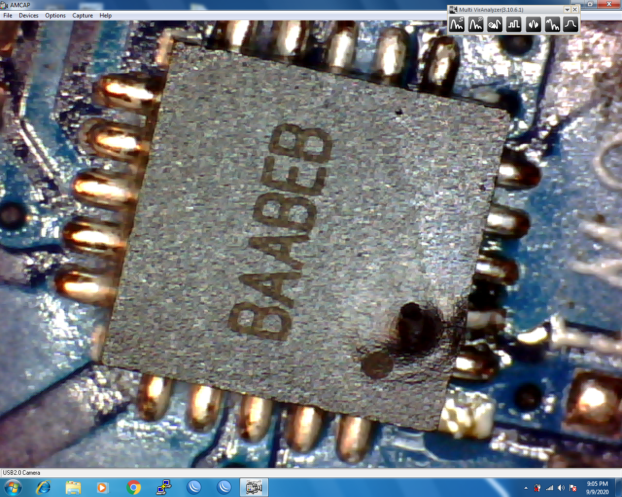

    Guys i need help to identifing burned regulator IC BAABEB

    The last few digits are usually a date/batch code , BAAxxx SY8286RAC i think .EDIT: i`m not 100% sure its the correct part number .

      Re: help identifing burned regulator IC BAABEB
      I think that is likely it, I see a lot with the similar marking BAA5XA and BAA7NG
        BAA=SY8286RAC. 100% sure about it.
          By the way,the schematic you asked for isn`t available yet.
          Many thanks mate. i found it on spare board BAA7xx
          can u guys share some list with ic markings?
            Search for SMD CODE BOOK, it can help, sometimes, but it is difficult and some mfg's use custom numbers
              There is a list of Silergy ICs marking codes on vlab forums.
