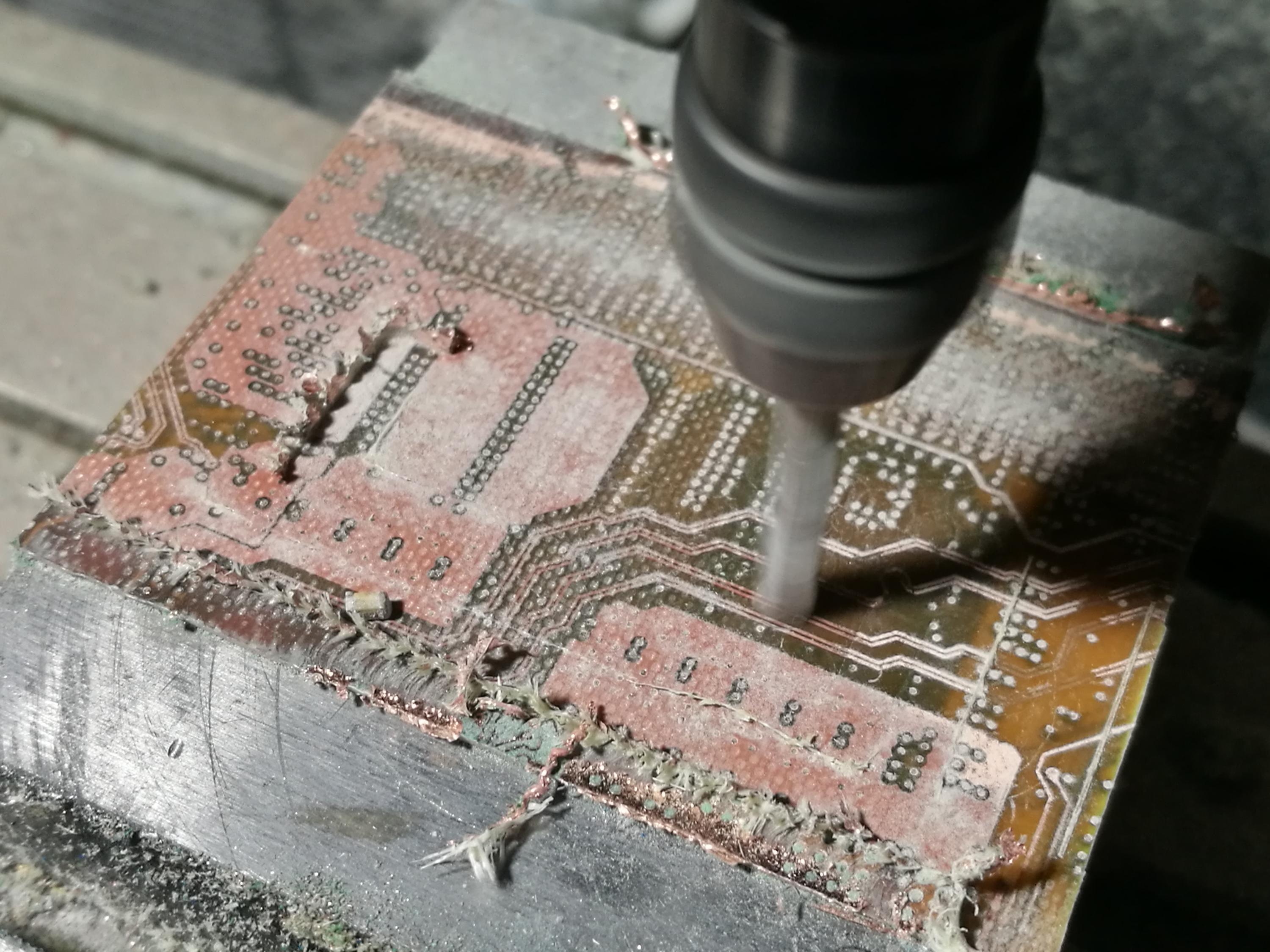

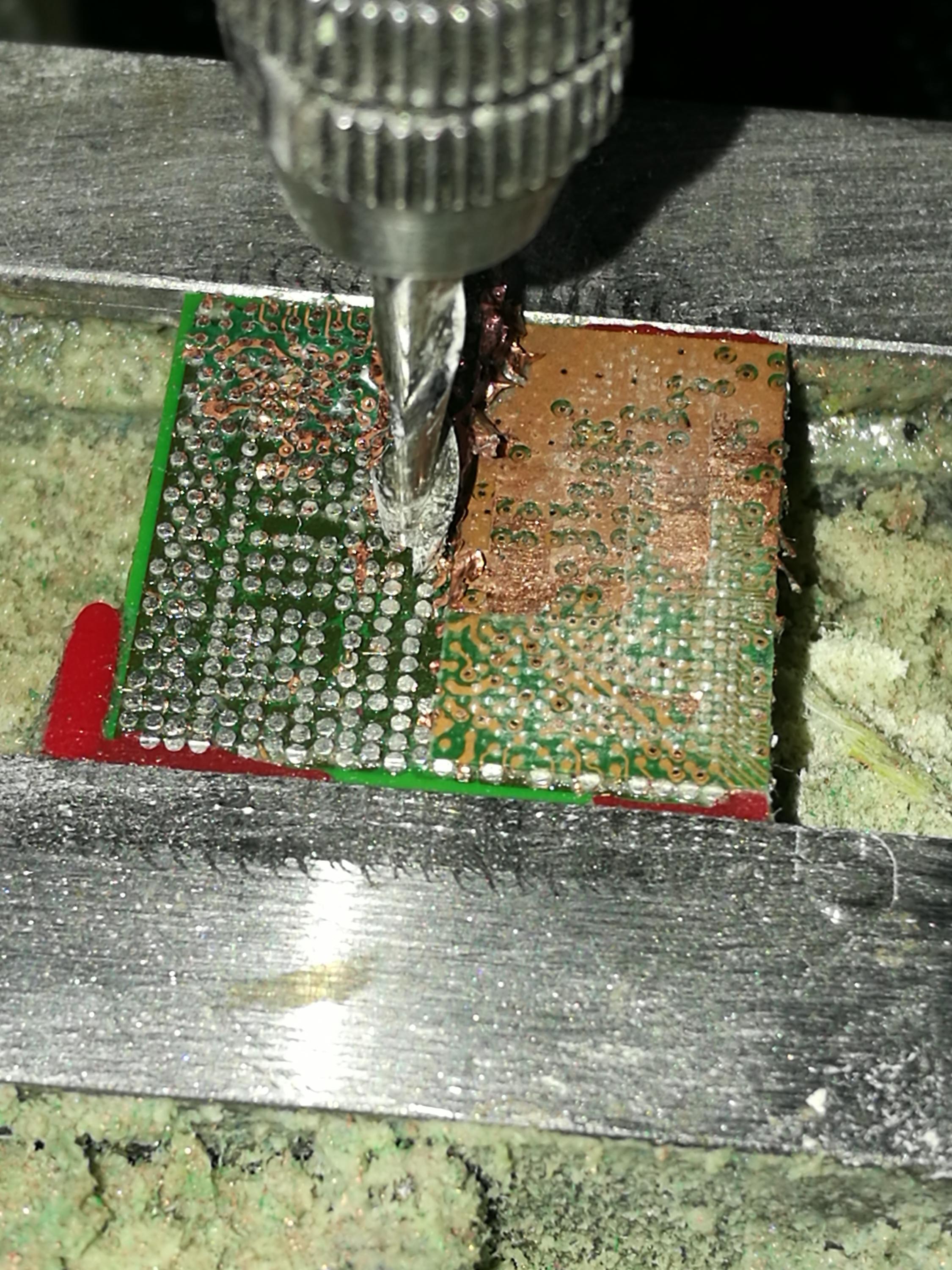

            Personally I use only Bga removed mechanically (with a CNC) from a donor board.
                Curious how you do that.
                Isn't removing a (underfilled) BGA with CNC to preserve the PCB to accept new or donor chips ?
                Destroying the BGA in the process ?
                Don't see why a normally lifted BGA wouldn't be usable again?
                Doing it for years without problems, no need for CNC, reball it and and runs for years again.

                  Re: GPU common problem
                  CNC Is a good method to have a unstressed bga,
                  especially for cpu that has distortion problems. It"s (you do not put the whole board under the CNC but only the area that concerns the chip) has advantages, the chip can be resold because it does not show signs of heat, and if you do a laser reballing the condition Is like new.
                  about the duration of the reflow it's a matter of luck and I can't risk working on the same card twice after the customer has paid a lot for the repair.
