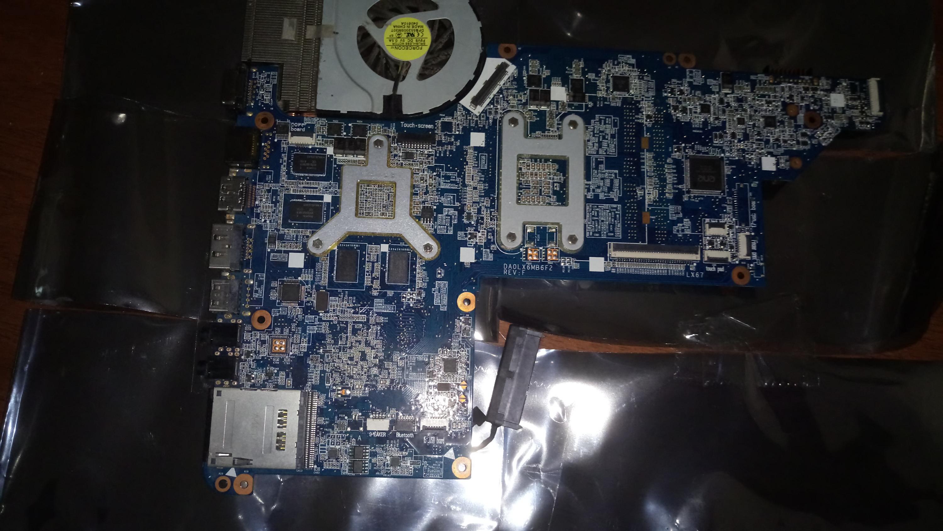

    Dear Members,
    I have issue with HP DV6,
    When I pressed on, Fan and LED run for few seconds and then off,
    What could be the issue? Is it capacitors ?
    I checked some tantalum caps on it, mostly on 12 ohms value / short.
    Anyone has the schematic of this board ?

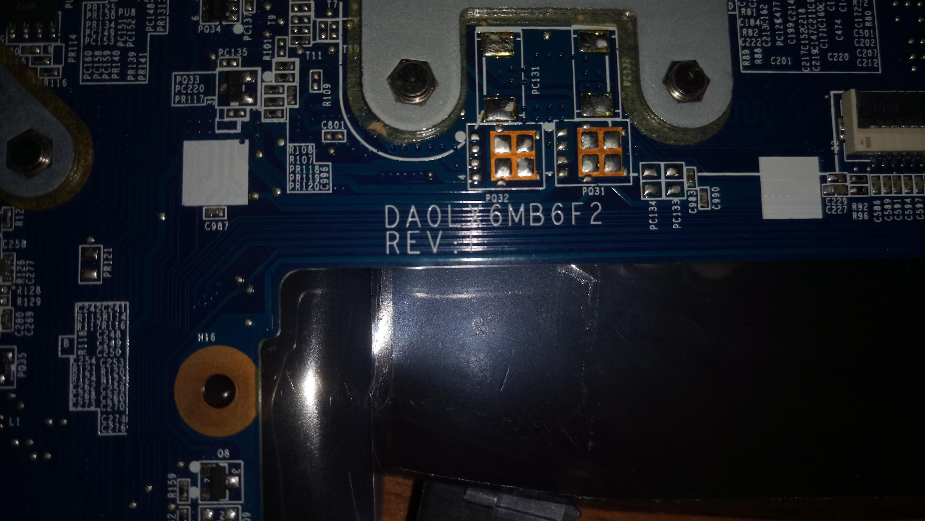

    Re: HP DV6 issue ?
    board code : DA0LX6MB6F2
    REV F

            Could be MOSFET near CPU ? PQ45,PQ51,PQ44,PQ53, since then I measure 330u caps, it's 12 ohms...?
            • bianchi77
              • Jun 2016
              • 1121
              Re: HP DV6 issue ?
              it's FDMS7692
              N-Channel PowerTrench® MOSFET for PQ45,44,51,53

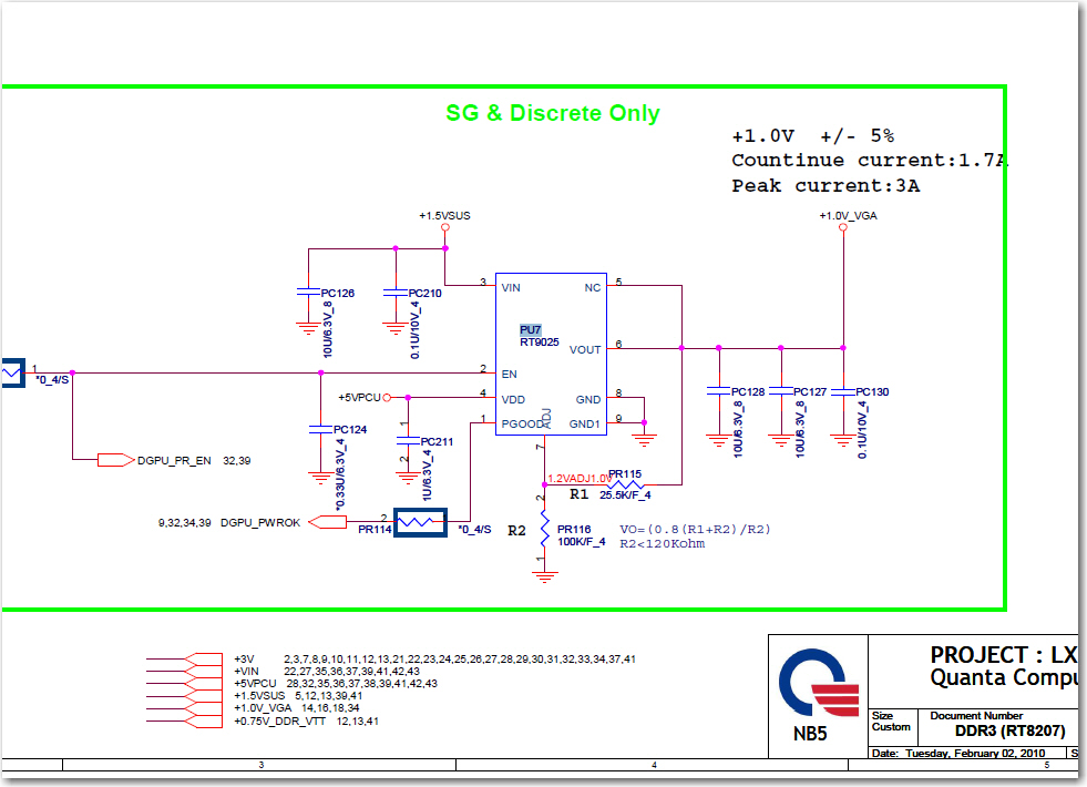

                • bianchi77
                  • Jun 2016
                  • 1121
                  Re: HP DV6 issue ?
                  that U7 ?
                  • mcplslg123
                    • Jun 2015
                    • 7262
                    • india
                    Re: HP DV6 issue ?
                    Originally posted by bianchi77
                    that U7 ?
                    No, that's PU7. U7 is KB3926QF-your sio on this mb. Schematic pg32

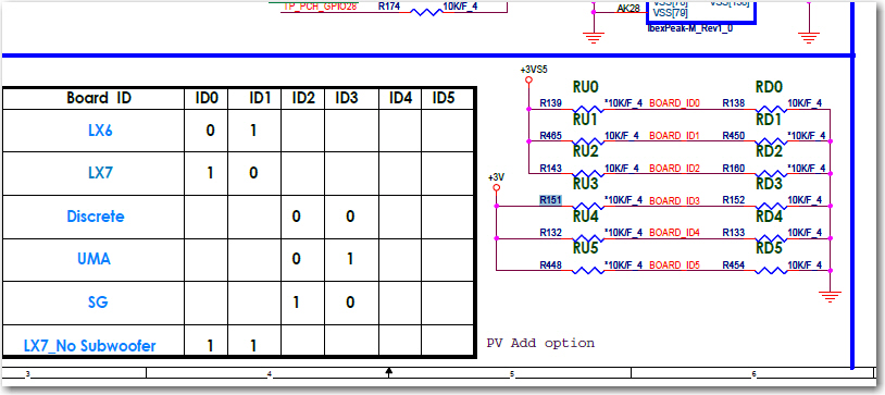

                                    Is it related with the picture attached, I convert it to UMA and I don't have to change the VGA chip ? thanks
                                    • bianchi77
                                      • Jun 2016
                                      • 1121
                                      Re: HP DV6 issue ?
                                      I tried to connect R151 to 3V but, the fan running very loud then off and my short tester (bulb) showing there is a short on power supply ?
                                      what's wrong with it, do you reckon ? thanks
                                      • jasko_jacker
                                        • Oct 2014
                                        • 1137
                                        • italy
                                        Re: HP DV6 issue ?
                                        there are many changes to make before the ones you say, did you do them?
                                        for example:
                                        pg 3 -> remove Rb remove Rc Add Ra
                                        pg 5 -> Add Rd Add Re Add Rc
                                        pg 6 -> Add R77
                                        and so on
                                        Open schematic and search for UMA, then make a comparison between discrete and uma, make the changes you see
