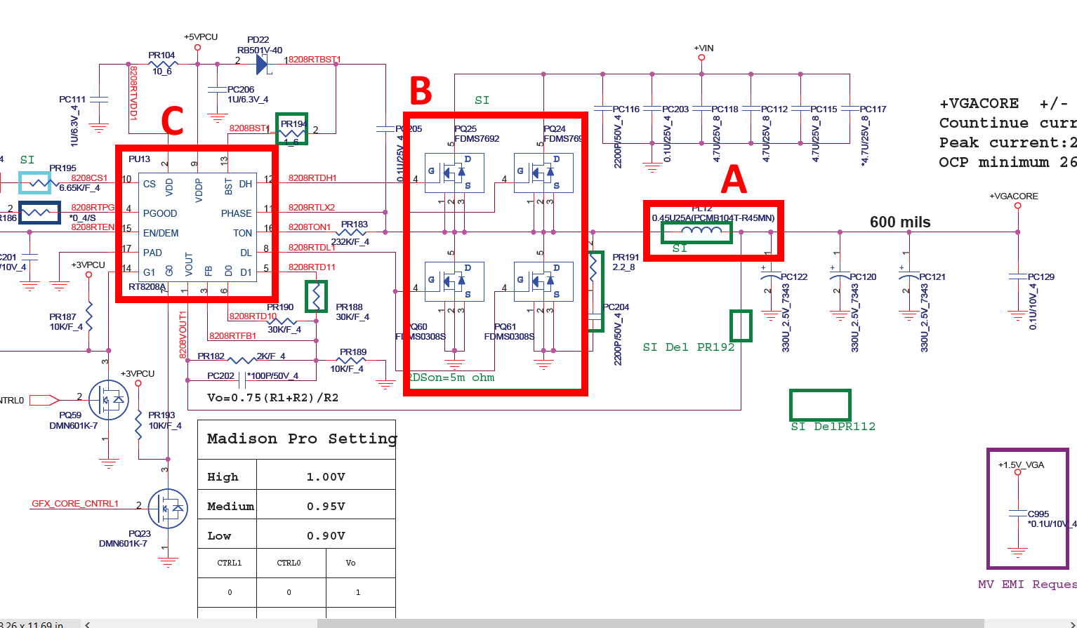

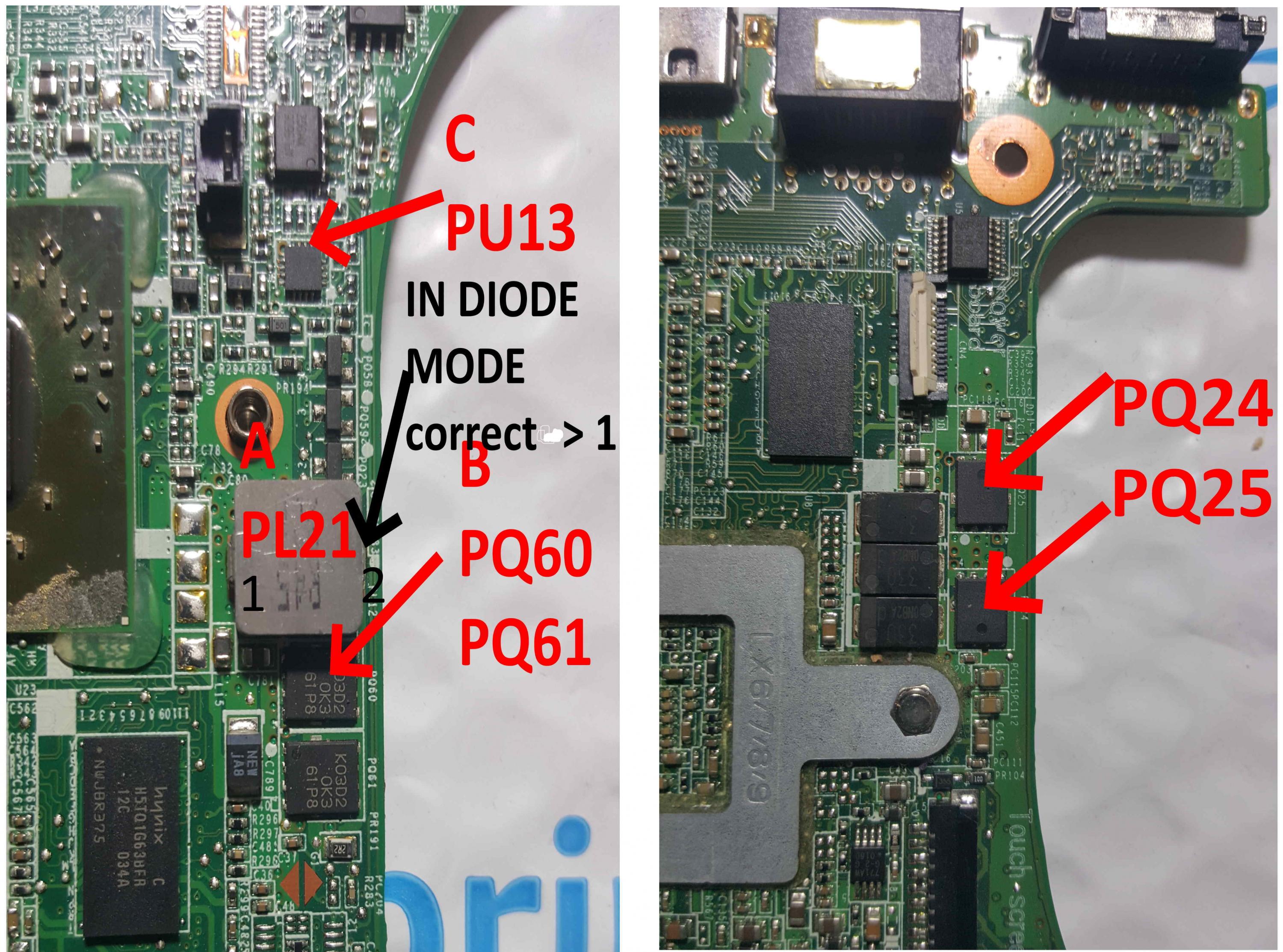

    In my motherboard, that have a bad GPU chip, I read in diode mode: 0.99 - 1 on pad 1 (see image) and 0.001 on pad 2. since after you have removed PL12 , the short remain, probably one of these mosfet (pq25-24-60-61) are in short or PU13 is damaged. To investigate, remove one by one these mosfets.
    Start from PQ25 and repeat the reading in diode mode where you have reading 0.006 V (pad 1 on the pictures) post result. If the short remain remove PQ24 if the short remain remove PQ60 if the short remain remove PQ61 At this point the short should be disappears and we can consider to replace mosfet or remove all circuit related VGA power.

      PC122 PC120 PC121 is short, 10.8 Ohm

        I removed PQ25
        PL12 value, red probe to the ground diode mode:
        PL12 1 = 0.004V
        PL12 2 = 0.112V

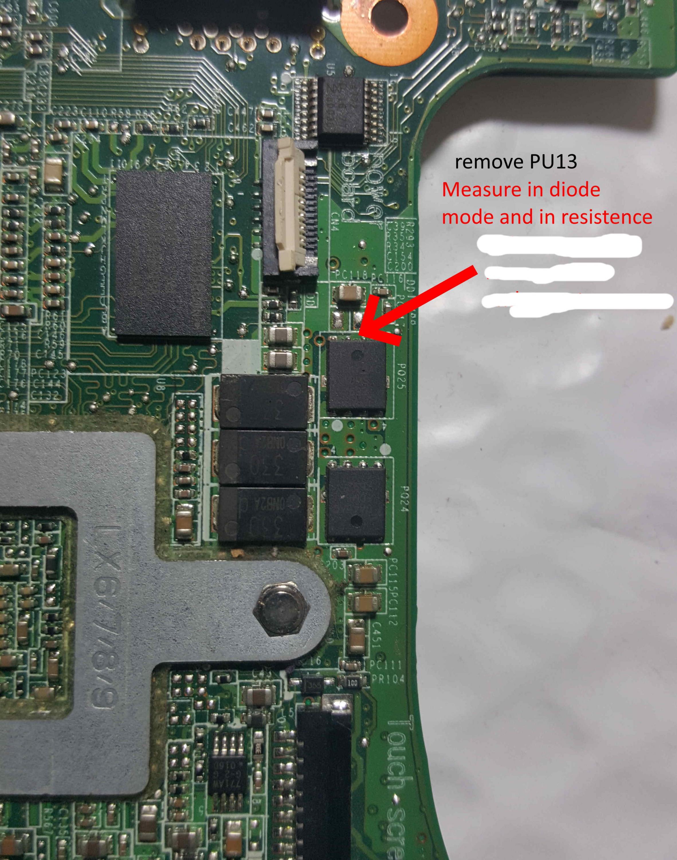

            As described in the figure, remove PU13 and measure on PQ25, measure again (but at this point it does not matter) on PL12.
            Report measure in both mode, diode and resistence.

                  Pu13 removed
                  Pq25-26-60-61 removed
                  Short on vin (measure on pq25) ?
                  If on pq25 there isn't a short it should be remain on

                      PL12 is isolated and without pu13 and without pu13 it is normal that there is no short ,
                      we must see if the VIN line is in order, take a reading on pq25 as I indicated in the pic at post #45 (at the point indicated by the arrow)
                      This type of motherboard (regardless of the conversion to uma) should power on also without GPU (VGA) . if not there is another problem.

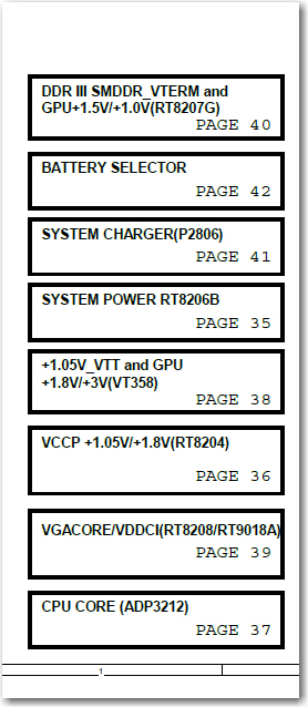

                                    Ok Please let me know, and which page is it on the schematic ?
                                    thanks
                                      #58
                                      Re: HP DV6 issue ?
                                      Any clues ? thanks
                                      Which one is always on and must be available before I push the turn on button ?

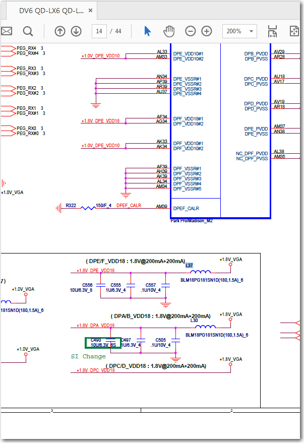

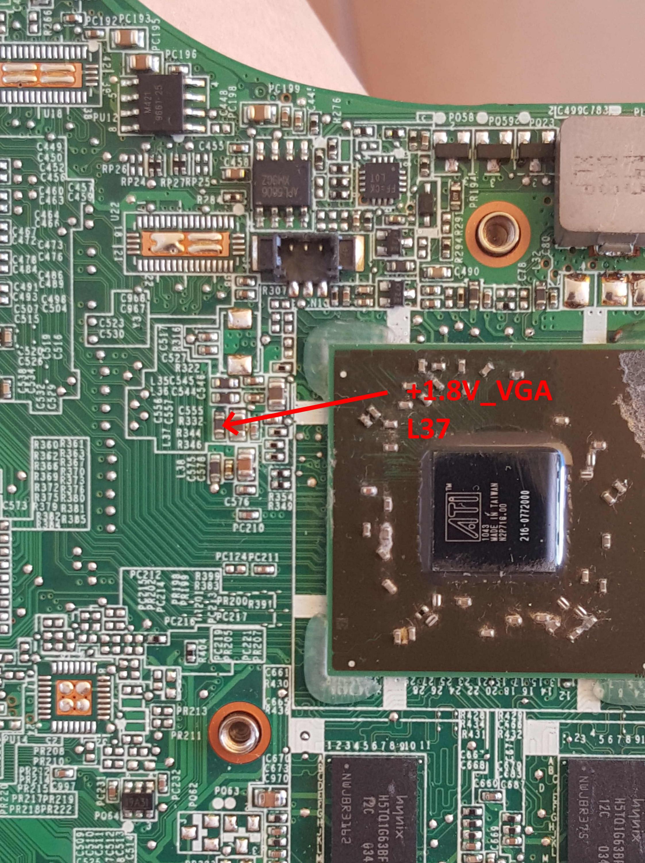

                                        I think the problem is after the power button is pushed, before the
                                        other voltages we still control the voltages referred to the video chip, check PL37 1.8V_VGA as always in diode and resistance mode.

                                          ok, it's L37 isn't it,
