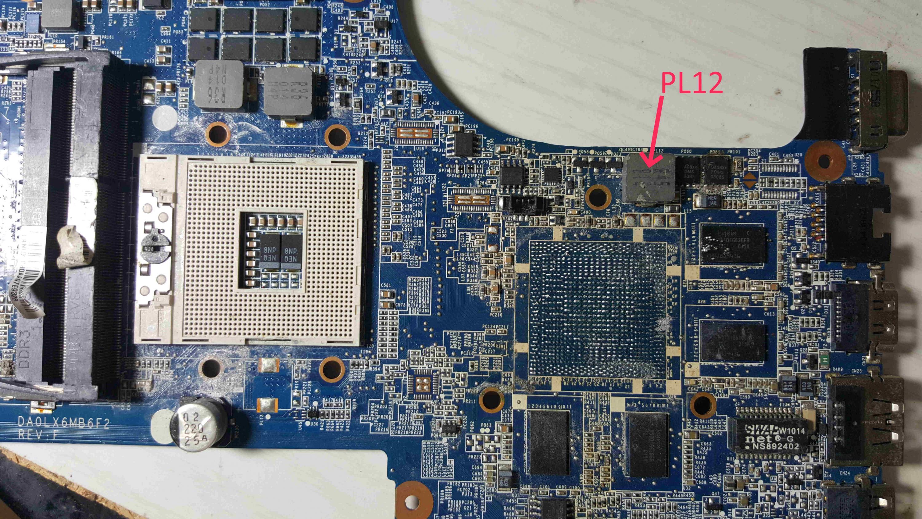

    If the platform is LX6-just removing the graphics coil will make it uma.
    I've not done it. Just read it in some russian forum.

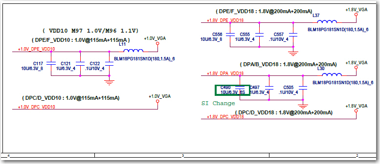

      Originally posted by jasko_jacker
      there are many changes to make before the ones you say, did you do them?
      for example:
      pg 3 -> remove Rb remove Rc Add Ra
      pg 5 -> Add Rd Add Re Add Rc
      pg 6 -> Add R77
      and so on
      Open schematic and search for UMA, then make a comparison between discrete and uma, make the changes you see
      What else I should change?

        board code : DA0LX6MB6F2
        REV F
        Is it LX6?

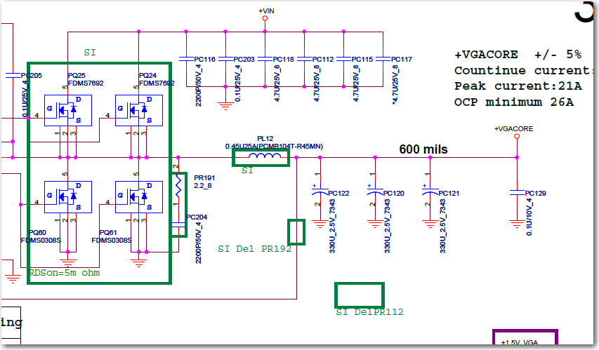

          What's the foot print code for graphics coil ? on which page on the schematic ?thanks

            Re: HP DV6 issue ?
            are those coils ?

              Re: HP DV6 issue ?
              Pag 39 PL2,
              however it is an attempt, if you want to change the card exactly as in the diagram there are many other changes.
              These changes consist in putting or removing resistances, etc.

                Re: HP DV6 issue ?
                Do you mean PL12 ?
                • mcplslg123
                  • Jun 2015
                  • 7262
                  • india
                  Re: HP DV6 issue ?
                  obviously , he means PL12. He has already attached a pic with coil number.

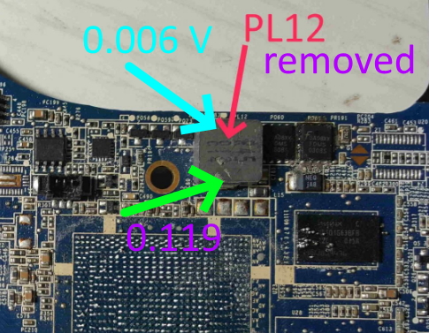

                    #29
                    Re: HP DV6 issue ?
                    Pag 39 PL2,
                    I removed PL12 and it's running, but when I connected CN2 (LCD), it behaved like before again, does it mean that I need to change all the Resistors setting after removing PL12 ? thanks
                    • bianchi77
                      • Jun 2016
                      • 1121
                      #30
                      Re: HP DV6 issue ?
                      for example:
                      pg 6 -> Add R77
                      and so on
                      Where is R101 = Rd and R345 = Ra ??
                      • bianchi77
                        • Jun 2016
                        • 1121
                        #31
                        Re: HP DV6 issue ?
                        Page 11 , where is Rb = R212 and Rd = R226 ?

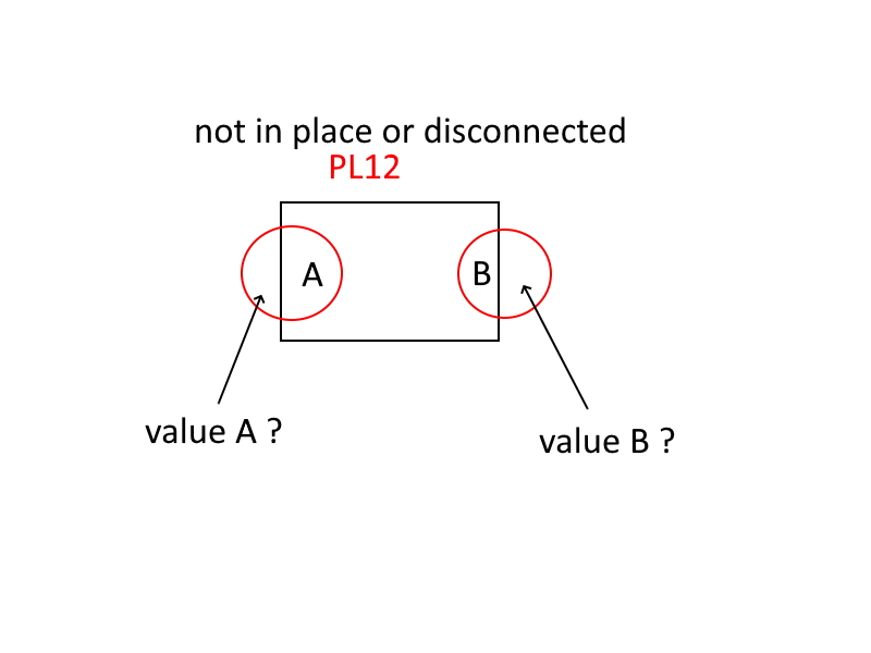

                          #32
                          Re: HP DV6 issue ?
                          At this point I suspect that there is a short in another power line, report with multimeter the value of both sides of pl12 in diode mode (without the coil or with a disconnected coil)
                          • bianchi77
                            • Jun 2016
                            • 1121
                            #33
                            Re: HP DV6 issue ?
                            The value is 0.121V

                              • jasko_jacker
                                • Oct 2014
                                • 1140
                                • italy
                                #35
                                Re: HP DV6 issue ?
                                do the reading on both sides
                                • bianchi77
                                  • Jun 2016
                                  • 1121
                                  #36
                                  Re: HP DV6 issue ?
                                  A to GND and B to GND ?
                                  • jasko_jacker
                                    • Oct 2014
                                    • 1140
                                    • italy
                                    #37
                                    Re: HP DV6 issue ?
                                    yes

                                      #38
                                      Re: HP DV6 issue ?
                                      yes
                                      negative wire of multimeter to the ground, diode mode,
                                      one pin of PL12 = Open Line and the other is 0.005V,
                                      positive wire of multimeter to the ground, diode mode,
                                      one pin of PL12 = 0.006V and the other is 0.119V
                                      what's wrong with it ? thanks
                                      • jasko_jacker
                                        • Oct 2014
                                        • 1140
                                        • italy
                                        #39
                                        Re: HP DV6 issue ?
                                        like the image or viceversa ?
                                        • bianchi77
                                          • Jun 2016
                                          • 1121
                                          #40
                                          Re: HP DV6 issue ?
                                          yes like the image, without PL12, I have removed it
