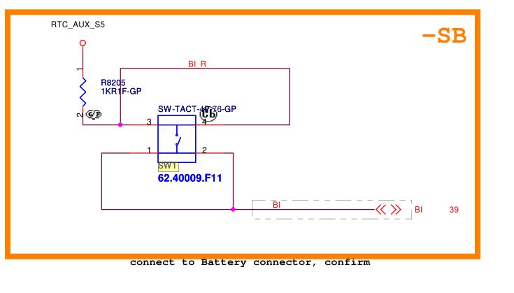

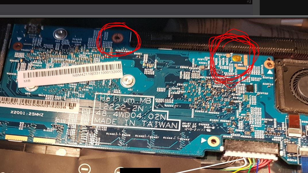

                Re: Acer not working off battery
                On some acers there`s a small micro switch that presses in when you fasten down the cpu/mem cover. With cover off the switch is up,the battery doesn`t charge.
                            Any idea what that switch looks like/where it is/what it's called on the schematic?

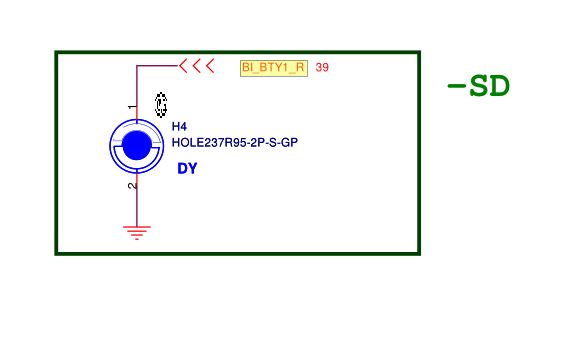

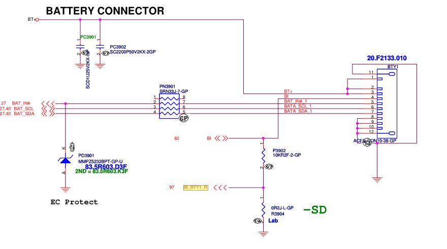

                                    • 21018
                                    Its SW1 ,page 82.Also look at page 39 ,BI_BTY1_R ,hole H4

                                        • 21018
                                        Bridge the 2 sides of the hole with tweezers or a jumper and press SW1 ,keep it held down. See if it starts to charge .
