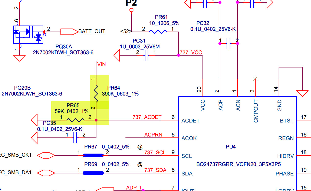

    Is the ACDET voltage correct? With the battery only, you see this value?

        Sorry for being vague - it is a bit of a loaded question.
        I believe that 2v6 is fine but questioning why there is 2v6 if you have only the battery connected.
        If you mate the external power adapter, then there is a VIN from the external adapter and a resistor voltage divider will scale this high voltage down to a safe value. The 2v6 sounds ok to me.
        See attached on a random schematic found using the same TI charger IC.
        When you remove the external DC adapter but using only the battery, I would not expect any voltage on ACDET pin.
        Can you confirm this ? Perhaps my misunderstanding of quick reading of this thread.

            I checked the voltages, on ACDET pin 6, 2.6V is present when DC adapter is attached but one I remove it from the DC-in jack, then NO VOLTAGE present on Pin 6, which is correct. & once I remove the Adapter pin, the Motherboard goes dead again & does not operate on battery at all, but battery shows clearly in Win 10 & shows charging icon too!! Now I think you will get an idea. & one more thing I noticed when I reset the battery from the on-board RESET button, on battery terminals the voltages raises to 16V & then slowly drop down.

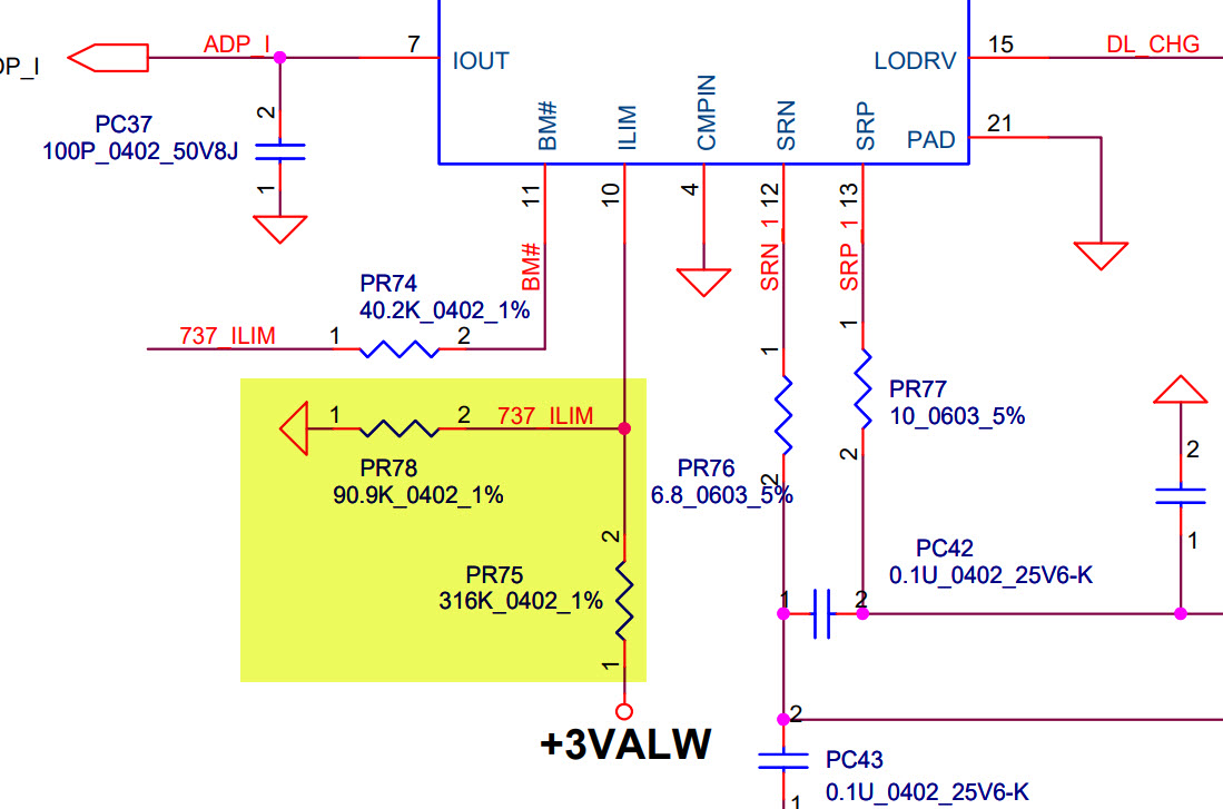

                  ILIM @ 3v2 sounds high - unless there is only a single resistor to the +3ALW rail.
                  See attached. Do you have a similar 2 resistor voltage divider on the ILIM pin?
                  Without power, measure their resistance.

                    Yes mon2 the voltage out here should be less than 1V., where as in my case its always shows 3.2V & this board has only ONE resistor 100K so it seems to be the right volt on ILIM. Before this resistor volts is 3.3 & after this resistor going to pin 10 is 3.2v. From where is this signal generated from???

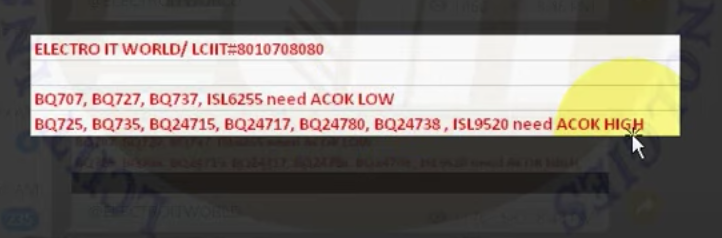

                            I was just checking a youtube video & according to this charging chip BQ24737 ACOK should be LOW. No doubt this is an OPEN DRAIN, it has NO pull-up resistor & Pin 5 of BQ24737 is directly going to pin 110 of the IO chip., but at pin 5 it has be LOW when AC power is connected. I even took a similar model ACER Spin motherboard & this PIN is low when AC power is connected (Different charging chip & reflects the BQ series IC on his chart). This guys made a chart for his students, check the screenshot, it a good reference for all the BQ series chips. Hope it helps & if some else can kindly put in their thoughts into this. Are we right???

                              In my case whether AC power is connected or not connected, PIN 5 is always High. Here is another reference according to the guys BQ series chart.

                                Thanks for the correction. So the 735 and 737 do differ, at least on the ACOK pin operation.
                                On the other Acer model, what is ACOK pin voltage when the adapter is not connected but using battery only?

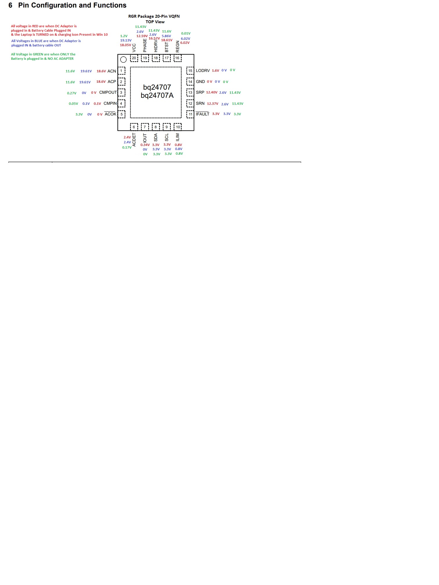

                                    When using the battery, see the photos of the charging chip BQ24707, you will notice in GREEN that there is 3.2V when ONLY on battery & when on AC power this pin 5 should turn to GND (0V) according to the Chip schematics/designing. Thanks for all the information.. Now I have to check whether I have this IO KB9028Q, program it & then see what's the result.

                                      Re: ACER Spin SP113-31-P6NZ not working on Battery
                                      Can you confirm the markings on the charger chip ?
                                      The first post notes BQ24737. The last post references BQ24707.
