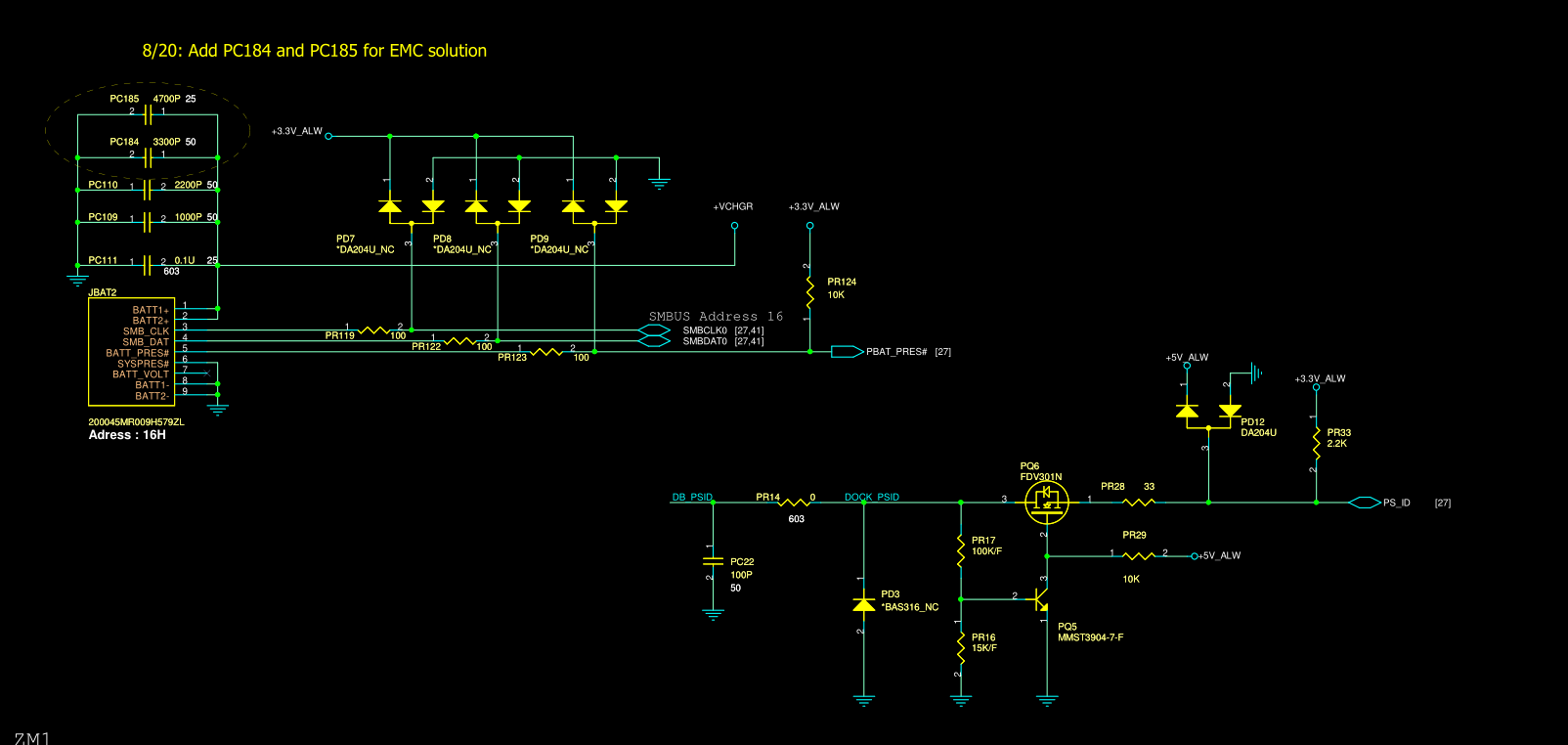

    Hey Guys,
    long time lurker and I have a problem which I have been working on and off with for a few months now and hit a dead end and it's driving me crazy haha. Any input is greatly appreciated and sorry for the long read, trying to squeeze most info here.
    Now I know this thing is old and is really not worth my time anymore, but it has been a great learning curve for me.
    This laptop was given to me for free and was not working at the time at all.
    Initially it was missing 3.3v_ALW which was caused by PQ31 shorting and also damaged PU4 - TPS51427A.
    I replaced both and had both rails.
    There was still no sign of life and after checking I found another short ( I don't remember where initially) which I traced back to the I/O controller - ITE8502E. Also under close inspection the I/O seemed to have a small burn mark on top.
    Replaced the I/O controller and the short was gone and laptop came to life.
    Current state is I have power. The laptop is working properly. It boots, I can load into windows, I have had prime95 run ect. All stable.
    What is still wrong is that I cannot get the battery to charge.
    The original battery it came with was under voltage. So I bought a replacement 3rd party battery.
    Both batteries upon plugging in with the charger make the onboard LED flash 4x orange 1 time white.
    During post I get the message that the battery cannot be identified and won't be charged.
    In windows the battery shows up as unknown with either 0% or 100% and not charging.
    If I remove the ACin the laptop stays on and uses the battery. I can cold boot from the battery too without AC charger.
    The original battery is faulty, so forget that...all tests are done with the 3rd party.
    BIOS shows power supply is correct so center pin is fine there too.
    I have tried to trace so many lines and am trying to understand the problem...the only thing I can find which does not add up is that:
    Pullup resistor RP8 on the SMBclk0 line is only 1.9k ohm not 2.2k
    Resistor PR124 on the PBAT_PRES# line is 2k ohm and not 10k
    Now, removing either of these makes the other the correct value (?!) why? They are not related apart from the 3.3v rail. When de-soldered their values are correct and make the other in line the correct value, it's really strange. I have swapped them too from a donor board, same result.
    I have bought another faulty motherboard (has a hole in it) as a donor board and both resistors in line are the correct values 2.2k and 10k on the donor board.
    smbdat0 line is 3.3v with and without battery
    smbclk0 line is 3.3v without battery but only 0.5v with battery.
    I do not have an oscilloscope to check if there is talk on the line.
    I have again changed the i/o controller from the donor board to this one, same result.
    I have changed the charging chip twice PU8 - MAX8731A (1 new, 1 from donor) with same results.
    I really don't know what else I can check. My understanding so far is that there is potentially no smbclk talk on the line which in turn is making the charger chip not turn on.
    It would make sense also why the error message comes up as it cannot read the battery % or know anything about it. Same in windows, no idea about state. I tried a battery info program in windows and results come back unknown.
    Now SMBclk0 and SMBdat0 lines go Battery - MAX8731A - I/O.
    Charging chip and I/O I have replaced each twice already, new and from donor...so it really makes me wonder if it is the replacement battery...but then the 2 resistors are still not quite right either so i'm unsure.
    Any feedback is most welcome.

            • MJ-meo-dmt
              • May 2016
              • 186
              • South Africa
              Re: DELL 1564 UM3B - Battery not charging
              Hi
              I like your style of posting (looking at the First post)
              Attached is schematic snip...
              Did you check the PSID line in. I have found so many issues with the components on that circuit, visually they look okay as soon as you light reflow they start to show. In most cases I had ones with broken/burned legs, as said visually they looked fine, trying to take them off showed the problem as you pick it up via tweezers one leg stays behind :P So maybe just inspect them physically...
              Anyways I see you did get voltage response on the CS pins but just make sure they are all still Okay as well.
              CSSP, CSSN, CSIP, CSIN
              However this maybe more towards what you have atm... Unless something else is interfering...
              And then in the same image attached check the resistors and diodes on the battery terminal side regards to the SMB_xx issues you have. Both SMB_clk/data should stay at 3.3V
              Components in question: PD7/9, PR119/123

                • Canis
                  • Nov 2018
                  • 9
                  Many thanks! I try to get as much info in as I can but things get quite long then and puts people off reading
                  Checked PSID line...all seems fine there. PSID is also adapter sense yes? Bios does show 65w adapter present and 90w adapter when I change it to my spare so I assume all is good there.
                  Double checked the CSSP, CSSN, CSIP, CSIN pins, all seems correct. Values identical.
                  PD7/8/9 are NC. Not connected and not present.
                  PR119 / 122 / 123 are correct value at 100ohm
                  The only 2 things I can find is
                  Resistor PR124 on the PBAT_PRES# line is 2.2k ohm and not 10k
                  If I remove either of them the other has correct value. They are not faulty as they have been changed and also have correct value out of circuit.
                  Still 3.3v on smbdat but 0.5v on smbclk. Managed to get donor board working that it is charging and on there both smbclk and smbdat are 3.3v.
                  I don't see a short or anything though as without battery I also get 3.3v on both lines.
